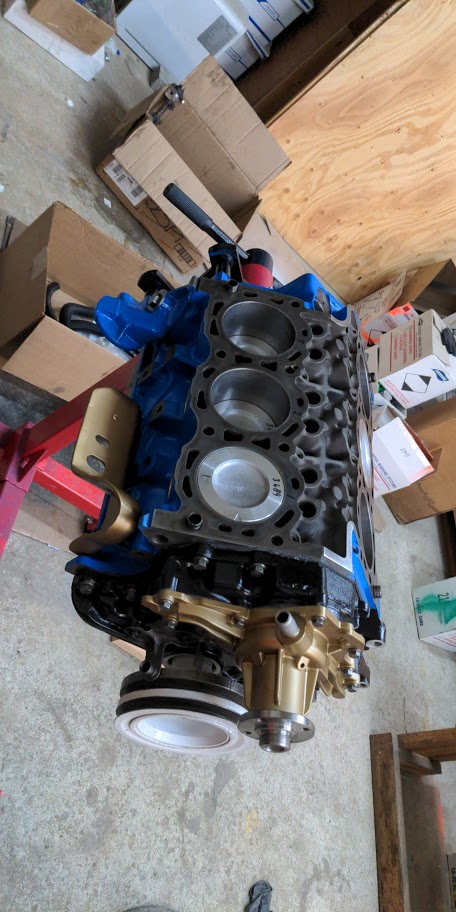

when building this I took the block, crank and new pistons to a machine shop for inspection and boring. the crank was undersized on journals & rods. new bearings are within spec. The block was bored and checked for flatness as well as hot tanked. the heads were replaced with new/remanufactured heads. valves lapped, lifters replaced. camshaft fine so it is stock. new pump.

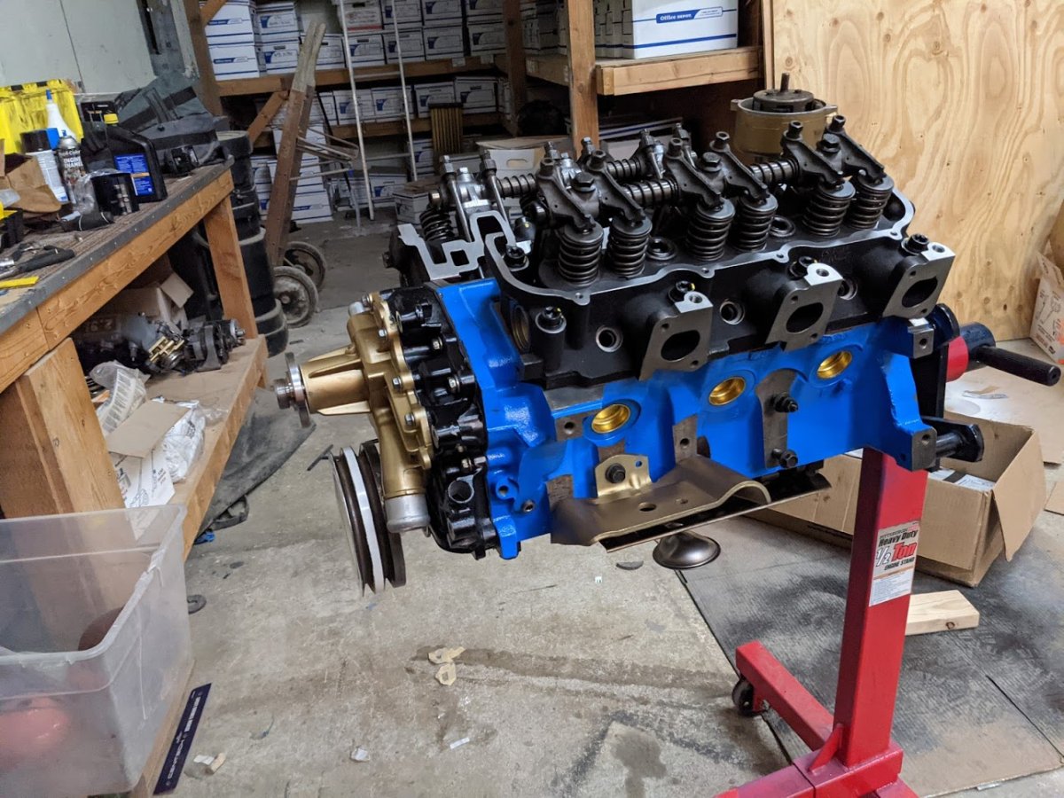

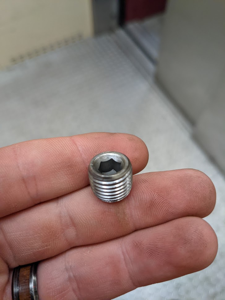

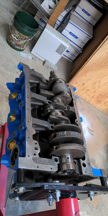

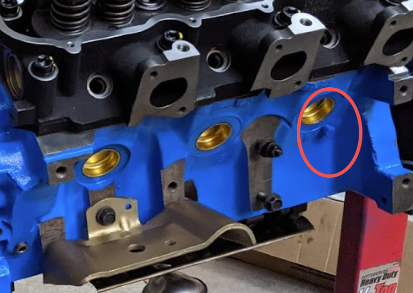

they pulled all the plugs out for me before the hot tank and I think I might of not put one of the threaded plugs back. I've put a picture in the post with a red circle on it. this shows the coolant plugs I did put in on both sides of the block, but i was unable to find the location of the 3rd plugs home after looking over everything. the picture below is a threaded plug i got back from the shop but did not reinstall due to not finding a home for it (the plug fit well in the oil pressure sensor location).
56416
56415

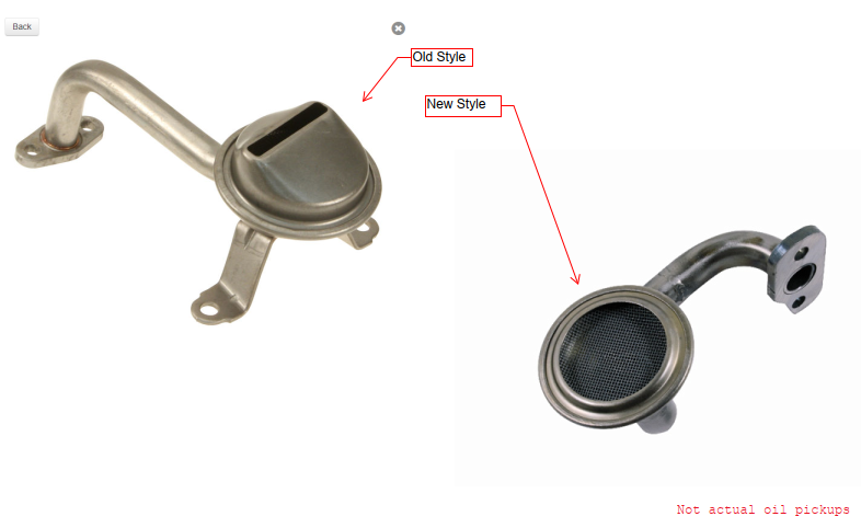

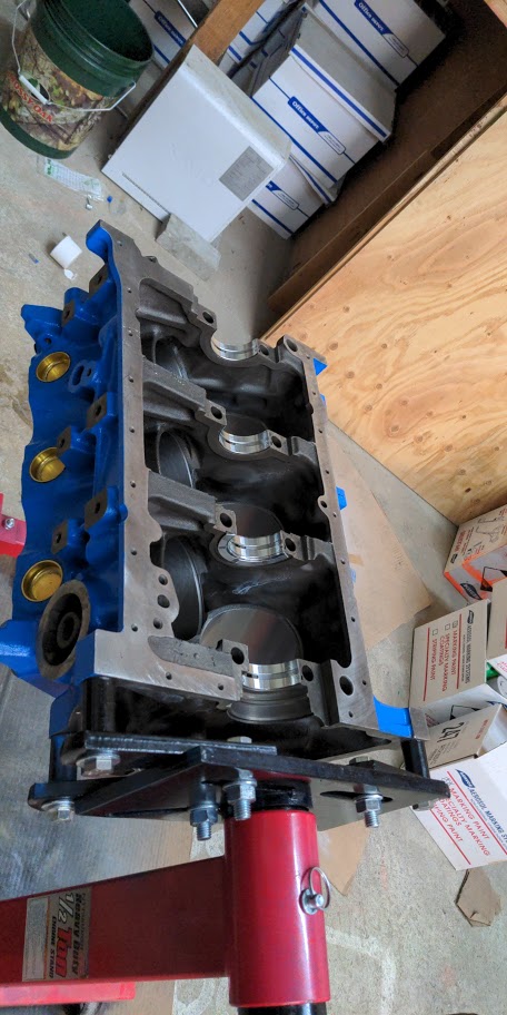

I also replaced styles of oil sump pickups, could this effect the oil pressure when warm? picture below.
56417

What is the pressure on a cold start and where does it end up at a warm idle.
I would think if one of the oil galley plugs were left out... it wouldn't make much pressure cold or hot.
Oil pressure is right in the middle, than drops to nothing as soon as it warms up. I'm thinking you are correct, any way you can elaborate?

Not exactly sure what you want me to elaborate... but I'm thinking you should hold judgement on this until you screw a mechanical gauge in the engine and look at some real numbers.
Oil pressure is developed by the pump delivering a volume of oil to the oil galleys. Pressure isn't developed until that flow of oil meets a restriction... (bearing/component clearances). If one of the galley plugs were not in place... it would offer no restriction... therefore no pressure.
I rebuilt a 302 years ago. The machine shop removed all the oil galley plugs for cleaning and installed new plugs before delivery back to me. I built it and installed it. I started it up and oil pressure was right at the pressure relief valve value (60 psi). I ran the engine to break in the cam.... lowered the RPM's... engine was warm... pressure was just north of 20 psi. I'm thinking perfect. I blipped the throttle a couple times to hear the roar and the oil pressure dropped to near 0. I shut it down. I let it cool and restarted it... and the engine still had near 0 oil pressure. Upon examination... one of the oil galley plugs for the lifter bores had popped out. I tapped the galley port and installed a pipe plug in it... oil pressure problem solved.
You also need to remember the oil pumps are positive displacement. Meaning the faster they turn... the more volume they deliver. So at start up... your pressure should be on or near the oil pressure relief value (most likely 55 to 65psi). Once the engine warms the pressure will fall and probably be around 20psi +/- a few. This will be dependent on how tight or loose the engine was built... the looser the lower the pressure will be. The thing to remember is that as soon as you increase engine RPM the pressure should climb.
