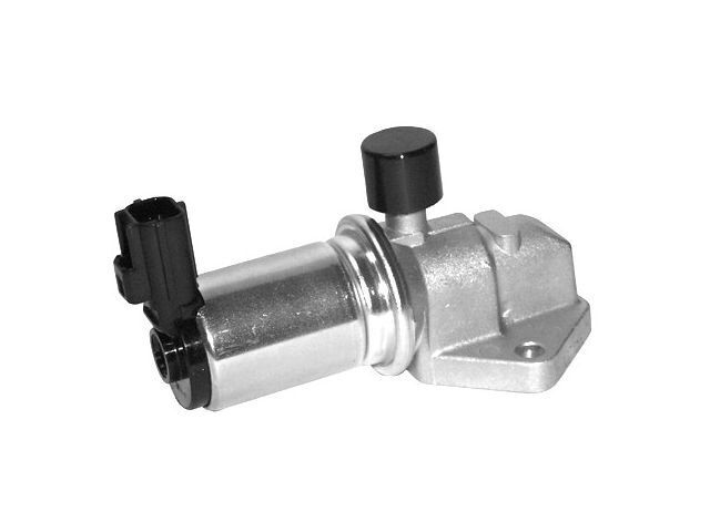

Currently doing a custom ECU and wiring harness on my 1997 Ford Ranger 4.0L OHV engine. For wiring purposes I need to know if the idle air control valve is pulse width modulated (PWM) or simply a solenoid that's on or off as needed. I haven't really found much information online after searching for a few hours. If you could shed some light on this I would be so thankful!
  • Is the IAC valve pulse width modulated (PWM) or simply on and off? 1997 Ford Ranger 4.0L OHV
They are pwm to get the amount of opening needed.

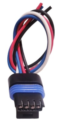

this style tends to work better with aftermarket controllers.
I am using a MS3X which is decidedly overkill for my project but it does support Ford PWM 2 wire IAC valves. If I do have trouble getting this to work I will definitely give this a shot next. Thanks for the input!
