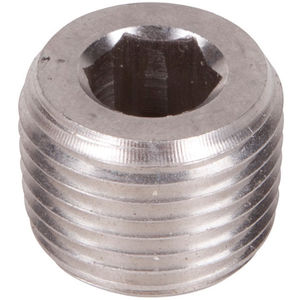

I tried welding a bung on the diff cover when I had mine out to change the oil, I got it all back together and there is not enough clearance to get the bolt out. I hate how tight it is. Putting a hole in the bottom of the housing, with a npt plug would probably work better anyway.
It’s not that hard to pull the front diff, I’ve never rebuilt one though. Shouldn’t be any worse then most others though.
I was afraid of that but I'm not much of a fan of putting a drain plug on the bottom of the diff where it can hit something. I'll just have to make sure I get one that is a recessed square or torx drive so there is less stuff poking out to hit something.
I was thinking something like this.

I may take mine out again to change the fluid and check how the Torsen has worn. Regarding the drain plug, I may actually do the same thing to the front axle on mine. I have always been a bit leery of compromising the housing by drilling it, but I think if the plug is small enough, it should be ok. It will make fluid changes a lot easier.
