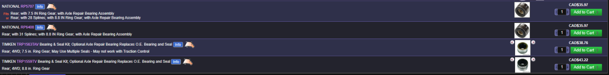

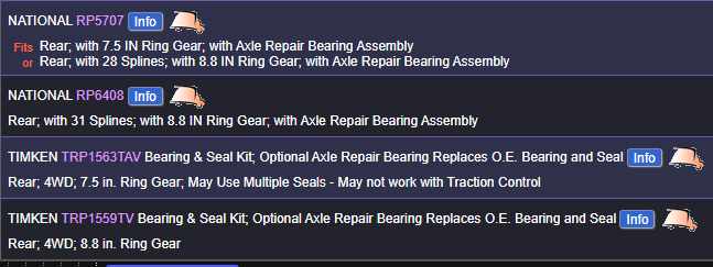

Thanks all. Do you folks recommend using the "repair" seal/bearing assembly? I am a bit confused on which part number is correct. I have 4.10 gear ratio and the tag on my diff says 8.8.
The National assembly says one fits both 7.5 and 8.8. And the other says only 8.8 (depending on splines). The Timken has no mention of splines and has different parts for 8.8 vs 7.5 :icon_confused:

The one that "fits both 7.5 and 8.8" is the one you want for your 28-spline axle (the other one would be for Explorers/F-150s which have larger bearing journals and 31 spline axles).
