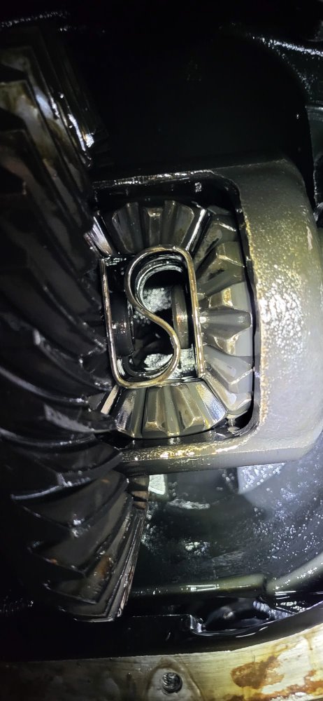

I am having a hard time getting the c-clip back on. Can I take one of these S shaped things off? It would give me some more room.

The S spring is one piece and there is no way to get it out without getting the C clips out and the axle shafts out of the way
With both axle shafts pulled out so the C-clips are tight against the side gears, I have with vice grips and pry bars and a whole lot of cussing, managed to get that S-spring out and back in. I didn’t think I’d be able to do the C-clips otherwise. I might try getting the C-clips without removing the spring next time though.
So I think I know the issuse I have. The "repair" bearing assembly sticks out of the axle about 1/8" to 1/4" inch. So now when I push the axle in it goes less deep into the differential. I think it impossible to get the clip on without removing the S-Spring. I am really not that happy with how the repair assembly sits and the seal in it. I think I will go and by the bearings and seal separately.
