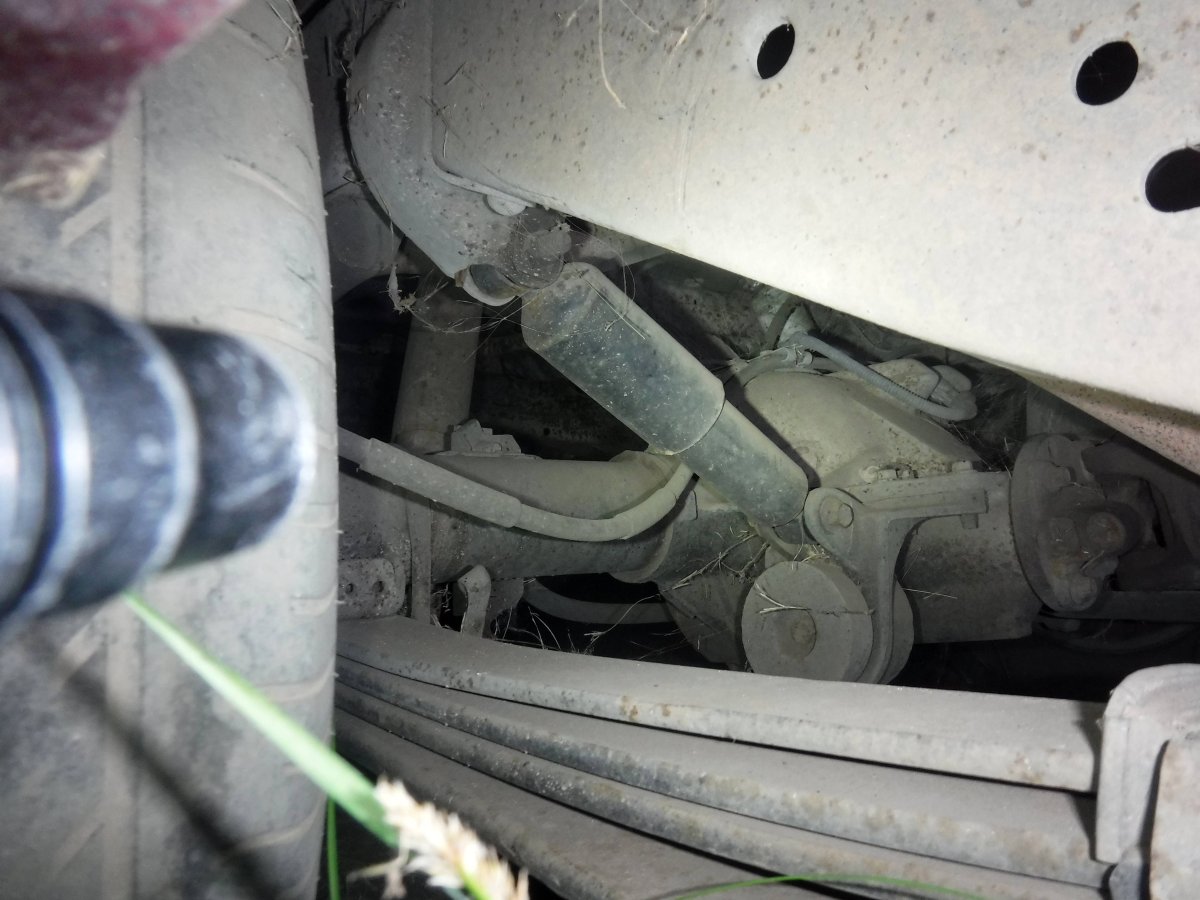

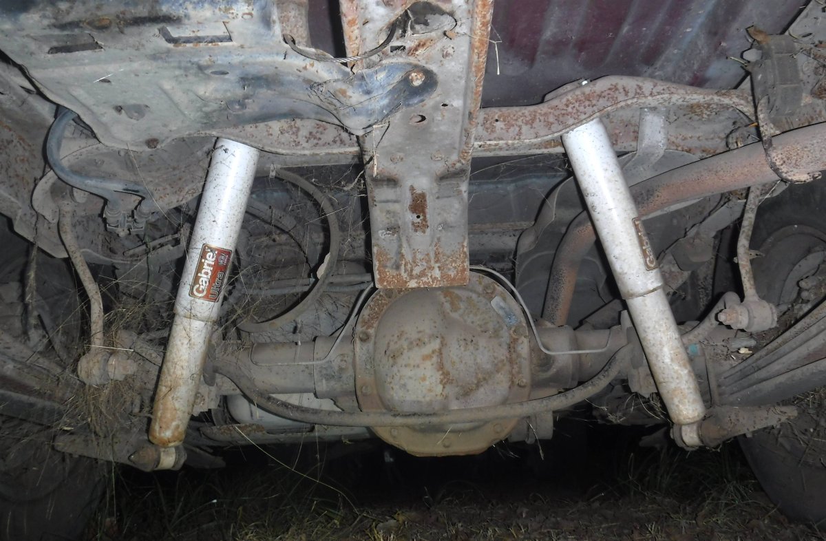

Well, the rear axle, at least in the V-8 Explorers is set up entirely different from a Ranger. Rangers were all spring over axle, and the 4x4s got a factory lift block between the axle and spring. Explorers were spring under axle. Because of the difference in leverage with each of those three options, spring under reduces axle wrap the most. Axle wrap is the rotational force on the axle and it tries to bend the leaf springs to an S shape. The leaf spring clamps and traction bars help fight that too. Both of those the Explorer used and the Ranger didn’t. The Explorer had both rear shocks mounted behind the axle instead of the one back, one forward in the Ranger. Because of all the anti-axle wrap stuff, it makes sense they did that. Throw in a sway bar and then the dampener shock goes from the front of the differential (if you look at yours, on the passenger side there’s a flat spot with three holes up by the pinion yoke, that’s where the bracket attaches), then the shock runs at an angle up to the inside of the passenger frame rail.

Have you got a photo?
The one on right is from just front of the Right Rear tire, that's my little flashlight in front of it
