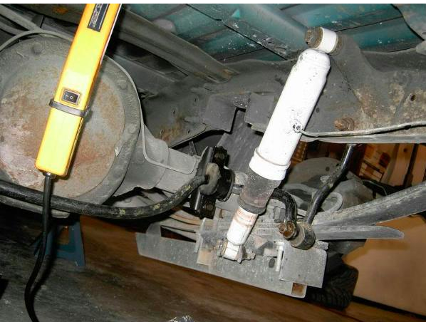

The Explorer sway bar will probably be the more likely donor even if more fuss. I have not been out to the junkyard yet but there is a photo in the tech section. The bar seems to be clamped onto the axle on either side of the differential. Am I correct, or will this be welded to the axle?
Yes, the bracket is welded to the axle, and the sway bar is clamped to the bracket.
I thought I saw someone post that early Explorers had the clamp on sway bar. It could be either a misunderstanding on my part or that poster’s part.
