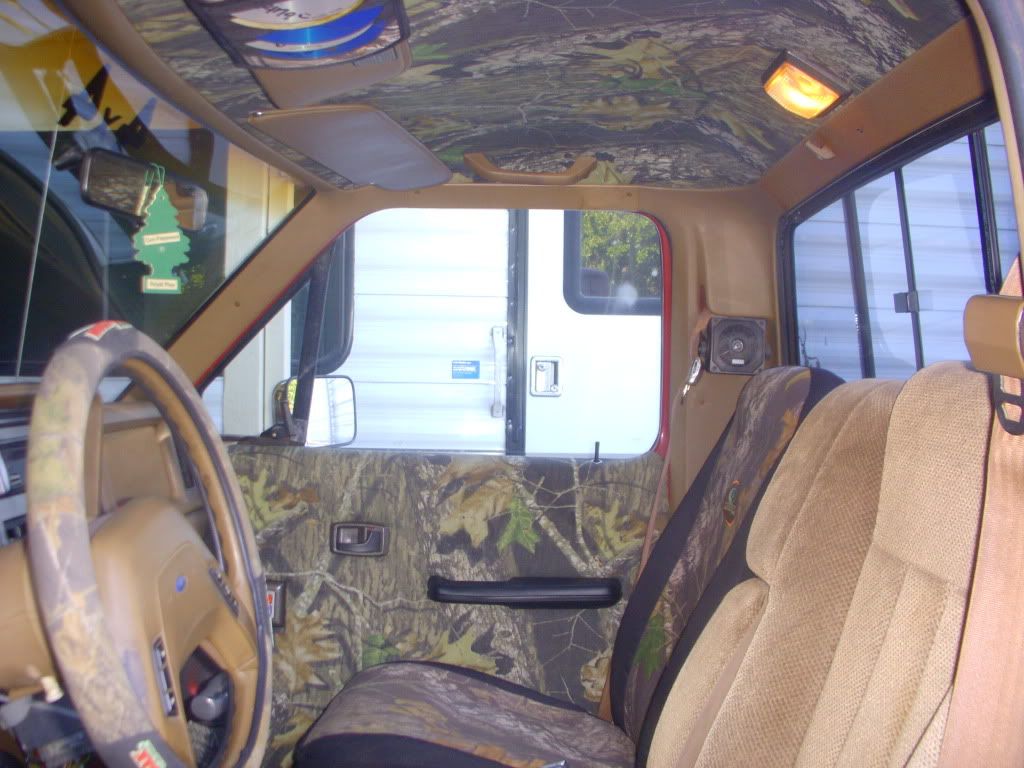

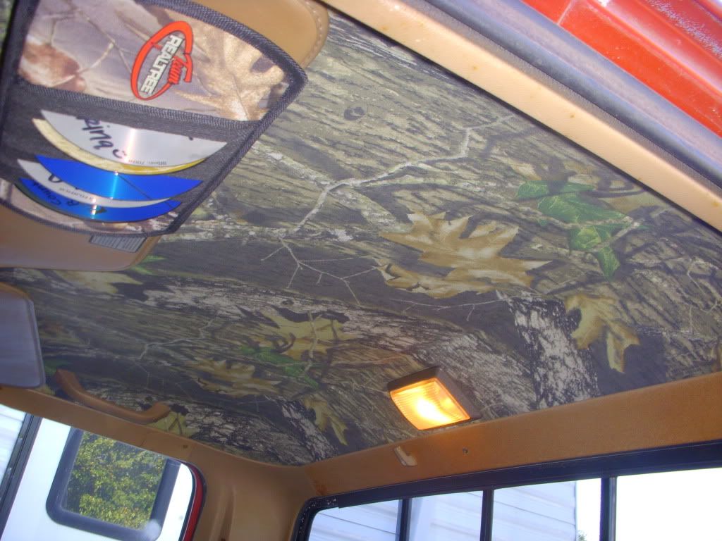

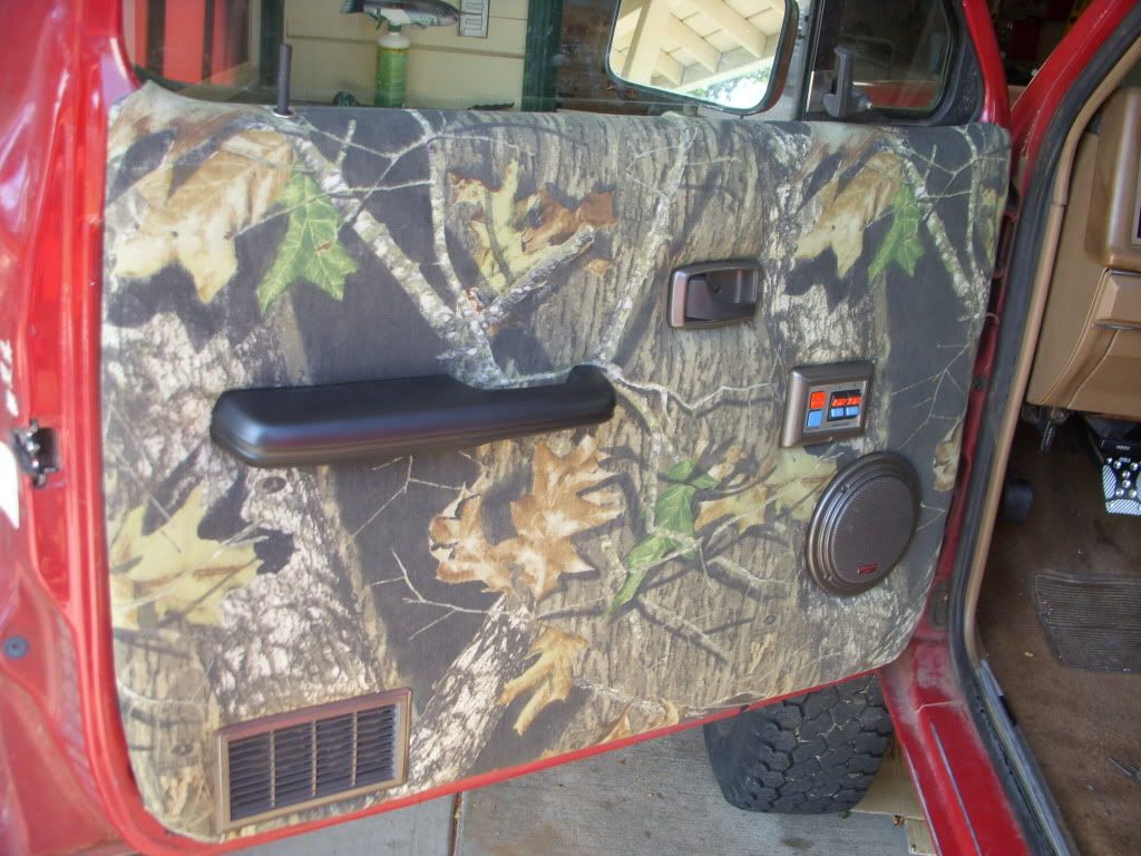

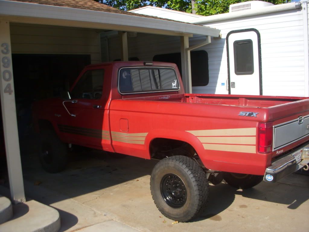

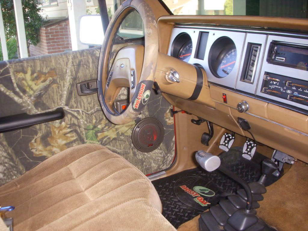

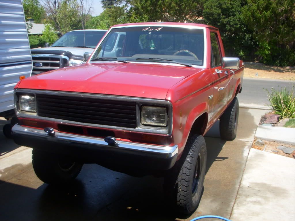

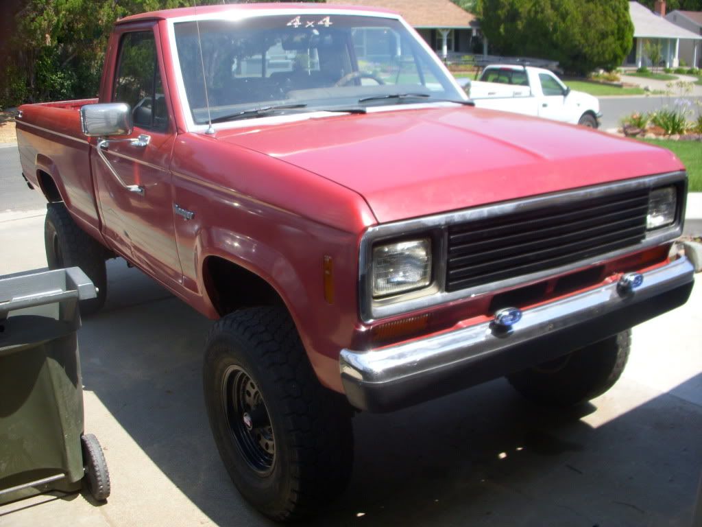

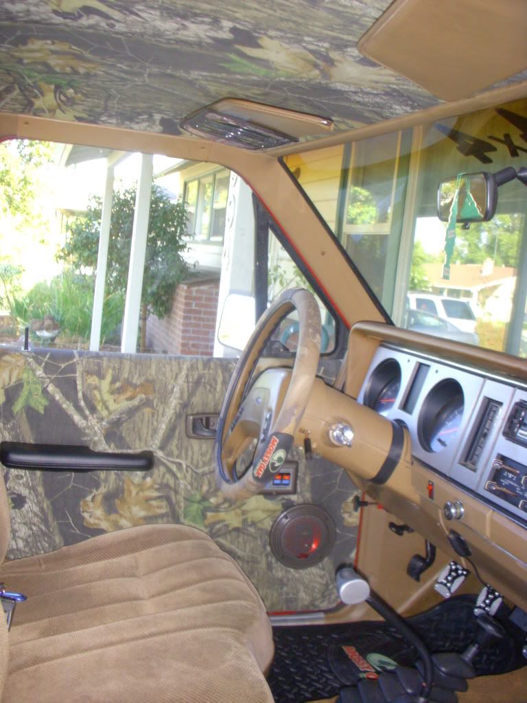

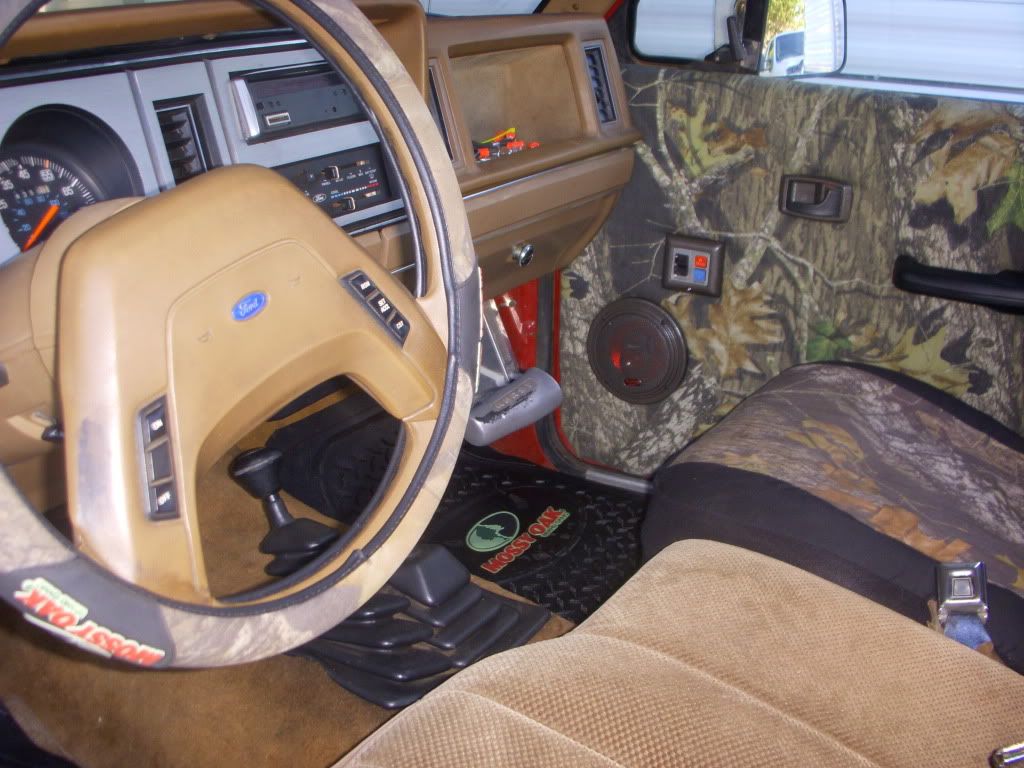

Well I'm finaly getting something done on this truck. It's running like a champ and just in time cuz I'll be driving in less than a week. Yahoo! lol. Anywhoo my dad and I stripped off the old door panels and visited the craft store. We used the cardboard from the old panels as a template for the new masonite ones. Add a layer of foam and mossy oak breakup material,hold it all together with some spray glue and presto...ranger-el-primos. You'll also notice the new pedals and floor mats and we camo'd the headliner too. As far as the exterior goes...I've got all new Rancho 5000s underneath and painted most of the visible stuff underneath. Painted the fenderwells and repainted all four wheels.
Well there it is soo far. I have GOT to get some tires,and some new paint.

thats hot. im about to do my headliner when i get the time. how did you do it? just get the material and spray it with adhesive or did you ripe the old stuff off?
Yeah I peeled of the old saggy material,but left the thin layer of foam that was on there. That's all it is...cardboard with foam glued to it. Then we went to Joann's and got the material and just spray glued it on there. really easy
