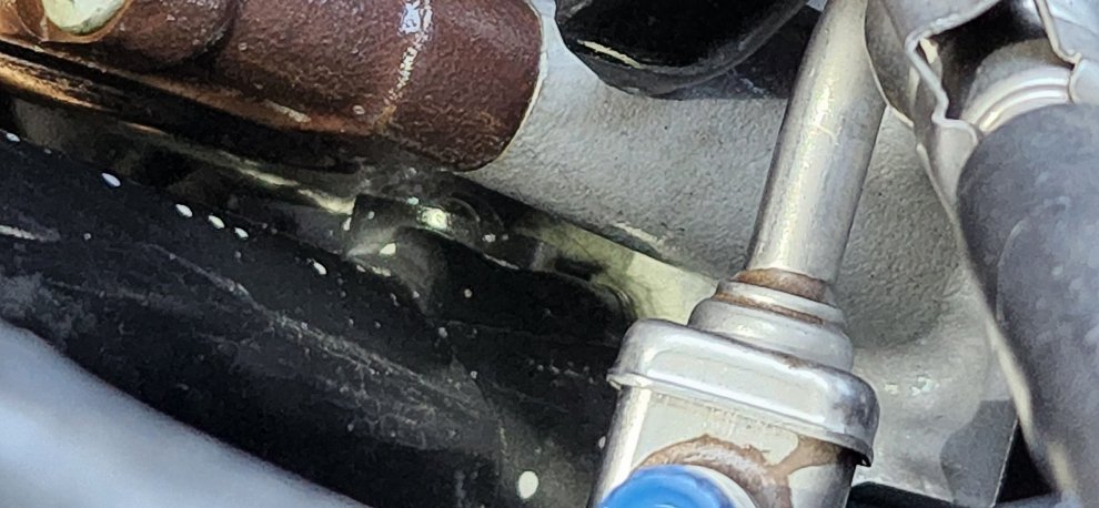

After months of dealing with vacuum leak symptoms I finally found a vacuum leak on the intake manifold. The leak is located on toward the front of intake runner #1.
A description of the symptoms for anyone who finds this through a search: High idle between shifts. The idle returns to baseline (800 rpm) at a full stop. The symptoms are more severe with the air conditioner on. Idle is higher between shifts and remains high for a longer period of time, but eventually goes down rapidly to about 500 rpm, then recovers to 800 rpm. Sometimes the idle will wander between 1500 rpm and fall to 500 rpm before settling down. Drivability when I'm not in stop and go traffic is fine, but I noticed lack of power going up hills. No codes. All the sensors indicated variables within normal range. However, long term fuel trim was slightly high at 11% most of the time, sometimes going as high as 15%.
The first picture is a view of the are where the vacuum leak is occurring. I sparyed soapy water on it and put a few pounds of pressure in the intake to locate the leak. You can see a bubble behind the shiny area on the manifold. Since I can't see or access this leak without removing the intake I went searching for a picture of it and that the second image is. It appears there is a plug to cover a hole for injection molding (or something else) and it is leaking. Has anyone come across this and knows of a repair that doesn't require a new intake? I'm thinking about trying to pop the plug out and sealing it with a hard gasket sealant and maybe coating the top of the whole area with epoxy after the gasket sealant sets. I'm kind of concerned about the ability of epoxy to adhere to whatever plastic composite the manifold is made of.

that hole is where the pivot shaft is for the early design intake runner flappers, 2001/2002 ( 3 ? )
if it's leaking I would try course sanding and JB weld YMMV

I came across a few videos about this after I posted. I still have the plug in there so I'm thinking about popping it out from the inside and sealing it with Form-a-Gasket #1 and figuring out someway to permanently secure the plug through some other method.

The round plug on the intake manifold where the leak appeared to be coming from didn't go all the way through the intake runner. The inside of the runner is cast/molded as if there is a plug on the other side. I sure looked as if the bubbles were coming out of the soapy water from it though. It was very likely that it was the intake gasket that was leaking. When I inspected the gaskets it appears (but it's really hard to tell) that there was a bit of dust on the portion of the gasket that should form a seal against the intake ports on the cylinder head in the same area where I saw the bubbles when attempting to locate the vacuum leak. I also noticed this on the gasket for Cyl 3. The gaskets for the other two cylinders were flat and clean where they contacted the cylinder ports. The spark plug for cyl 4 was white from running a bit lean. I replaced the spark plugs because even though Autolite claims the XP series spark plugs are "lifetime," they aren't. They had 70,000 miles on them, so I just replaced them as part of general maintenance. Before doing all this I had several issues. One was the engine felt like one cylinder was bouncing that was worse when the A/C was on. Now the engine runs smooth when the A/C is off and there is a slight vibration with it on, which is likely normal.
