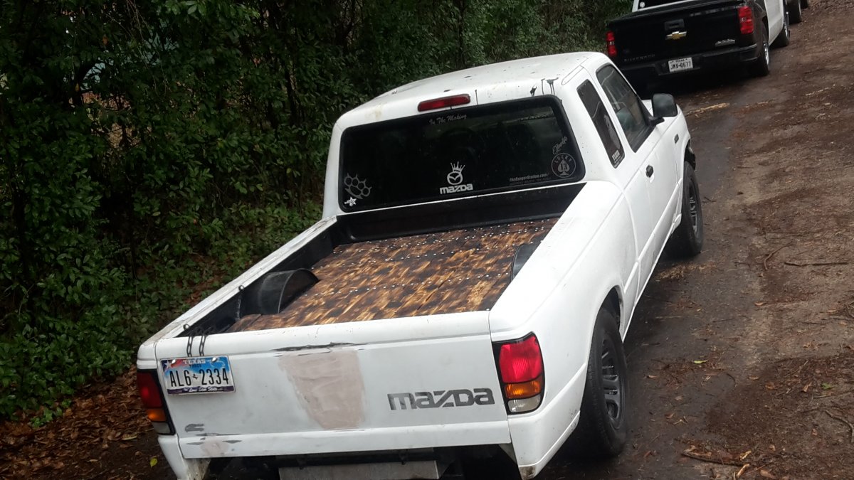

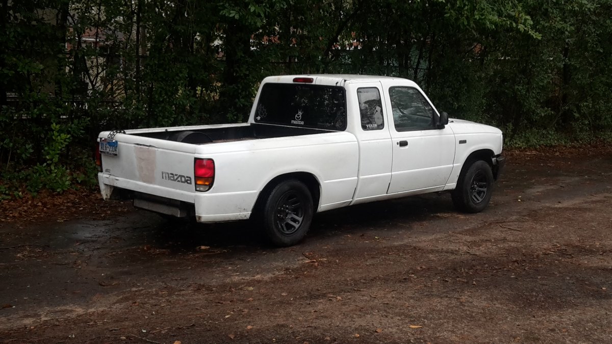

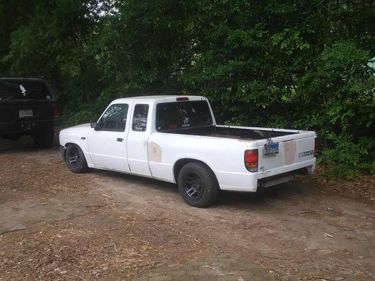

Just a few pictures of it as it sets now. Still doing body work on the bed and tailgate.

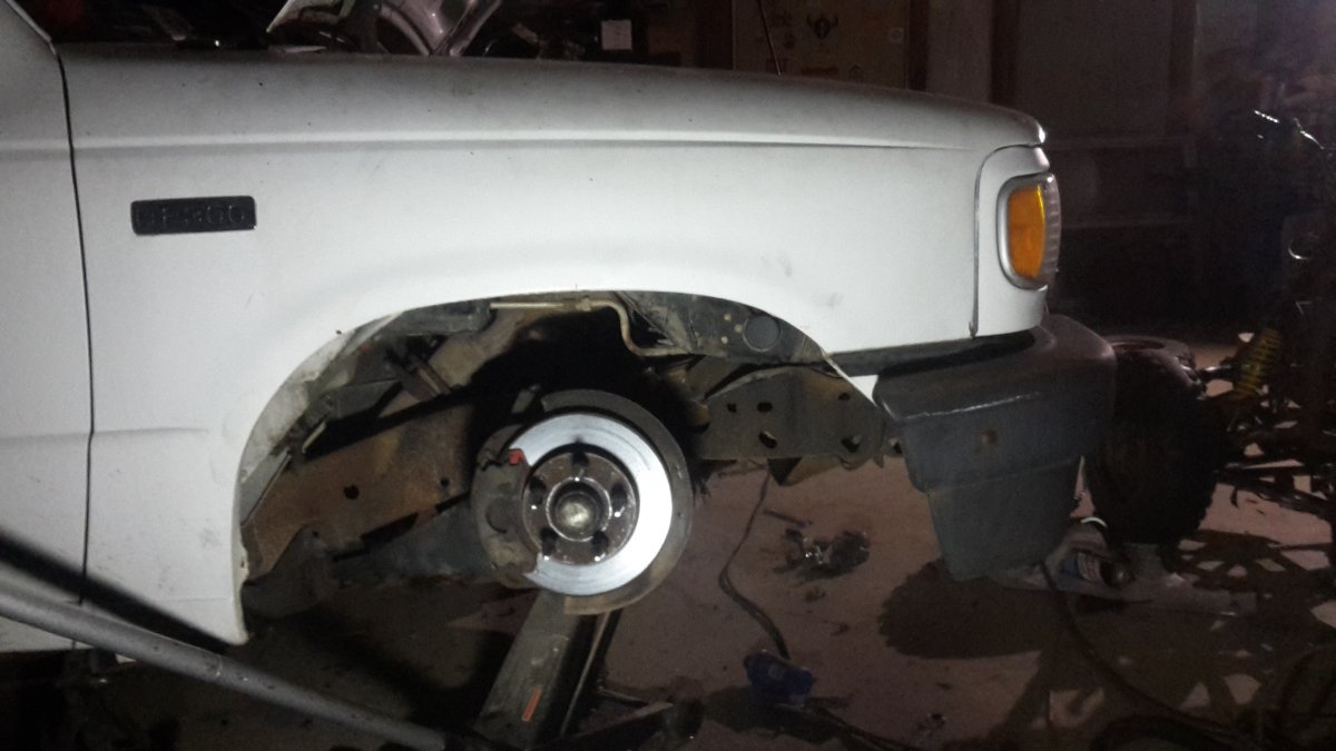

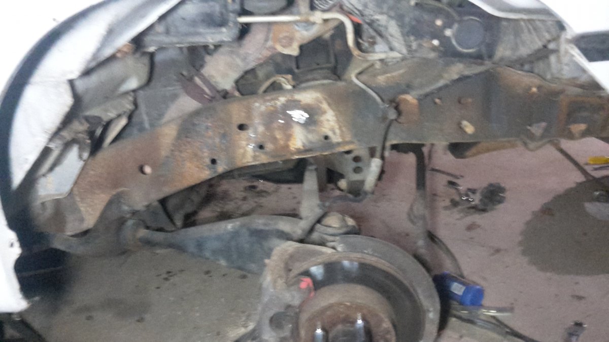

Started cutting out the front suspension to put the bags on the front. Got the sway bar out, coil springs out, radius arms are disconnected. Shocks out. Ran it up as much as it would go.

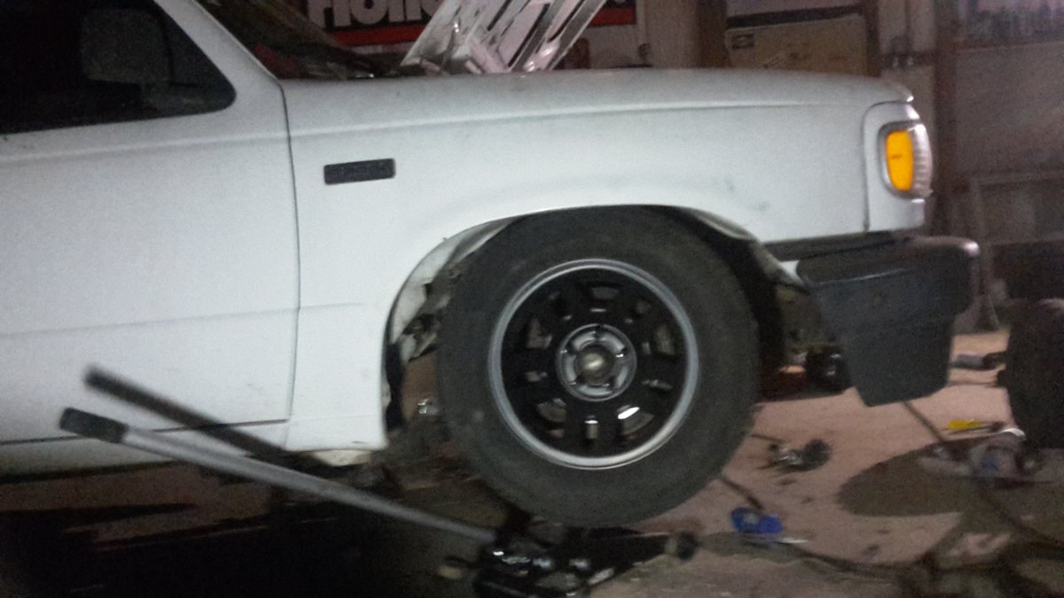

Put the wheel on for a test fit. Still have to notch the frame for the tie rods and remove some of the inner apron for the tire to tuck more. Then I will weld the bag brackets in.

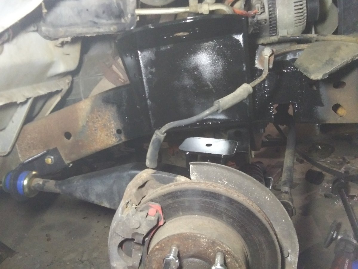

Bag Brackets welded in on passengers side and the tie rod notch welded on. There was a big hole in the frame above the tie rod notch so I cut and welded a plate above to strengthen it. Radius arms are relocated above the frame rail with new bushings. Not exactly sure what im gonna do on the brake line just yet. Sprayed everything with a coat of black paint for now to keep it from rusting. Had to remove the factory air box for clearance so i have to buy or make a cold air intake. Have to adapt maf sensor to the new intake.
  • Infamous mazda the $200 mazda build
Looks like it will work. Did you round the corners on the fishplate? Its hard to tell in the photo. Square corners promote stress cracks.
Yes rounded comers.....i dont like welding to points and stopping when I plate things.

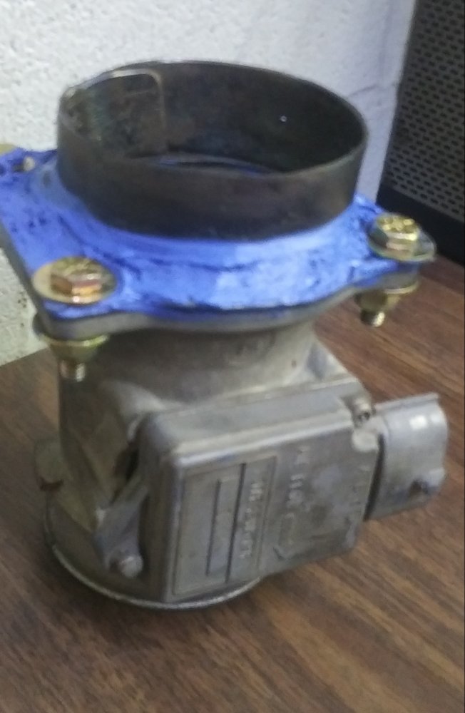

Had to pull the factory intake for tire clearance. Had a universal cold air kit on a shelve tucked away. I had to make an adapter so the maf sensor would work with the intake. Cut some pieces and welded it up. I put rtv around the weld just to make sure it was sealed good not pulling air through any possible little void. Not the prettiest, but it works and really wont be seen anyway. I will try and get a pic with the whole intake on there soon.

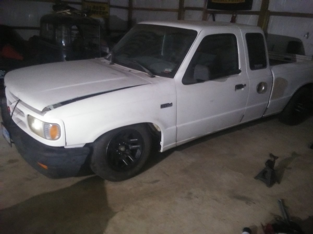

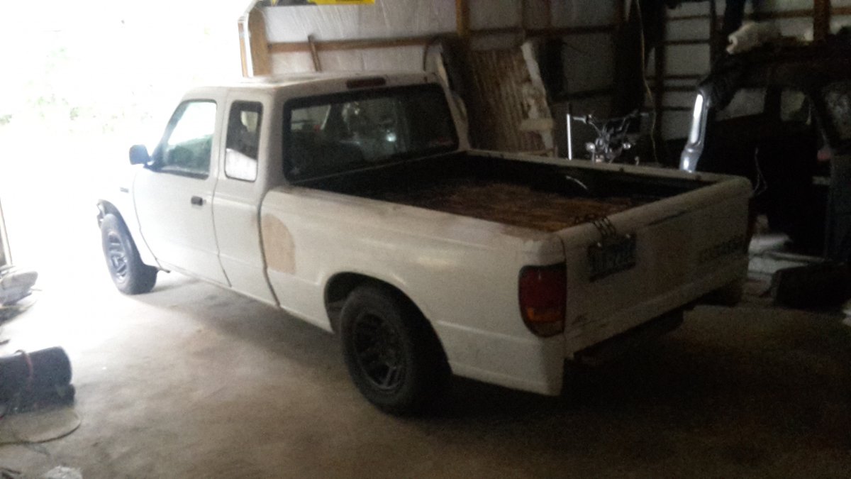

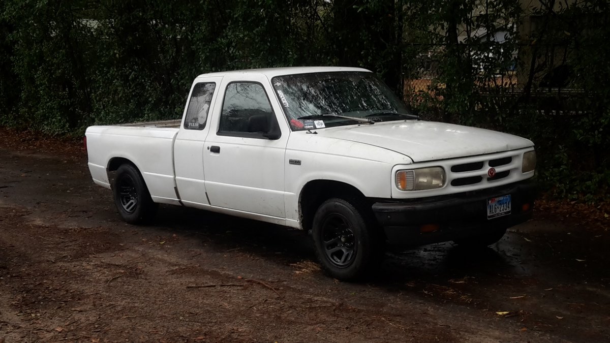

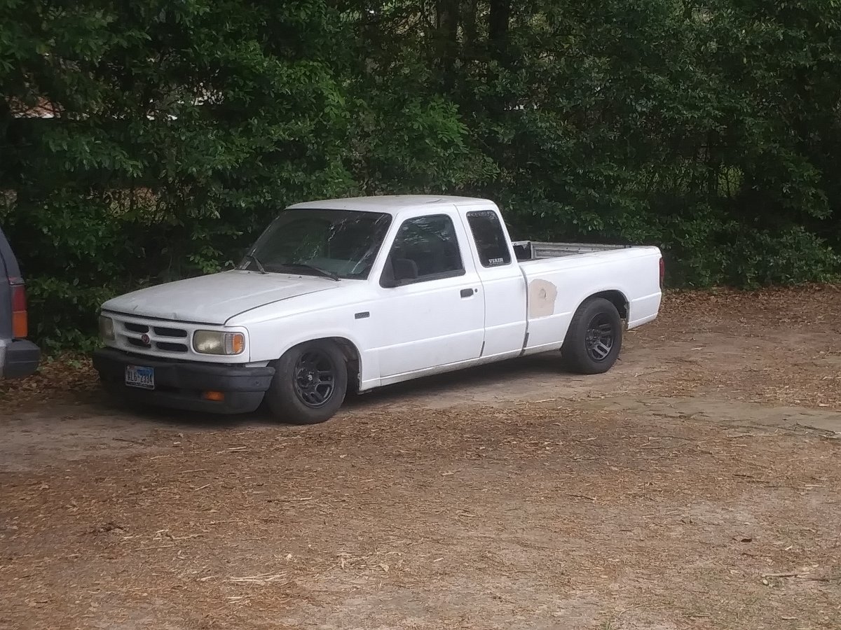

Just a few pics of it as is out of the shop for the first time. Had to make room in the shop to paint a truck so thought I would take a few pics while this one was out in the daylight again. A work in progress for sure, but it has come a long way.
