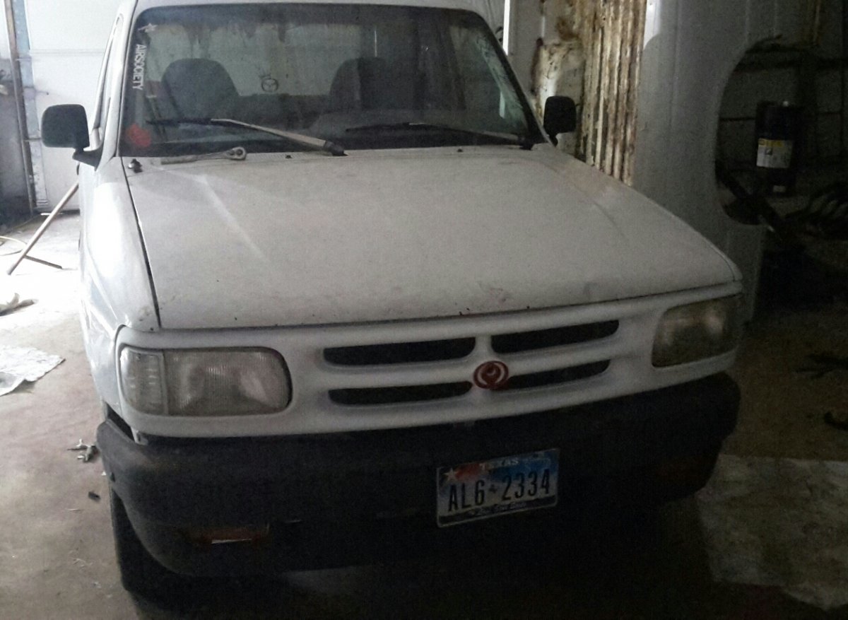

Starting a build thread. 1994 mazda B2300 4 cylinder, 5 speed. Been posting on here in the introduction thread. Will continue here.
  • Infamous mazda the $200 mazda build

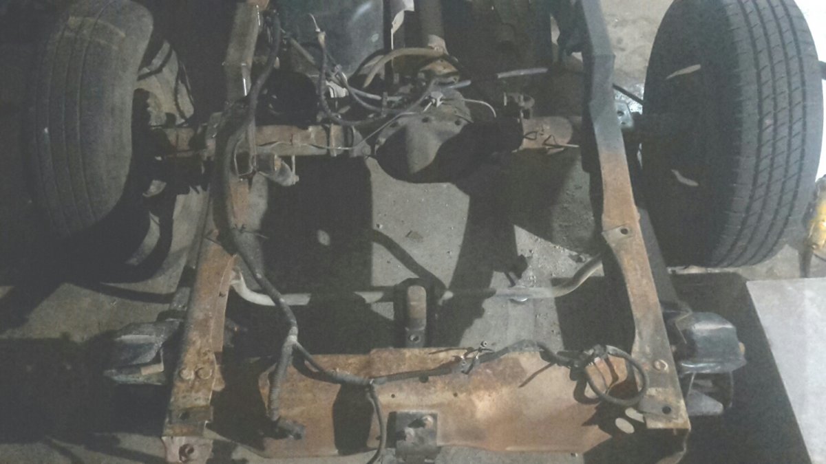

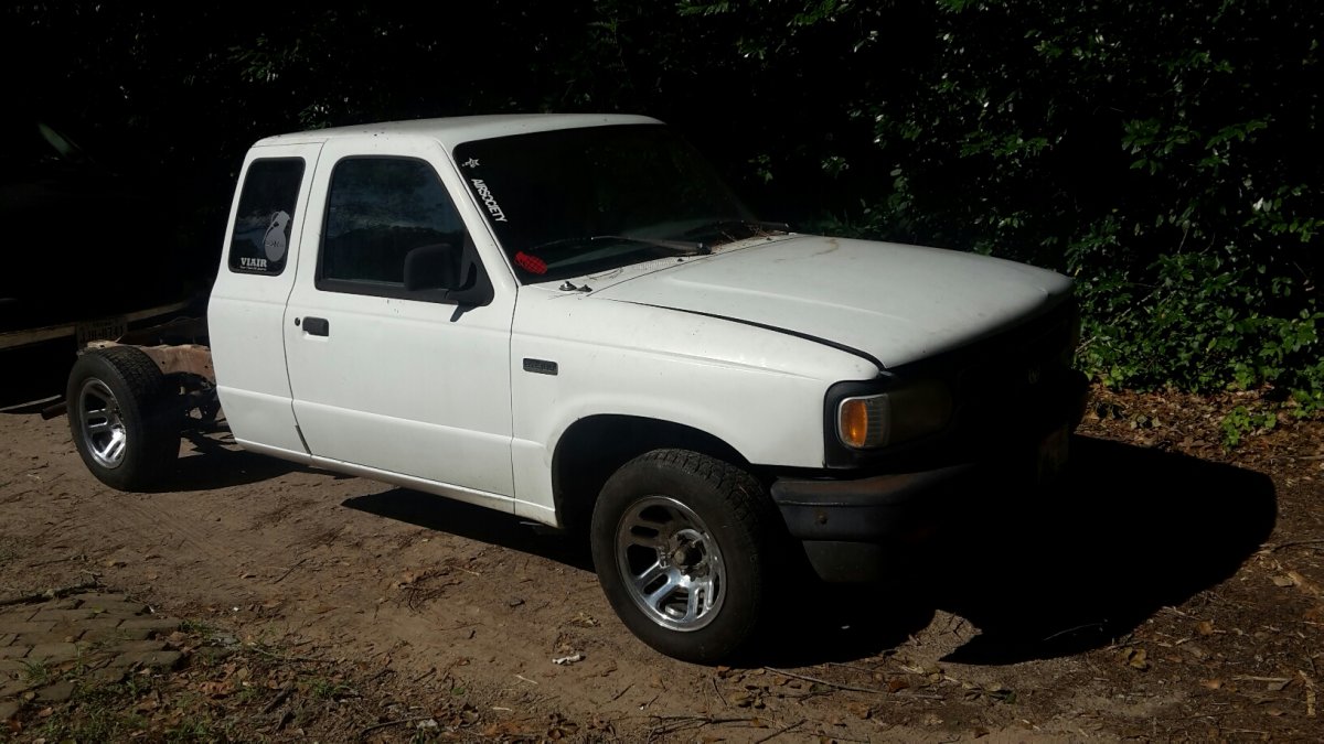

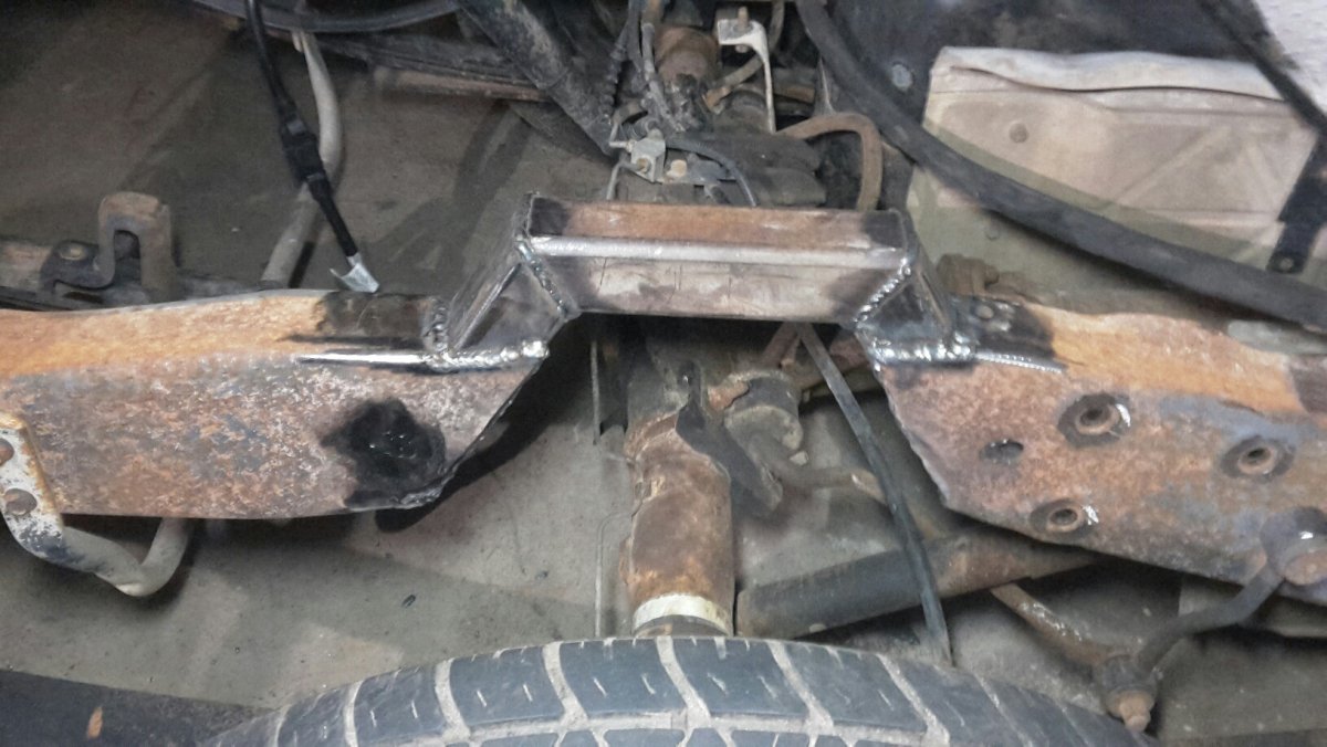

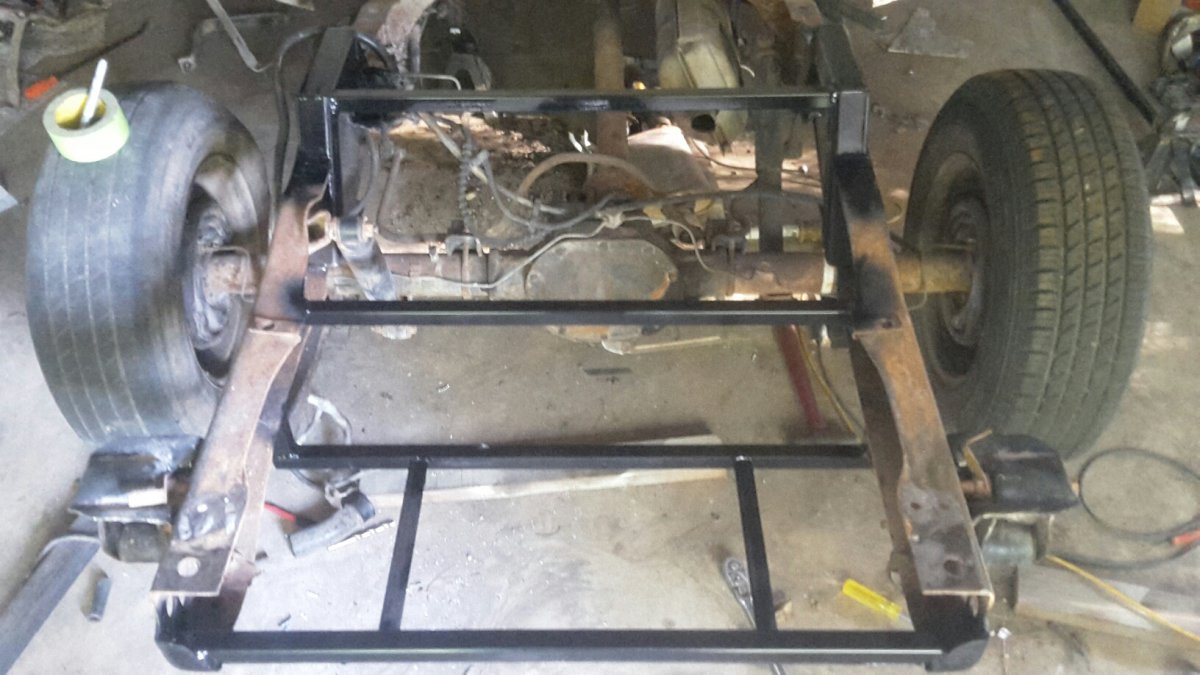

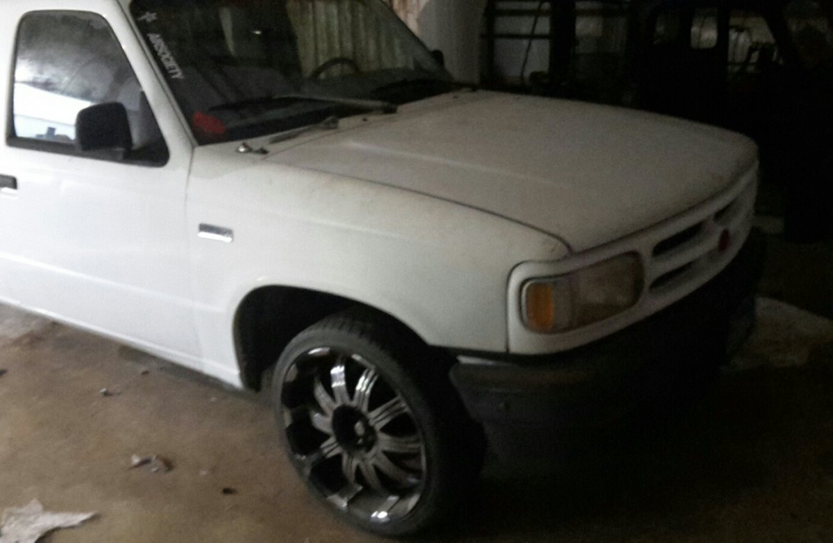

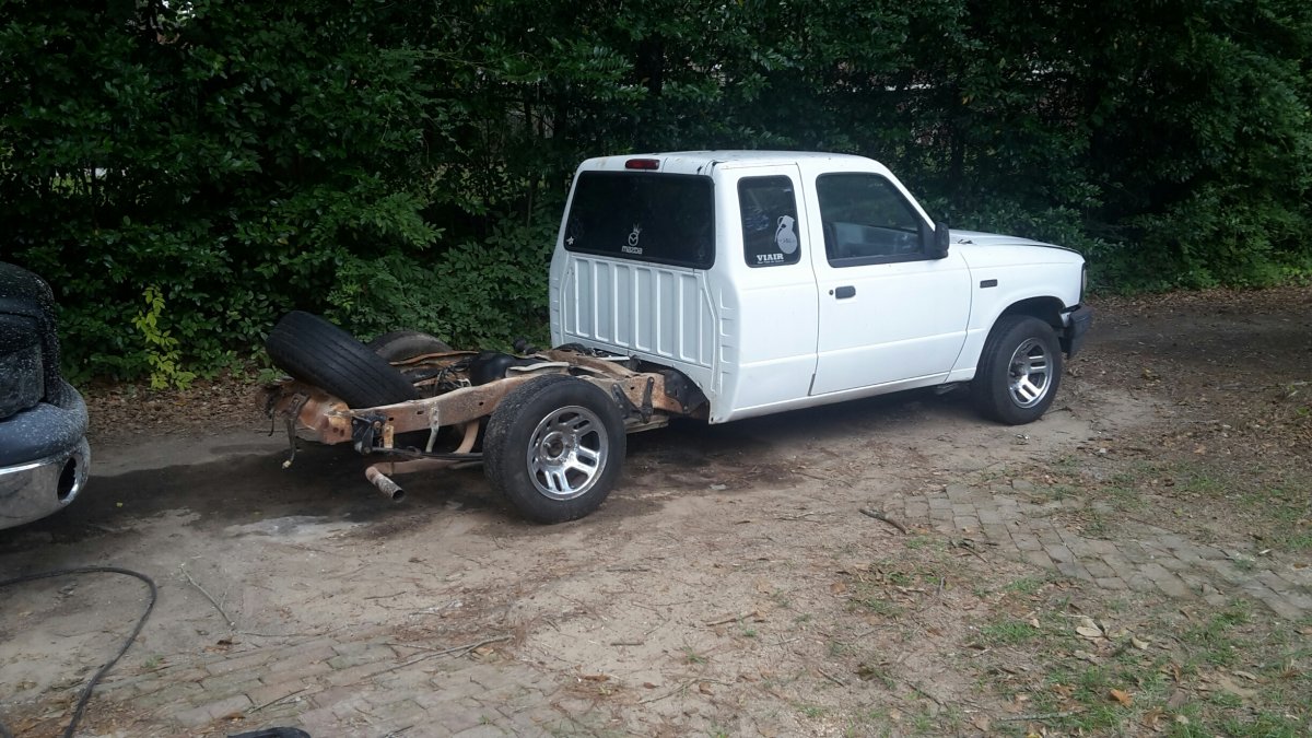

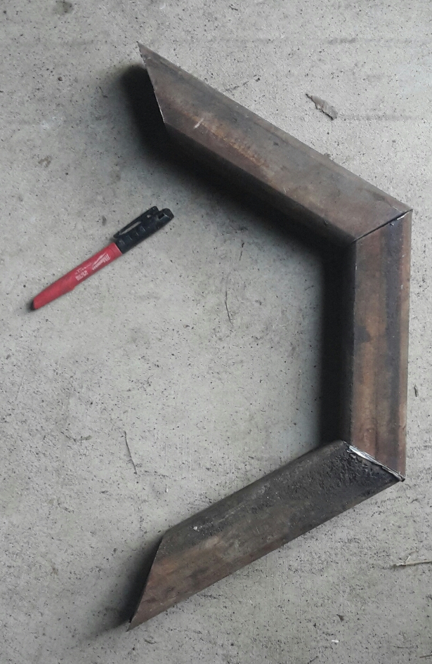

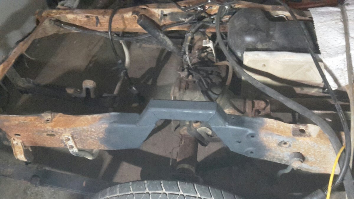

So quick little intro to bring everyone up to speed. I was watching mini trucker sunday (you tube phat phabz). Got some inspiration and decided I wanted to do a mini truck build. I wanted to stay low budget but build a cool bagged mini truck just like we did when I was high school age. I came across this mazda for 200. It needed some mechanical work and did not have a title. I have since gotten a title, had to replace fuel pump, coils, plugs, wires, fuel filter, got it back to running condition. Had to repair some wiring. c-notched the rear. Puts some 20" wheels on and and currently workin on the suspension, and bed floor. I am going as low budget as possible, using all metal I already have. Wheels I had already. Fabricating as much as possible. I will repost the picture I have already posted on the other thread. And post updates as I go.

Ho Lee Shite that c-notch is unsafe as hell. Regardless how it's keyed in to the frame, it still needs some fish plates over the miters, at the minimum..
Lol. Don't assume. It isn't finished yet. Still have to box in the inside frame rail and cut diamonds to lay over the welds and weld in on the notch, and probably a bridge bar. I have to pull the fuel tank to finish the notch. No room to work around it.

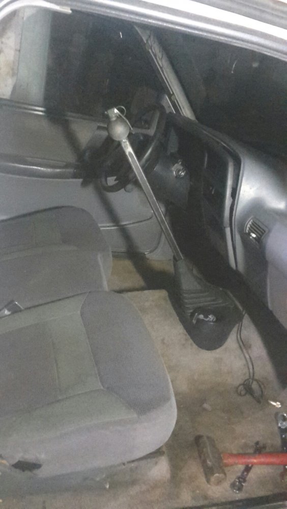

Built a tall shifter. Kinda rat rod style with a grenade on top. Bare metal clear coated. Installed it.....pretty nice I like it.

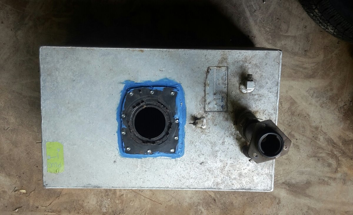

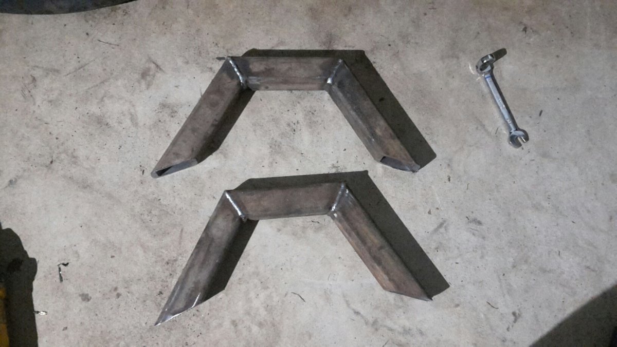

Finally finished all the mounting brackets for the fuel cell. Put some black paint on there. Nothing fancy
Cut the fuel pump ring off old fuel tank and made clearance to mount it in fuel cell so I can use the factory pump (which is brand new) I prefer drilled holes, cut a piece of gasket material, got it to match. Spent a long time cleaning inside of fuel cell free of any dirt, shavings etc. Mounted it all and used rtv for some extra seal. Not pretty, but it will be under the bed floor anyway.

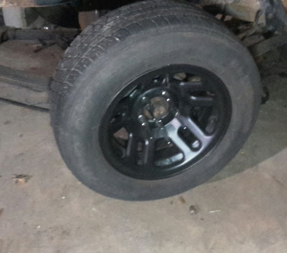

Fuel cell is wired and plumbed. Truck. Runs great on it. Fuel gauge even works fine in the fuel cell. Been finishing up some welding on the back. Fish plates on the notch and remove factory shock mounts. Decided to put the 20" wheels on my jeep and go back to the stock wheels. They were chrome and had some scratches and issues, so I went the black wheel route with some plastic dip. It will work for the time being. Got some chrome lug spikes just for shiggles! I will try and post more pics when I get time.

Just an updated pic of the black wheels with the new lugs.
