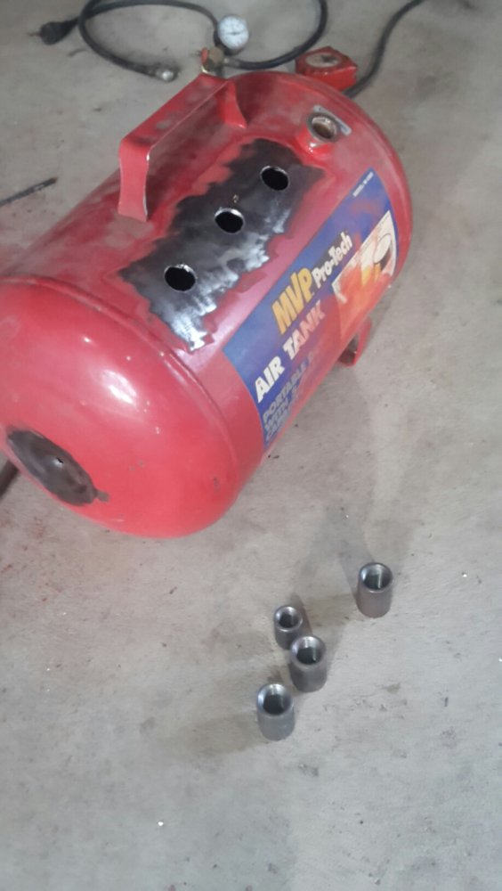

I'm also currently drilling some holes in the air tank to weld some more Ports in. I'm gonna put in 3 more 1/2 inch ports, and a 3/8 port on each end.It is just an old portable air tank I had lying around.

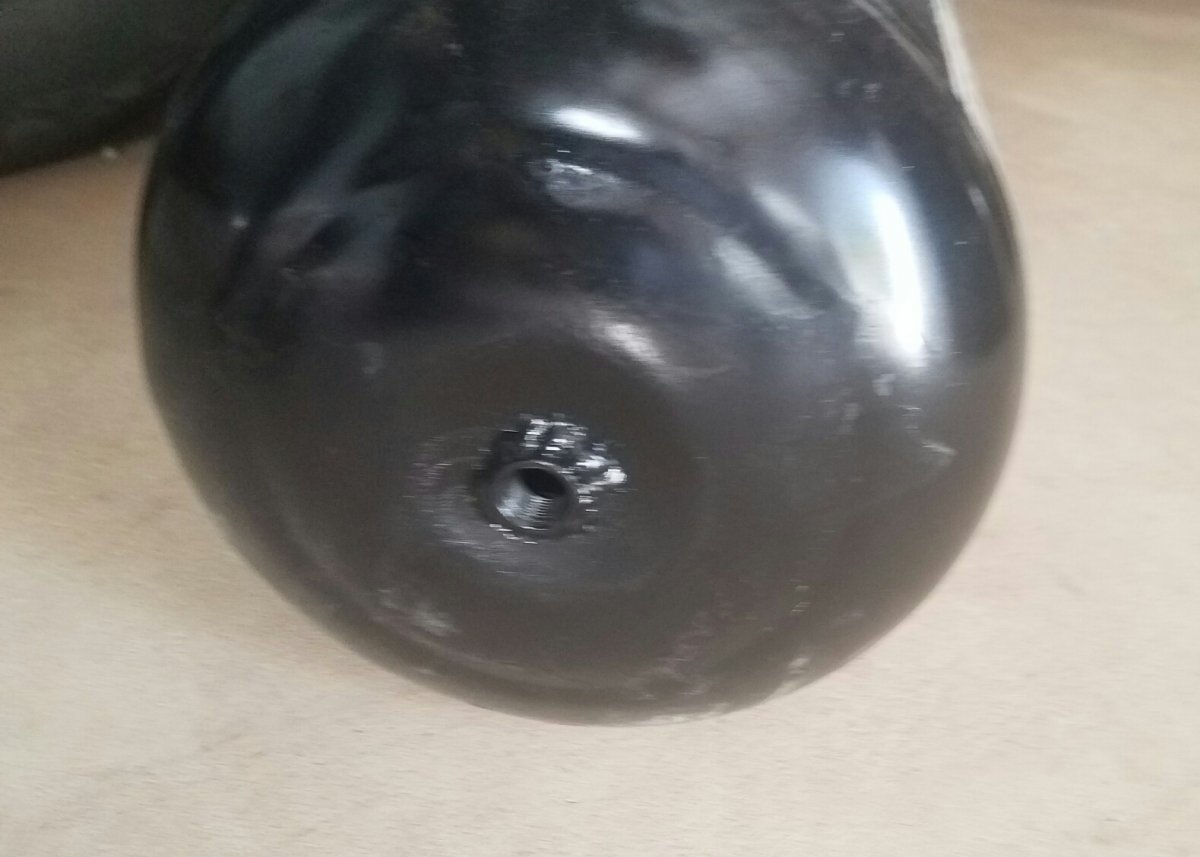

Finished welding ports in the air tank. Have 4 on top and one on each end. Then painted in black.

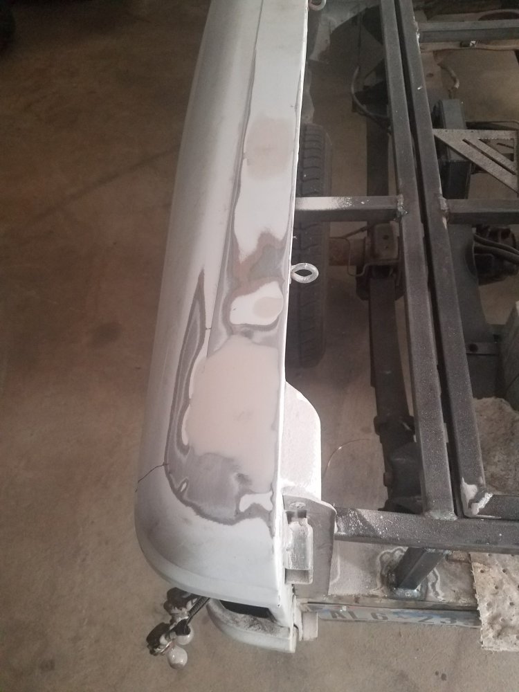

I got all 4 stake pockets welded up and grinded smooth. Put the first coat of body filler on and sanded it.
  • Infamous mazda the $200 mazda build

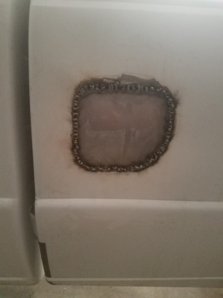

Since I put the fuel cell in, there is no need for the old gas door. My filler was for a ranger so it had to be modified slightly. Have it almost fully welded . Then I will grind it smooth and start the body work on that.
Finished welding up the Gas door filler. And started bodyworkInfamous mazda the $200 mazda build.

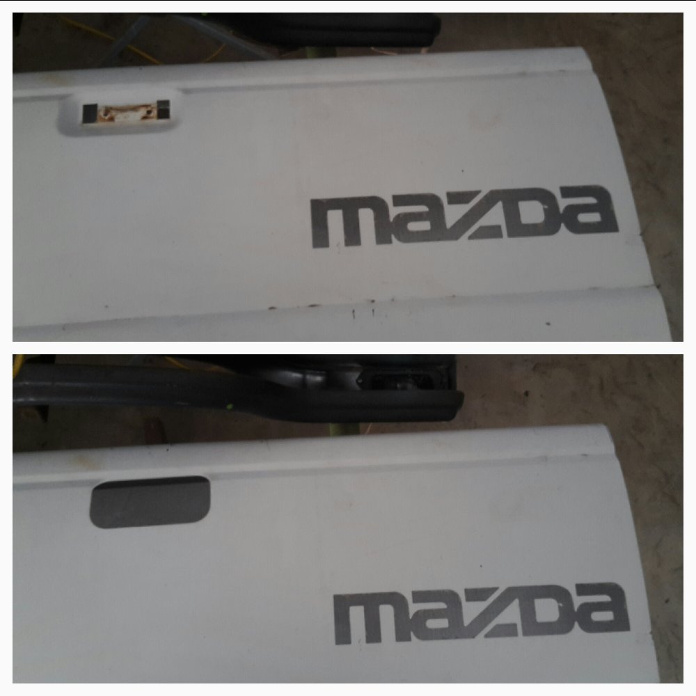

Pulled the latch off the tailgate, working the filler plate to get the proper body line in there.

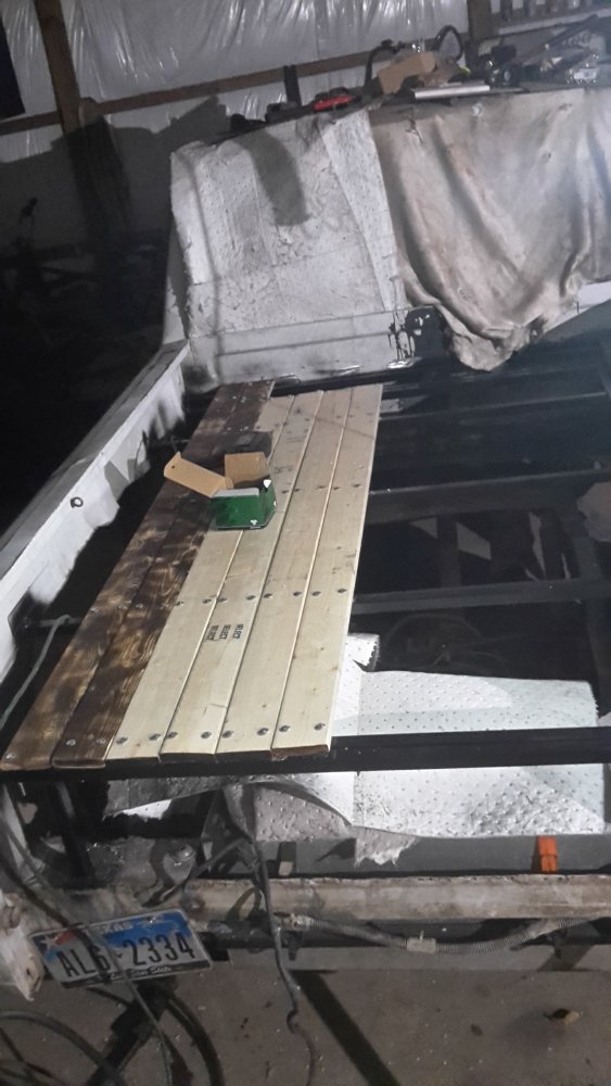

Trying to get A visual of how the wood will look in the bed. I burned a few with the torch, and put a few plain ones on. I think I'm gonna burn all of them. Drill all the holes then give them a few coats of water sealer. Lock them down with carriage bolts.

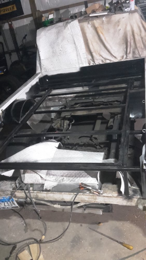

I needed some wheel tubs in the bed. Not wanting to spend money on trailer fenders I decided to cut up a 55 gallon drum I had. Got them welded in.
Been working on the be floor more got it almost all there. Still have to burn and seal half the boards on it. Finished welding the wheel tubs and put seem sealer around them.

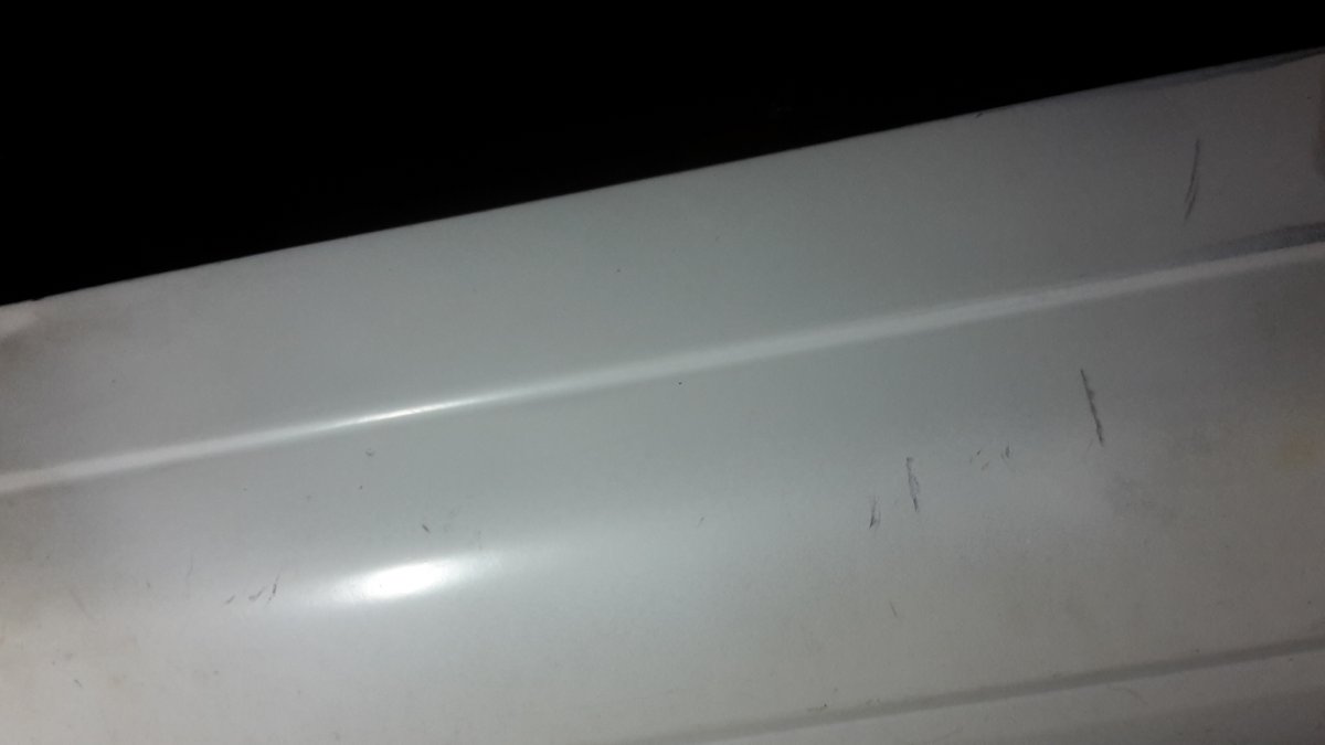

I got some body work on some of the stake pockets and a couple holes and dents I welded up done. Put a light coat of white primer on them

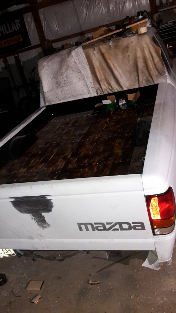

Bed floor is almost done just a couple more end boards to cut burn and seal. Then I have to build a latch for the floor
Another bed floor picture. Still doing some work on the tailgate. Filler fully welded
I installed the handle relocater inside the tailgate I will post pics of that when I can. The bed turned out good but it was a lot of work. I have about 80 hours in the bed floor alone. About 200 carriage bolts, nuts and washers. About 60 dollars in supplies and a lot of labor.
