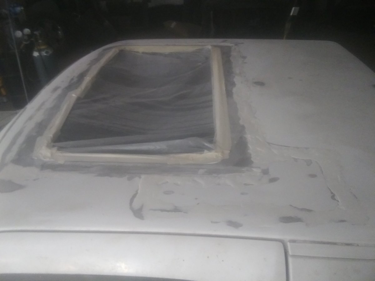

There it is with the glass installed. I already wired up the switch. Just need to finish the bodywork on the roof and run the drain lines down the pillars. I had to weld a piece of 1" square tubing with a nut inside that hung down about 1 and 1/4" on the inside of the roof on each side to hold the guide rails in the very back. It all works just like factory. Open close and tilt.

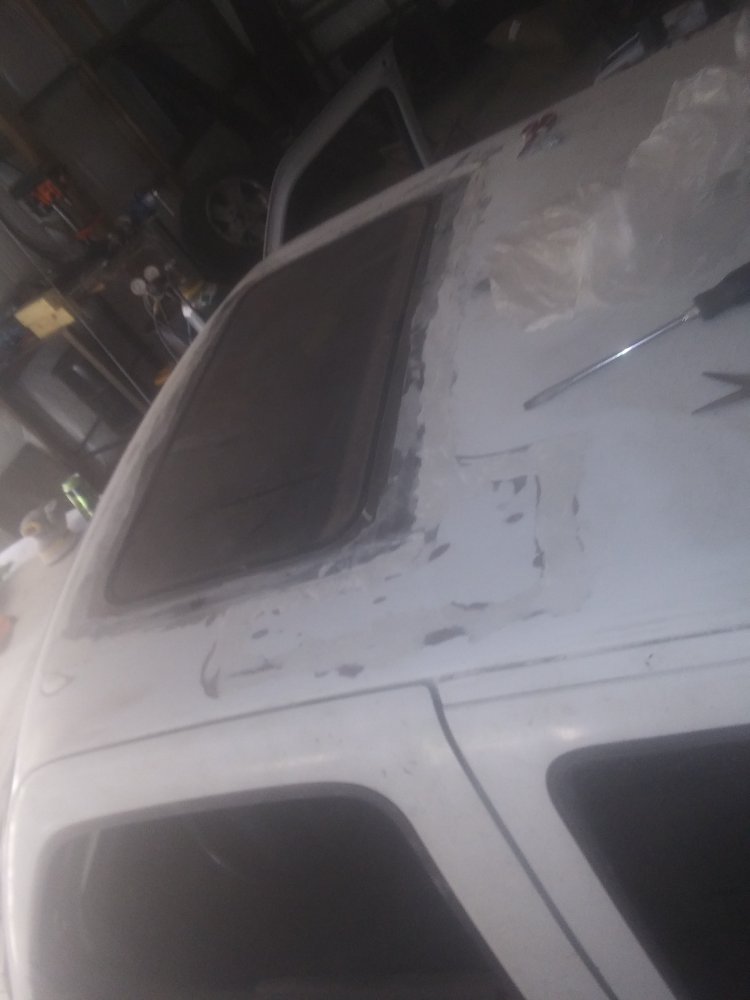

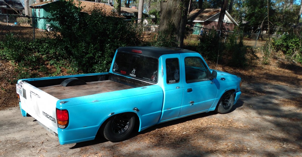

I got the roof kind of roughed in and sprayed it with rubber undercoating. I'm not going flawless this is a low budget ratrod kind of build. Got about half the truck done in the baby blue fauxtina

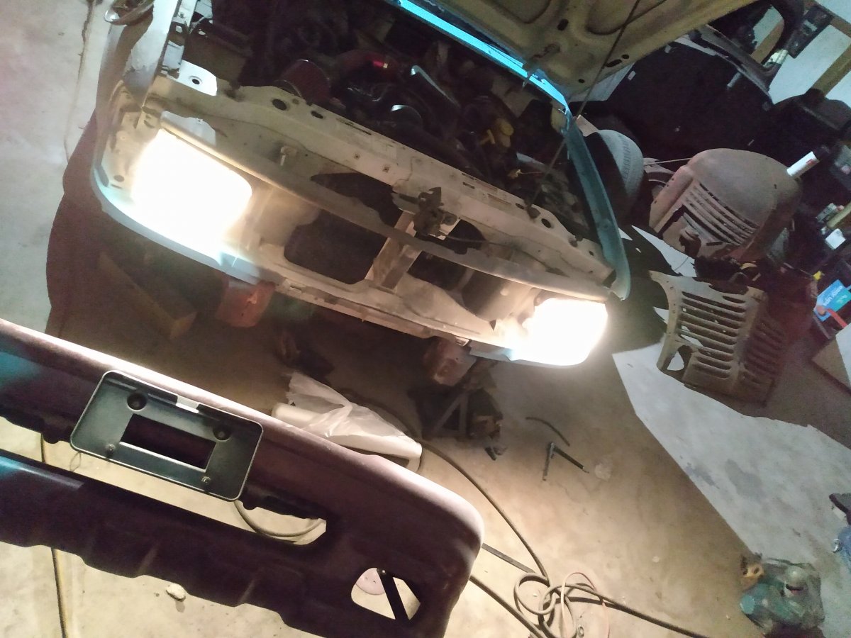

Mercury headlights wired up.

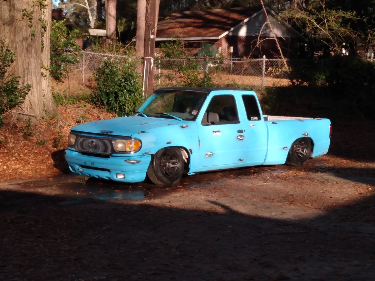

Looks like the camber is a bit off up front ;)
Are the scuff marks on purpose (like fake bullet holes), or just waiting to finish paint?
Are the scuff marks on purpose (like fake bullet holes), or just waiting to finish paint. No that's the faux patina look I wanted... I guess I don't understand on the camber comment. I beam suspension....on air bags........layed out......negative camber...........lol should it be At 30 degrees and mines 35 degrees.....lol.
So it rises up a little when you start driving? The front tires look tilted in at the top.
Been driving !!!!!

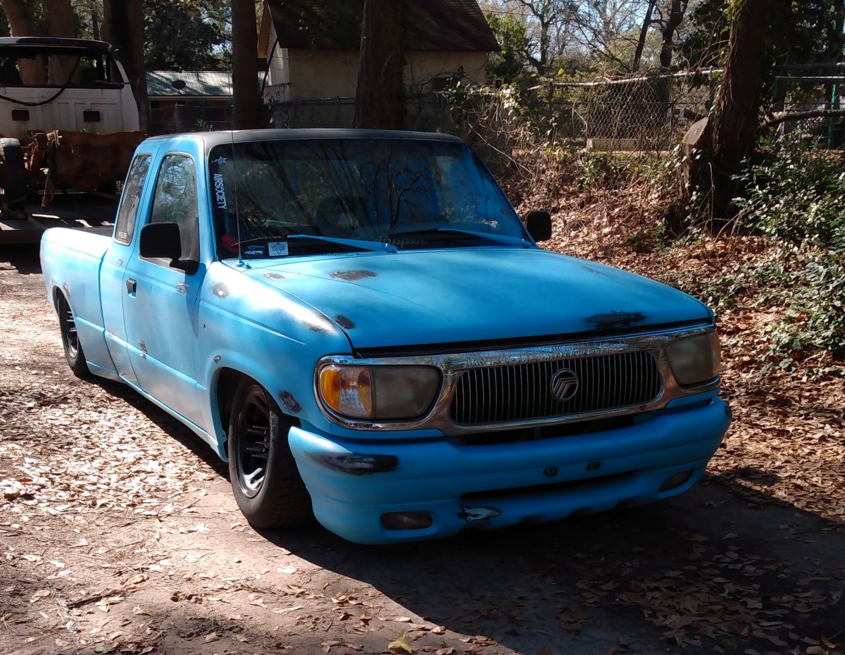

Well it's been a fun build. This is as far as I'm taking this truck and don't plan on building any ford's in the future......thanks TRS.......infamous Mazda signing out!!!!!! ✌️
