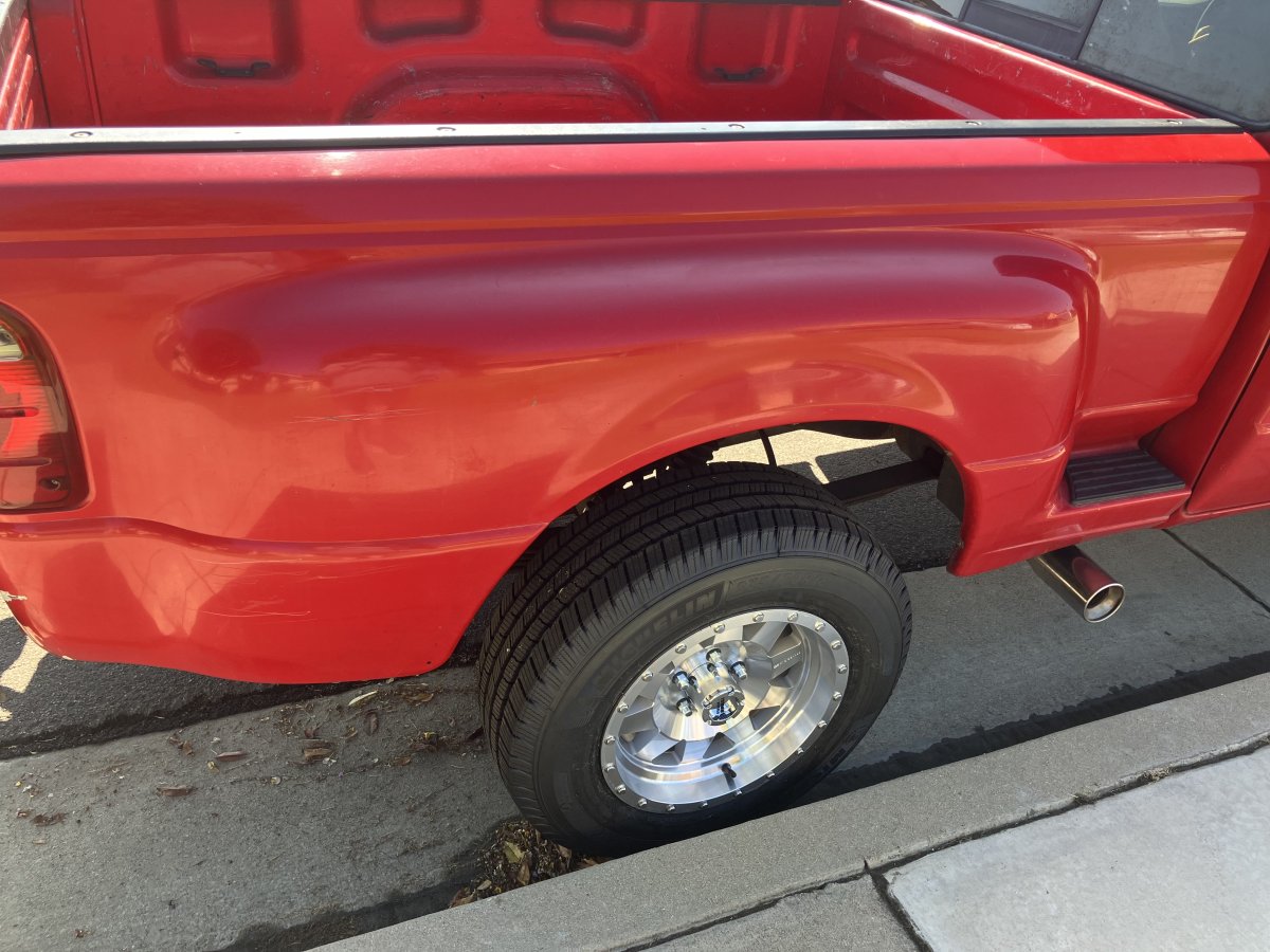

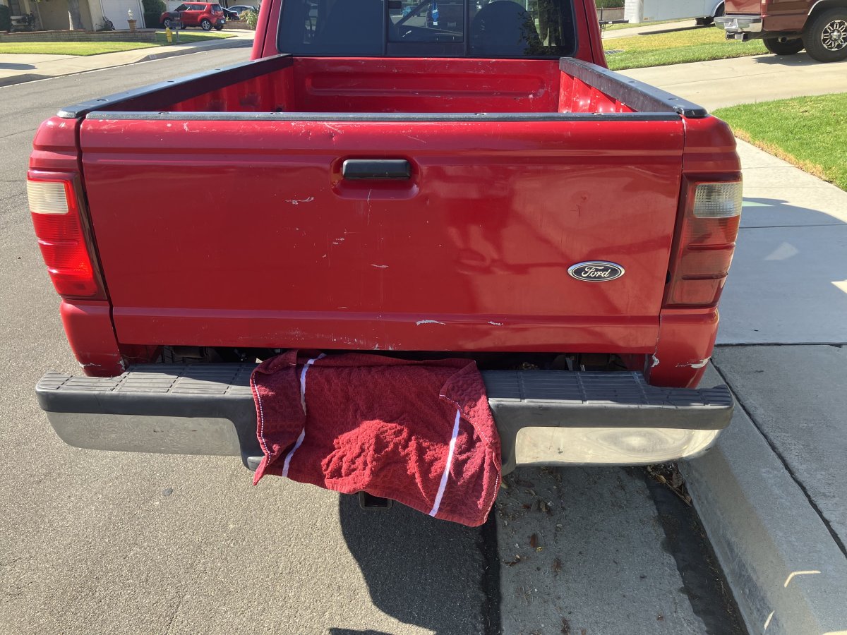

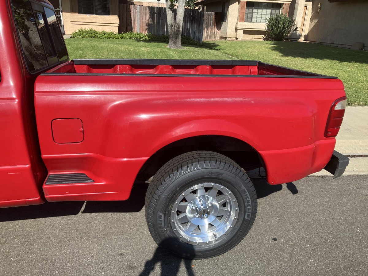

Im looking to buy a new Bed/box for my 2001 Ford Ranger xlt double cab 2wd Flare side. I live in California So if you have one for sale send me a message.
I would prefer a 2001 bed/box flare side that is 2001 or newer

You're in California, you have pick-n-pull's all over, looks like several of them have plenty of Rangers to choose from.
Your truck is 4th generation. 1998 - 2003 so, anything in those years will be perfect. 5th gen, 2004-2011 will also fit. But there could be tiny little differences in body lines. I don't think it would be very noticeable.

I have a flare side bed on my truck currently and am looking for another flare side bed. Mine is Bowed out and is not level on the truck, so its no good and i don't think any body shop could fix it. I have to replace it. When i say bowed i mean bent from the back to the front so the whole bed is bent and won't sit level on my truck.
So from what i understand any 1998-2003 bed would fit my truck am i correct on that. Whether it be an edge,4x4,xlt etc and whether it be flare side or straight with or without molding on the top.
There are 3 bed types flare side like mine, then straight bed without plastic molding on top, then straight bed with plastic molding on top. And there all suppost to be 6 ft long.
