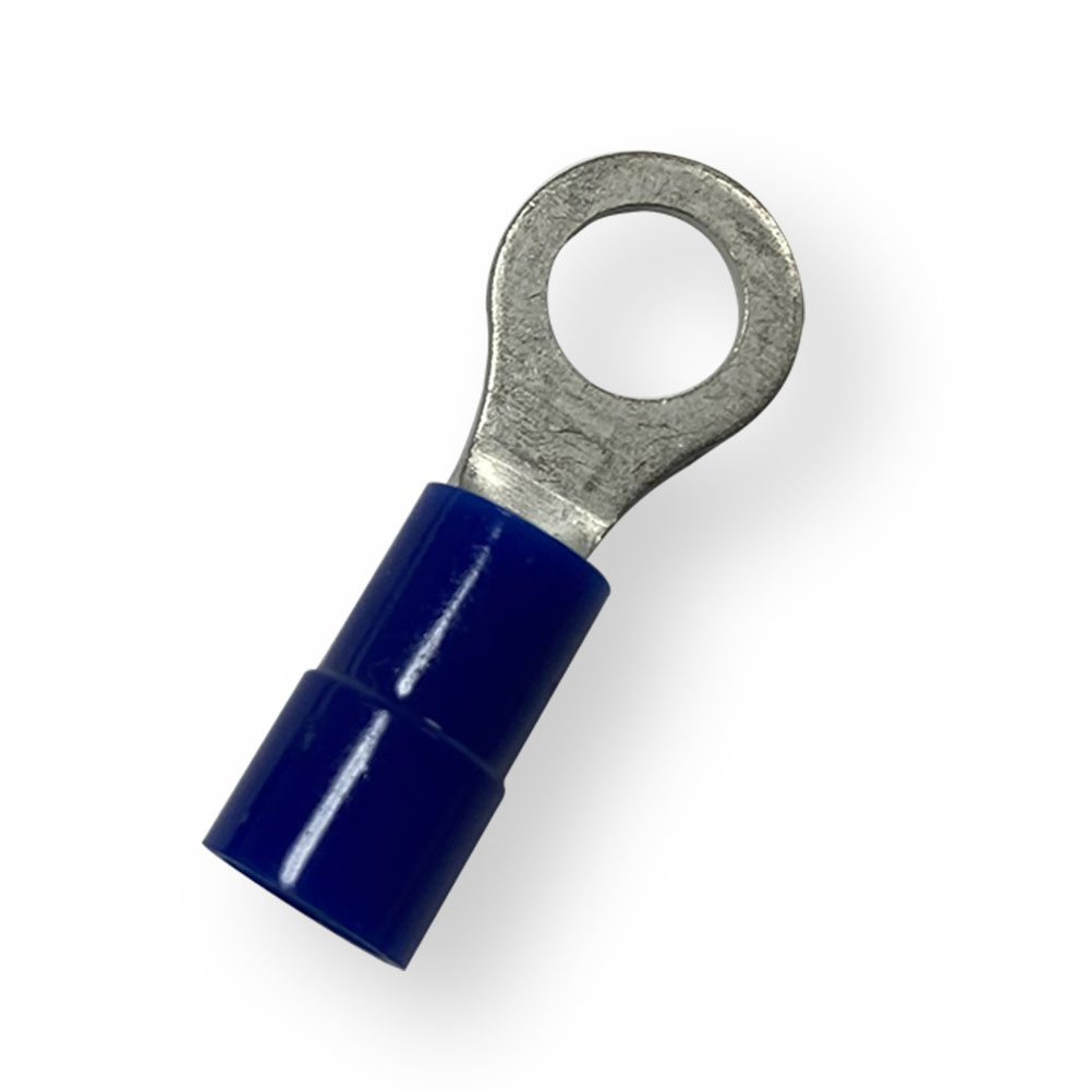

All,
The oil PSU connector is in terrible shape, and all three connectors to the alternator on my '84 B2 are well beyond their prime. I know I can find the PSU connector (they command ridiculous prices online), but I don't even know what to begin to call those style of connectors. The alternator connectors appear to be the same style, only they have covers over them. Everything I can think to call these in a search yields anything but.
Appreciate it if someone can tell me what these are called and/or where to find them. Thanks
Just a crimp with a eye on the end and a nut works for most of those connectors that slide on a stud. Like this.
Here is the original push on style.
That a pretty good price. I'd probably crimp a butt splice onto the stud myself.
