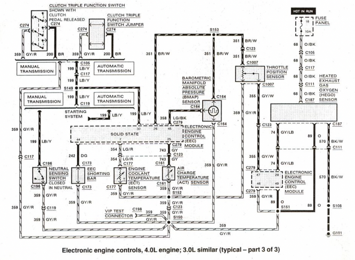

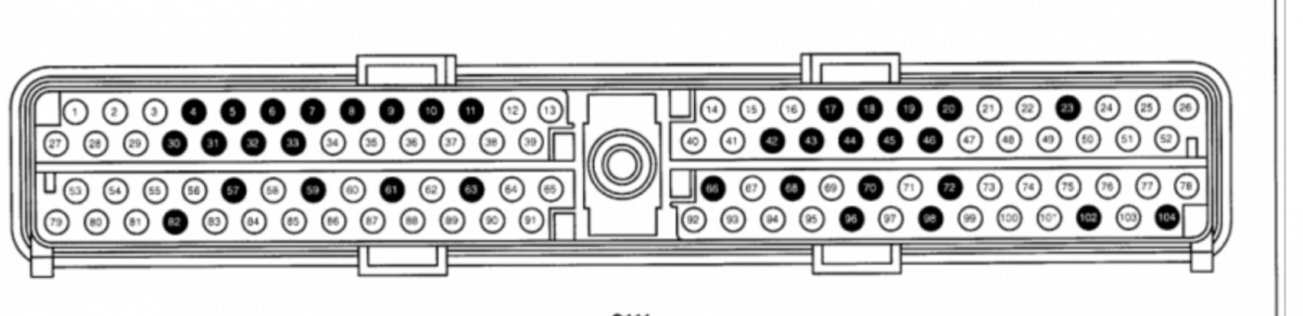

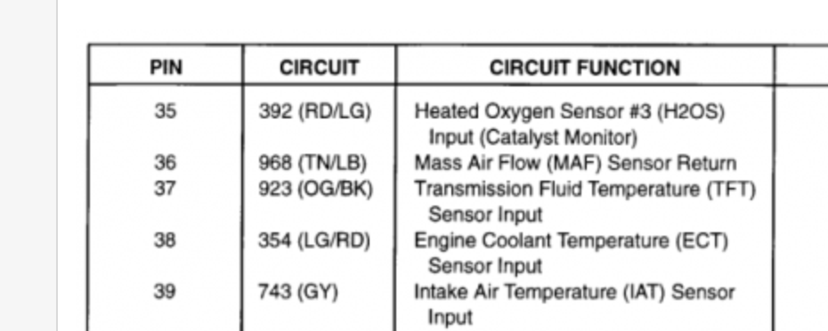

I have no voltage to my engine coolent sensor Im not sure if its a wire problem or ECU? I think the pin no. is 38 but is that looking at the ECU or the Plug?

So I moved your post to the 3.0L forum... I also deleted your duplicated post.
ECT gets a 5 volt reference voltage and the signal is pulled low at the ECM. The 5 Volts reference is shared by other sensors on the engine. So if you have 5 volts at say the TPS... the ECM is fine. You most likely have an open in the 5 volt ref circuit. Also... there is no ground at the ECT.
I thought this post also had the schematic that the other post had... but it didn't. If I remember the 5 volt ref was on pin 40 and the signal return is on pin 38 maybe. If you repost the schematic we can double check those numbers.
Up date, at pin no, 38 I have 2.7 volts I thought it was 5v ?
If that's the signal return, it could be less. The reference is 5 volts and the sender drops part of it. That 2.7volts is what the ecu interprets as "x degrees". So, depending on the temperature, you could get a return anywhere between 0 and 5 volts or some range within those values depending on how the circuit is designed inside the ecu.
Ok Thanks Eric, im getting somewhere , so I see the coolant sensor and others are all connected to a Gray/Red wire, is that a ground? what do I test it to? Volts or ohms?
Also after I replaced the heads my temp gauge isn't working? could I have pinched these wires somewhere along with the coolent sensor wires ?
That gray/red wire is the 5 volt reference. you test it with a voltmeter.... all sensor should have 5 volts on that circuit.
