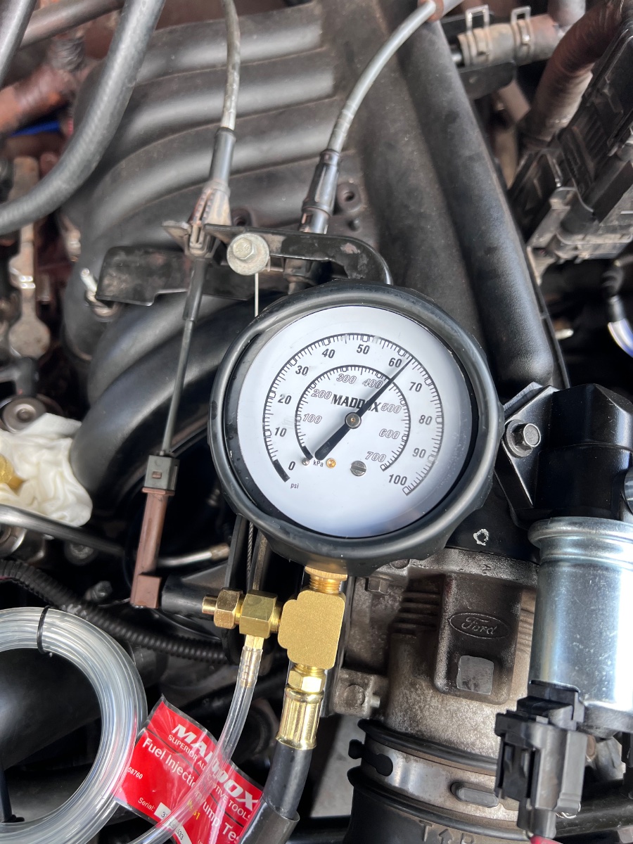

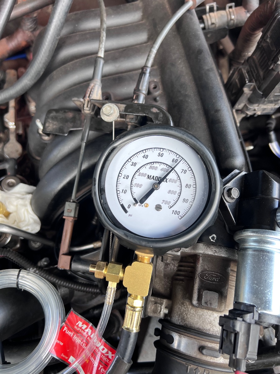

After all that, she runs great. Until she doesn’t. It frequently stalls at idle, never under power. When it does, it takes upwards of five or more minutes to get it started again. Sometimes even without stalling it will still struggle to start. It never happens on a cold start, only ever after it’s warmed up a bit. I’ve taken it to a few mechanics and they all say that it seems like it’s just not getting enough fuel, but the injectors look fine and test okay. When they spray starting fluid in the air intake, it almost nearly starts. Finally, after putting in a new fuel pump just a couple days ago, she left me stranded in a parking lot. There are zero codes, and the only light on the dash is a persistent air bag light.

So, what is your fuel pressure?
And I see fuel pump on your list but not fuel filter or fuel pressure regulator. Let’s test fuel pressure first. Hate to see you spending more money just on a guess. It’s cheaper to troubleshoot and diagnose.
I did a fuel filter too, just forgot to list it. Will a pressure test confirm pressure before or after injectors?
Before injectors. After injectors would be cylinder pressure which varies wildly depending on where it is in the 4-stroke process of suck, compress, bang, blow.

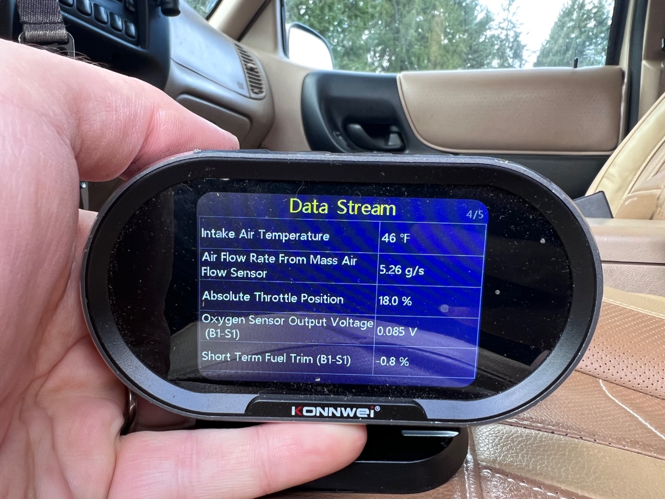

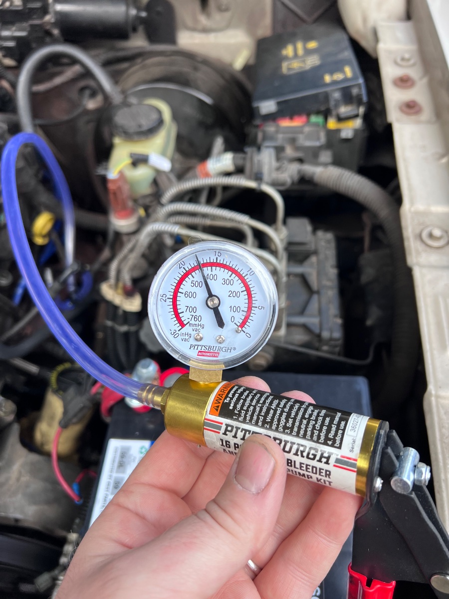

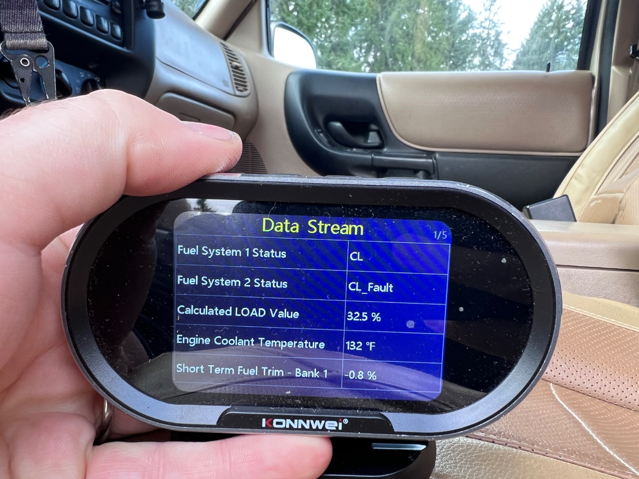

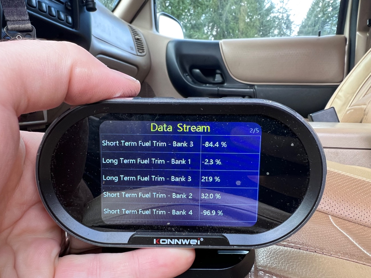

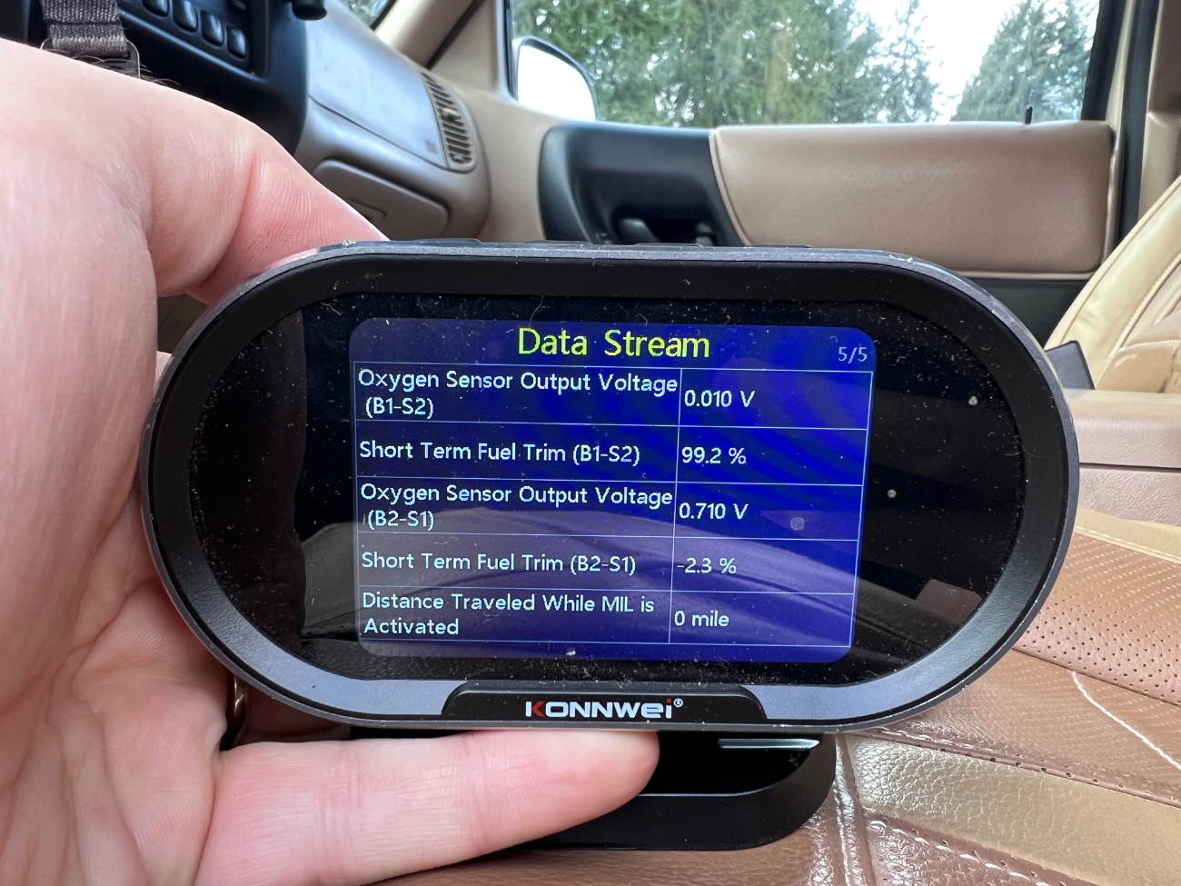

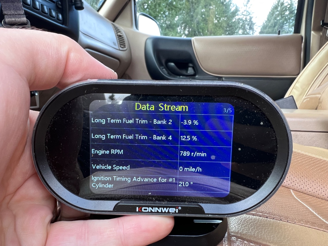

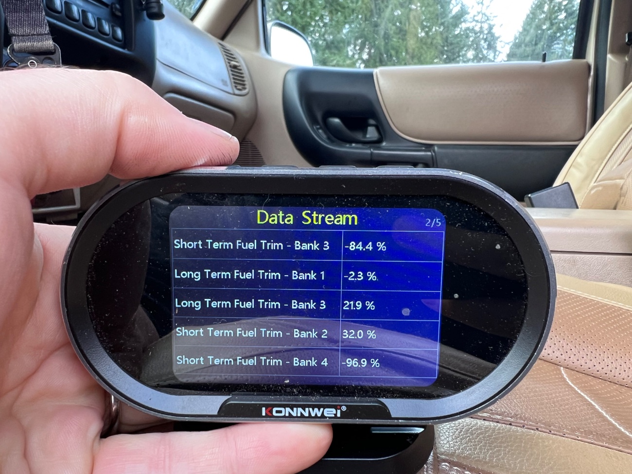

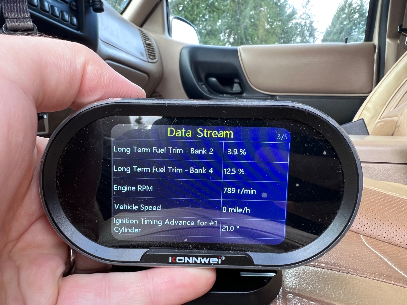

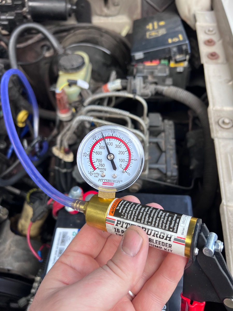

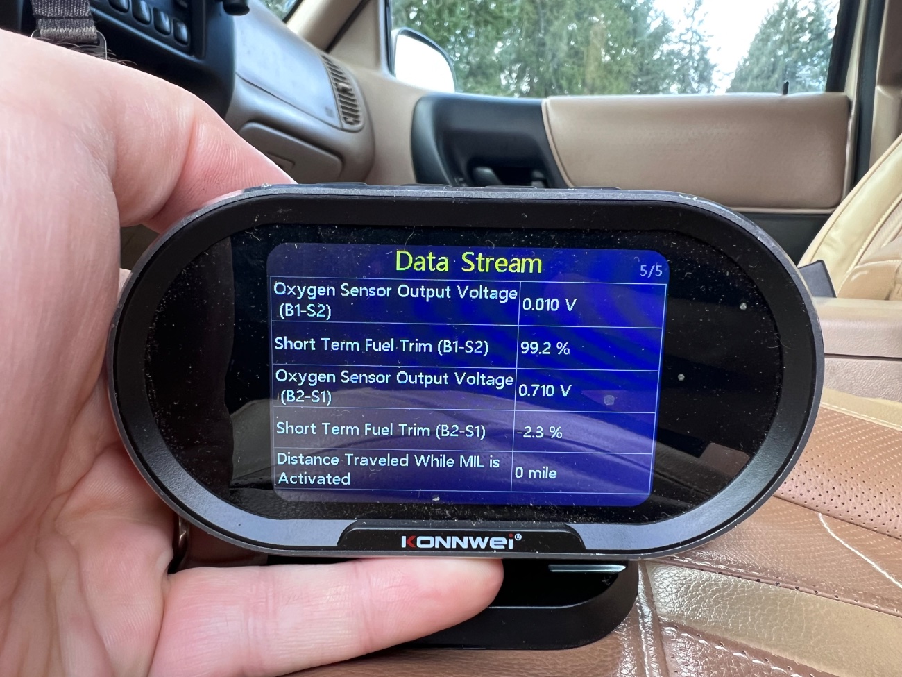

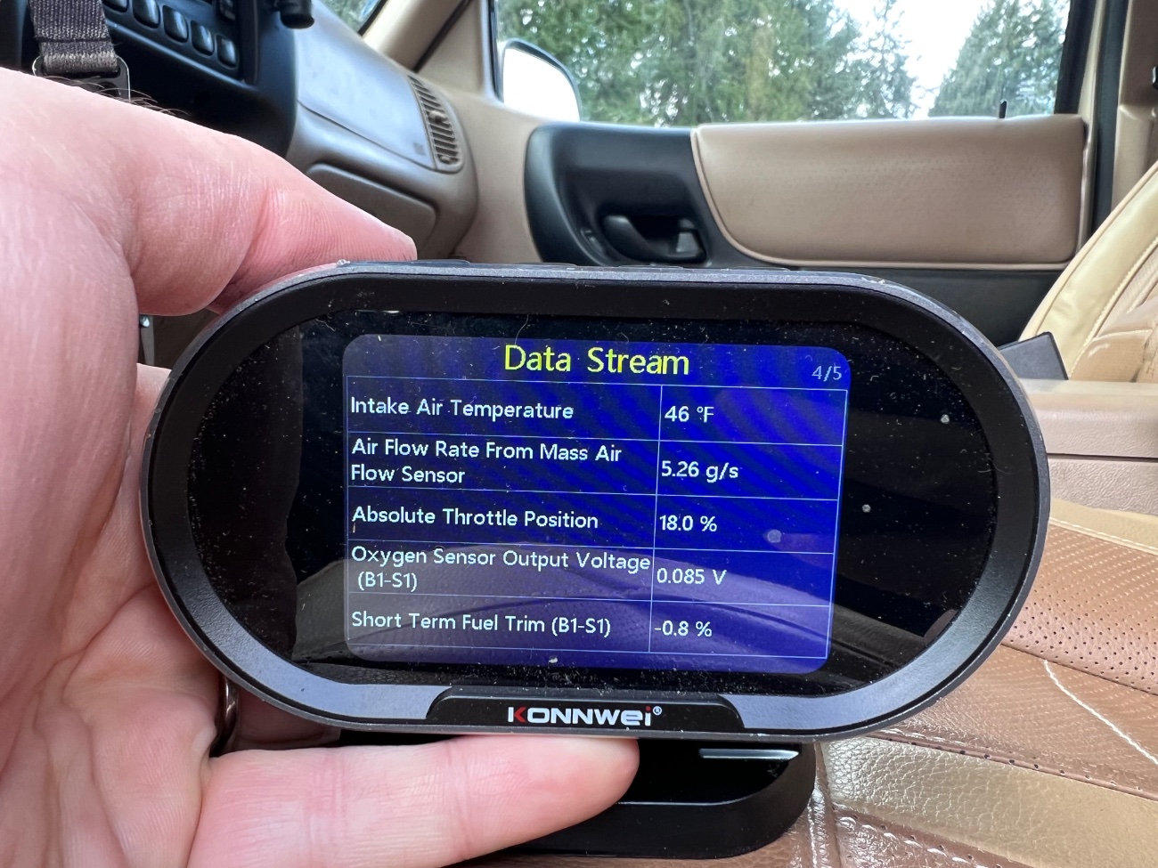

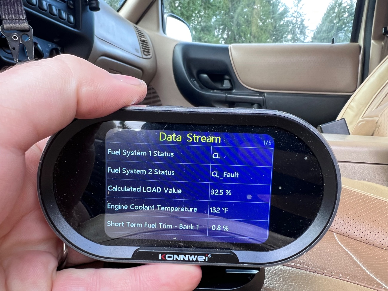

I tested the fuel pressure and only got 4PSI (YIKES). After digging around I realized I had a faulty Evap Canister Purge Valve. I replaced that, and suddenly my vacuum and fuel pressure were within normal ranges. I thought everything was fine, but it stalled on me again just this morning. Here are some photos of my obd2 reader when I tested vacuum and fuel pressure. It’s not the best reader, and I’m not sure what I need to be looking for, but maybe it’ll be helpful for diagnosing.
