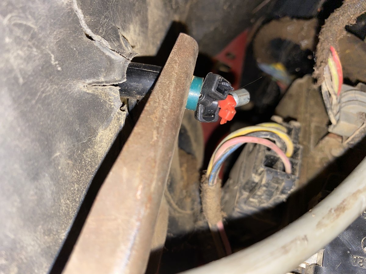

  • I6 300 ROUGH IDLE
On a positive note, all my EEC codes are gone. Except 67 for the neutral safety switch - truck will start without clutch being pushed in.
