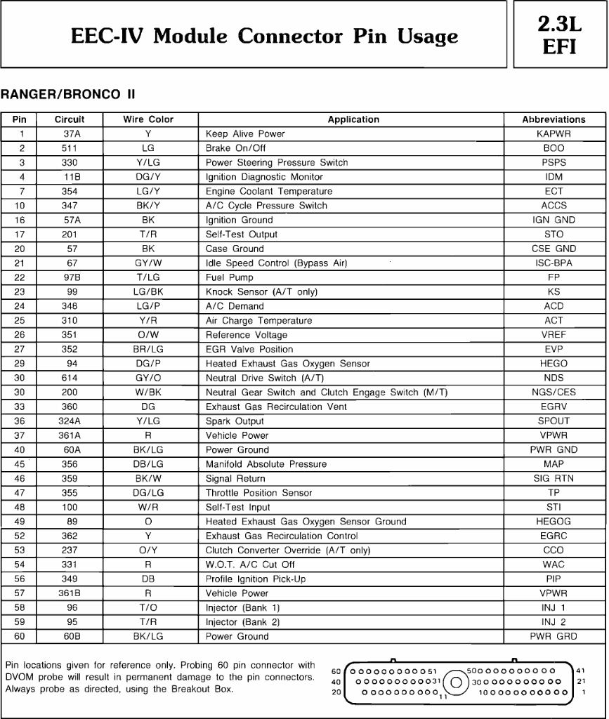

I need wiring pinout with colors for 88 ranger with 4 plug 5 speed
ty112687
Jul 7, 2010
10
1988
like the title says I need a wiring pinout that shows the colors of the wires for an 88 ranger 2.3l 5 speed. Im doing the turbo build up and I pulled some pins I shouldnt have so I need to know where they go back. Thanks
Tyler
i hope it helps, it says "2.3l" but at the same time it says "ranger" and "bronco ii"... but a broncoii never came with a 2.3l :icon_confused:
Just remember to use your breakout box.
