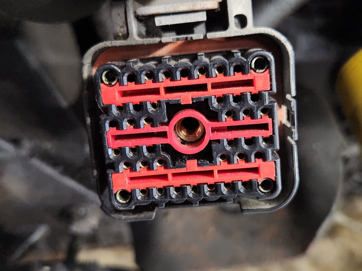

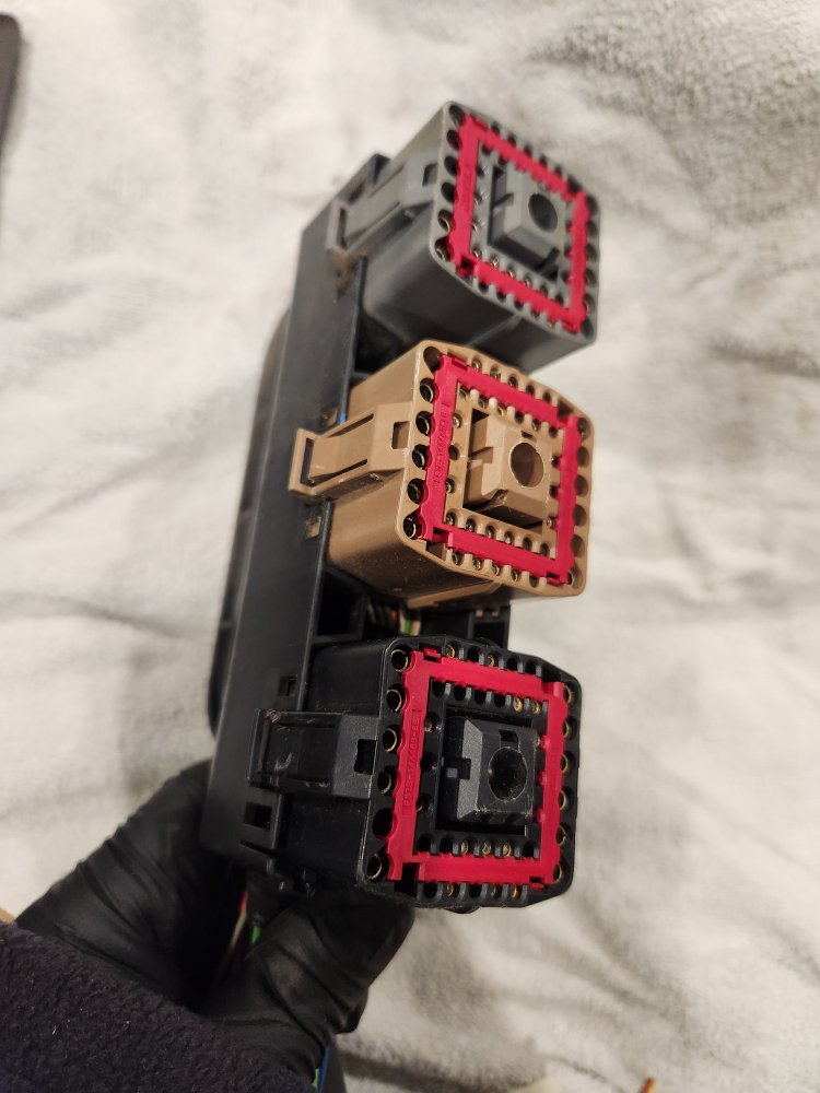

I'm looking for a couple wiring diagrams. One is the connector that connects the engine harness to the power distribution harness. The other is the bulkhead connector at the firewall (the 3 square connectors that pass wiring through the firewall into the cab). I'm probably calling them the wrong thing because google has been useless. Here's pictures of what I'm talking about:
Need a couple 1996 2.3L engine wiring diagrams
Main engine harness
bulkhead connector
That's one for the bookmarks! Thank you for that!

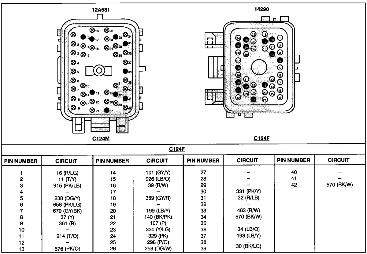

I found this, which is the engine harness connector, but it doesn't have a description of the circuits, just numbers! ARRRRG!
