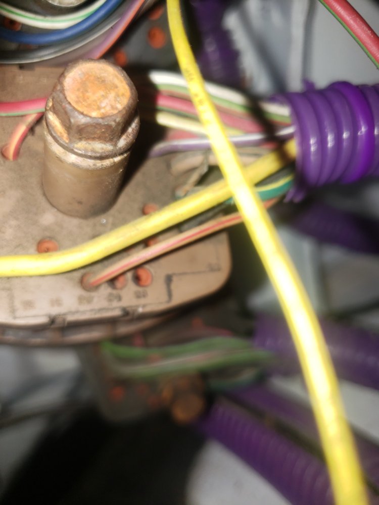

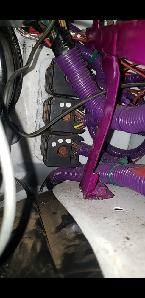

so a few month back i finish my v8 swap 1997 b2300. with a fitech so i ended up taking the whole wiring out and delete quite a lot of wiring to make it prettier, did my best job but truck ended up parked for atleast 4 month havent touched it so kinda forgot where i was with the project and anyway i quickly removed a few more wire then put it all back together and everything going nice and smoothly anyway i came to a point where i wanted a 2010 front end did all the swap and i ran into an issue by mistake i guess i was too much of a hurry to pu it back together i fu***** unpinned and deleted the 2 front turn signal wire and plug.. back then i had a sheet with the diagram but its been lost cant find anything anywhere now to fix my mistake all i would need is to know where to go on which of those 3 plug so i can hook them back please and thank you to anyone who could help

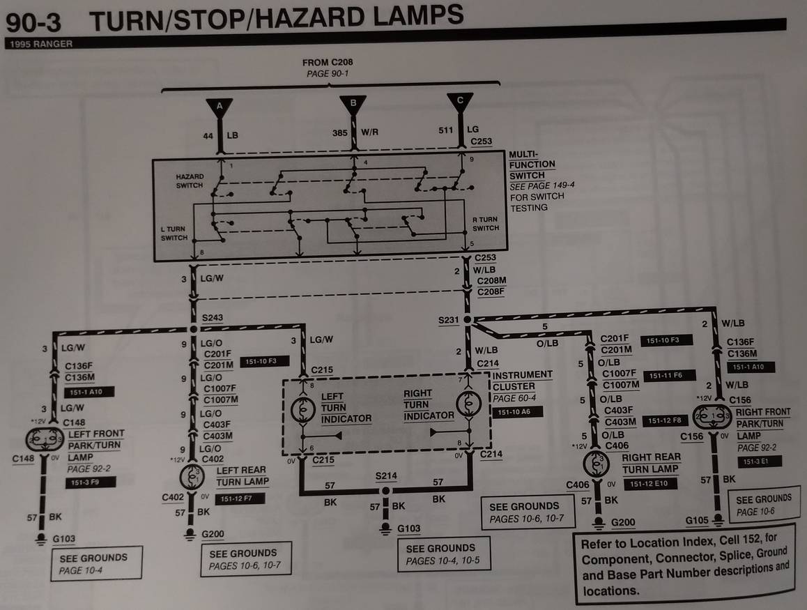

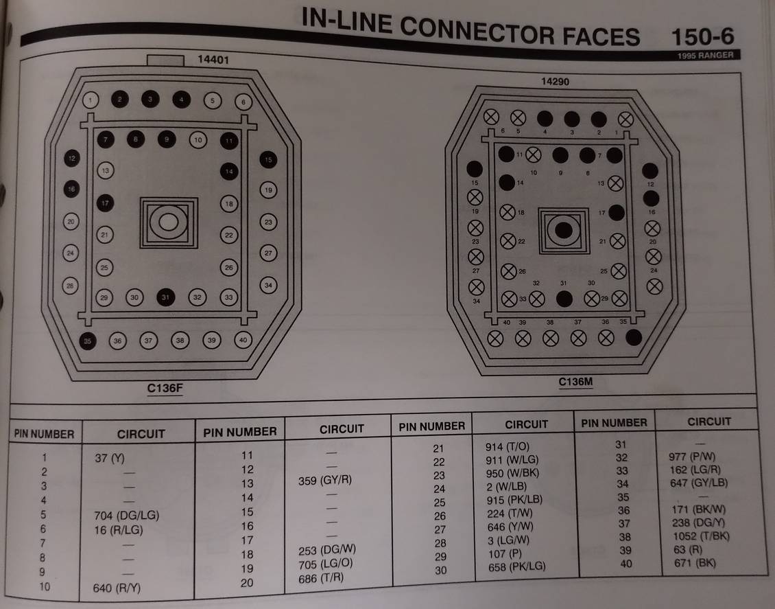

In a '95, Left Front is C136 pin 28 LG/W, and Right Front is pin 24 W/LB. The square connectors are 134-6, so I would assume 136 is on the bottom, but I don't have the truck, just the EVTM. I know '95 also has some weirdness sometimes, so double-check your wire colors on the other side of the plug.

okay so im gonna guess the 136 is the middle one cause i unbolt them all and the only connecter with holes for pin 24 and 28 is the brown one if 95 is the same as 97 i guess im gonna try and see if it work thanks
