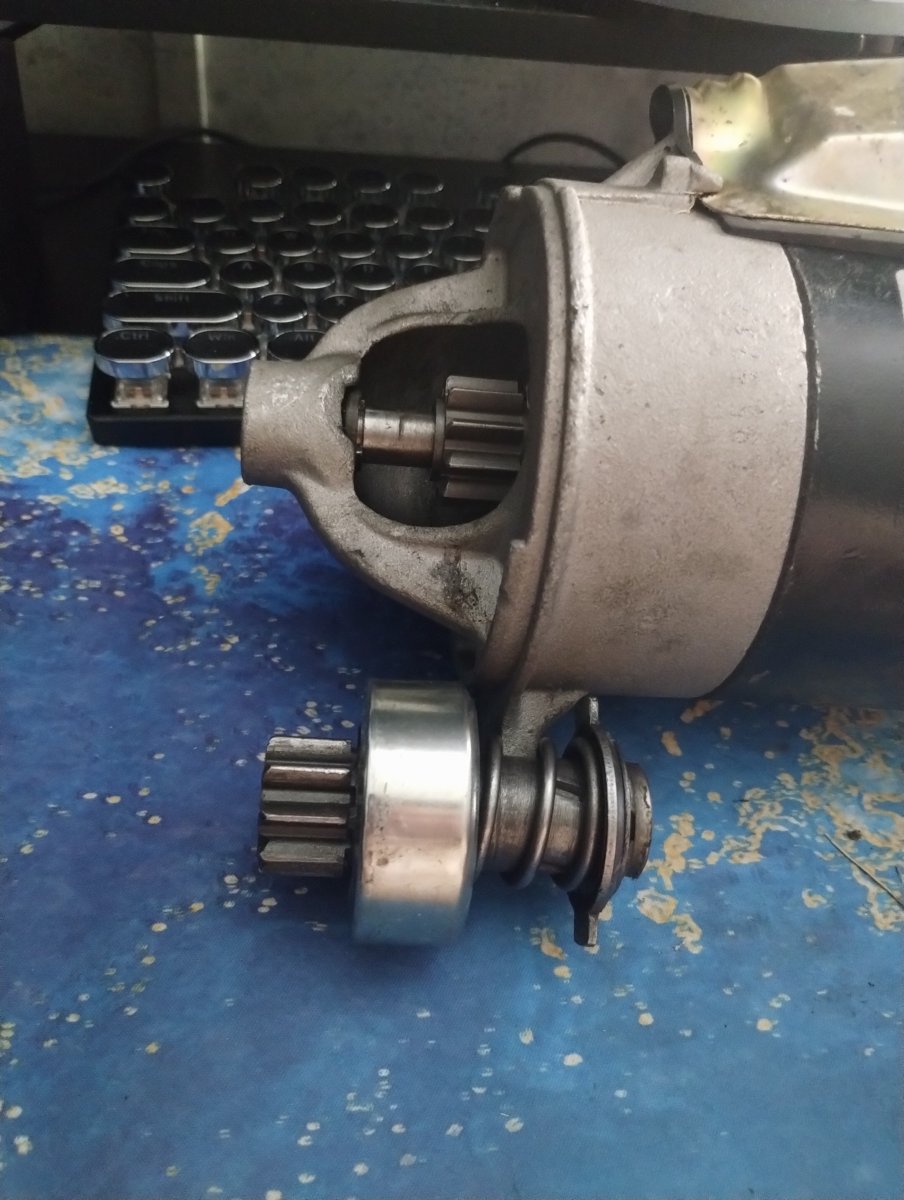

I replaced the drive in the aftermarket starter since it was basically brand new 4 years ago and still starts and rolls over besides the grinding and non engagement put a 1986 escort drive in it with 11 Teeth not to downplay the whole 4.0 starter but I tried that already 4 years ago it took all of 15 starts for the gear tooth to shatter on it. If I have a picture of it I'll put it to this thread.
Here's that starter from 4 years ago. After this incident I swapped out the bellhousing and starter bolts and starter.
Also while I was underneath my bronco yesterday I found I could put the bolts in without taking loose the transmission again so when the weather breaks in va and I have some time off I'll be under it fixing the pressure plate and all
