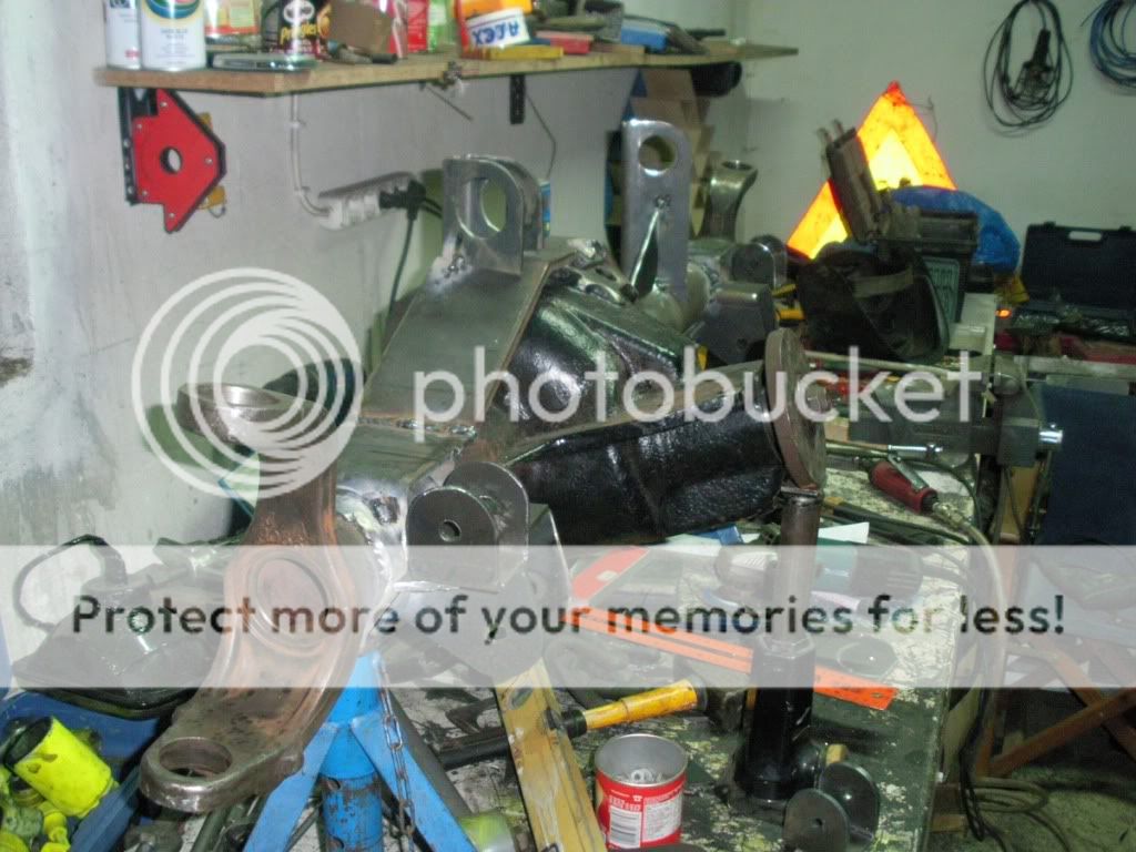

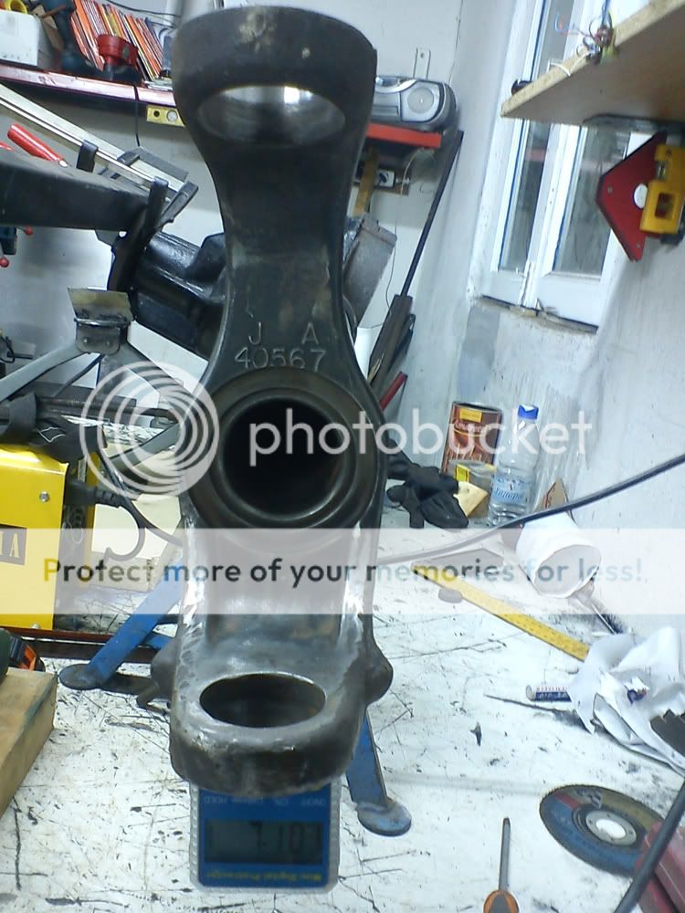

small progress today at night.
toooo much work in the office and only a couple of hours late at night to work with the axle.

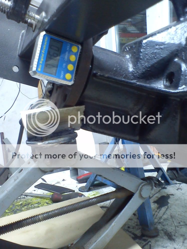

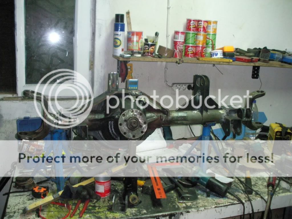

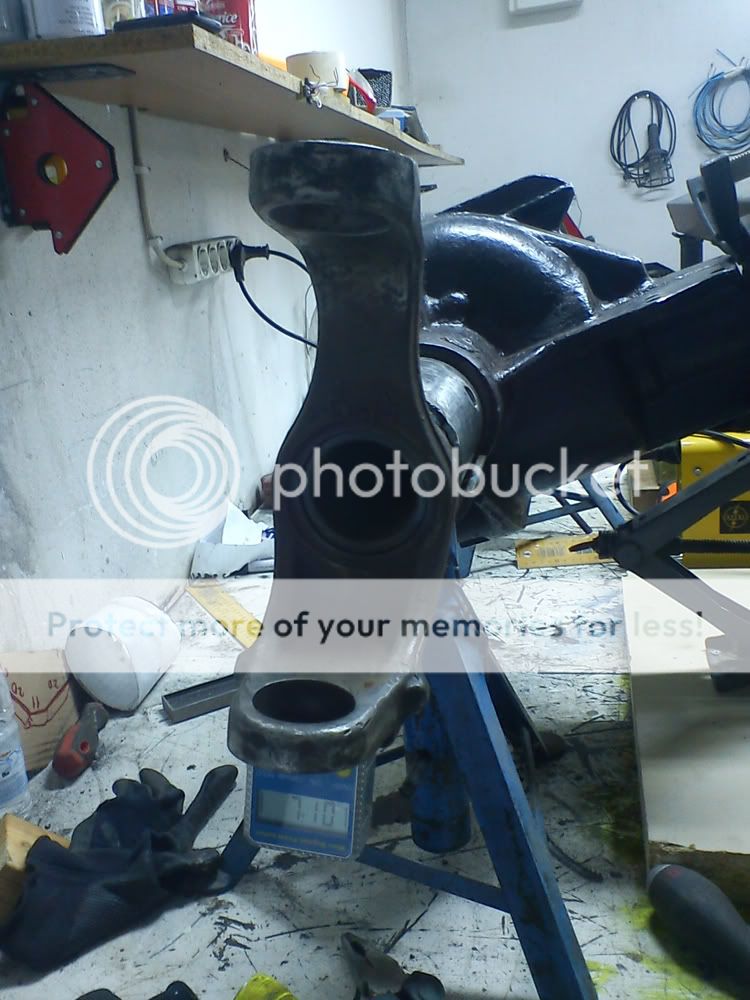

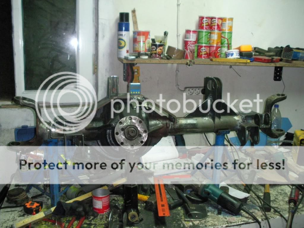

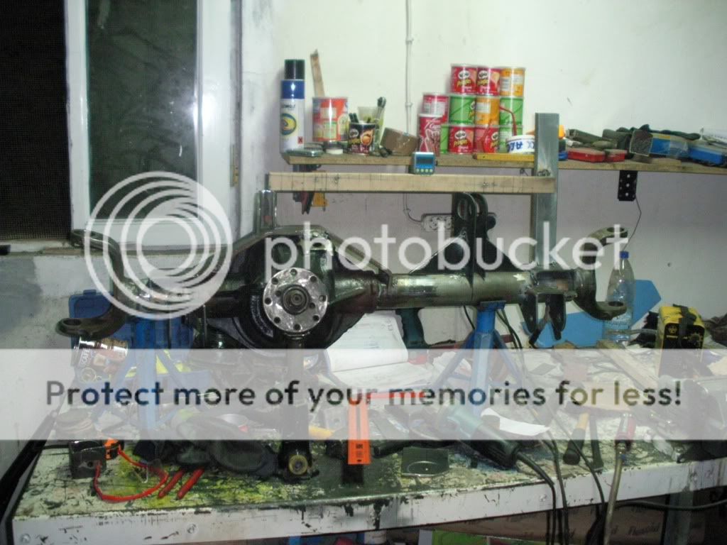

so, today, pinion angle measurements and caster ready to go for welding.
a couple of photos

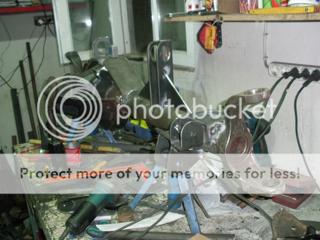

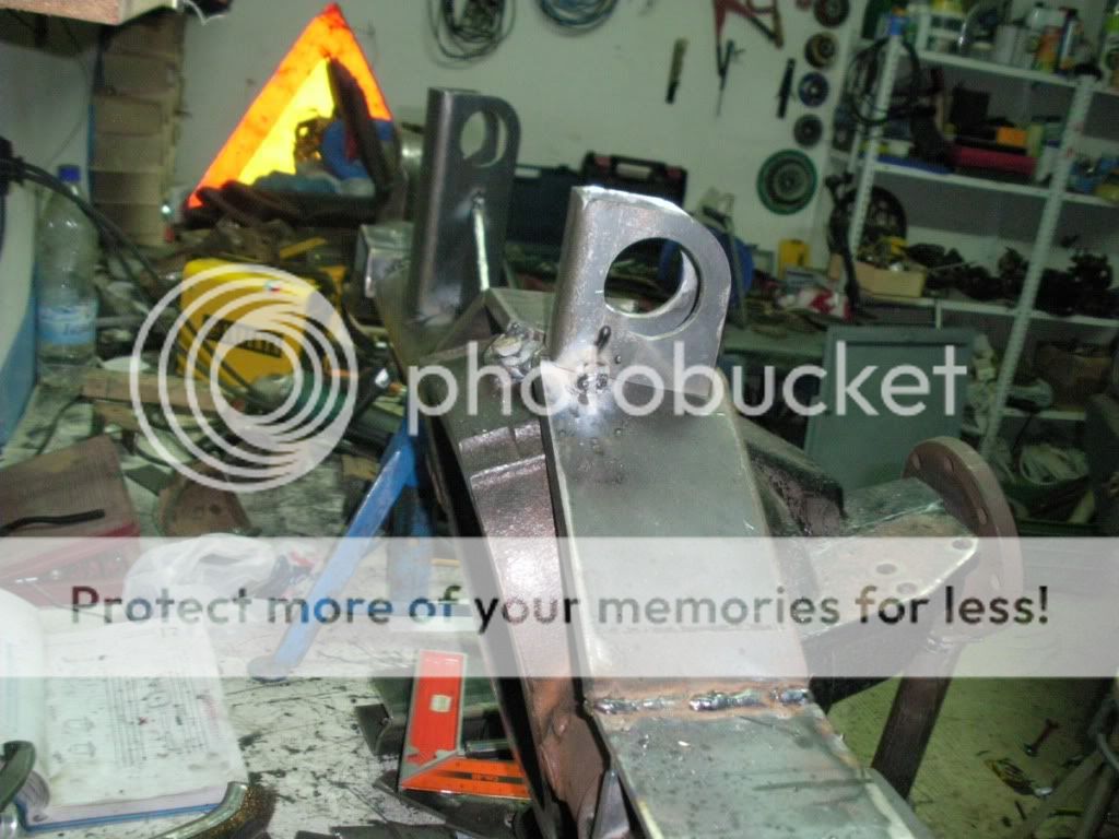

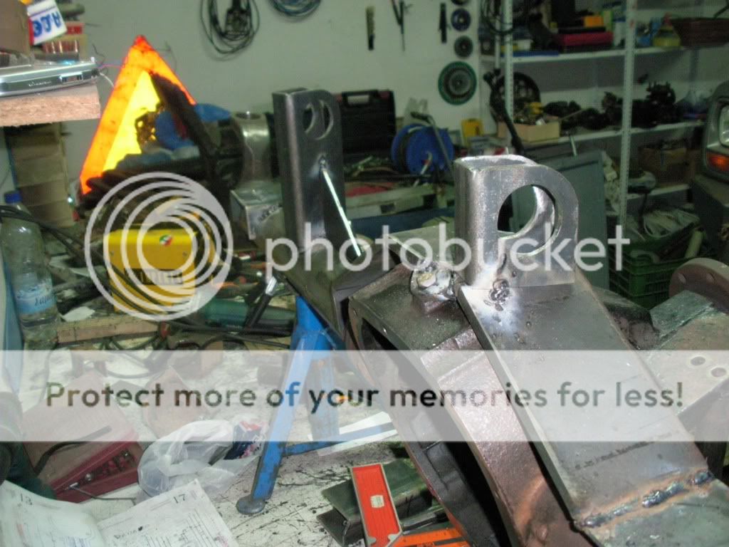

ready to weld suspension brackets

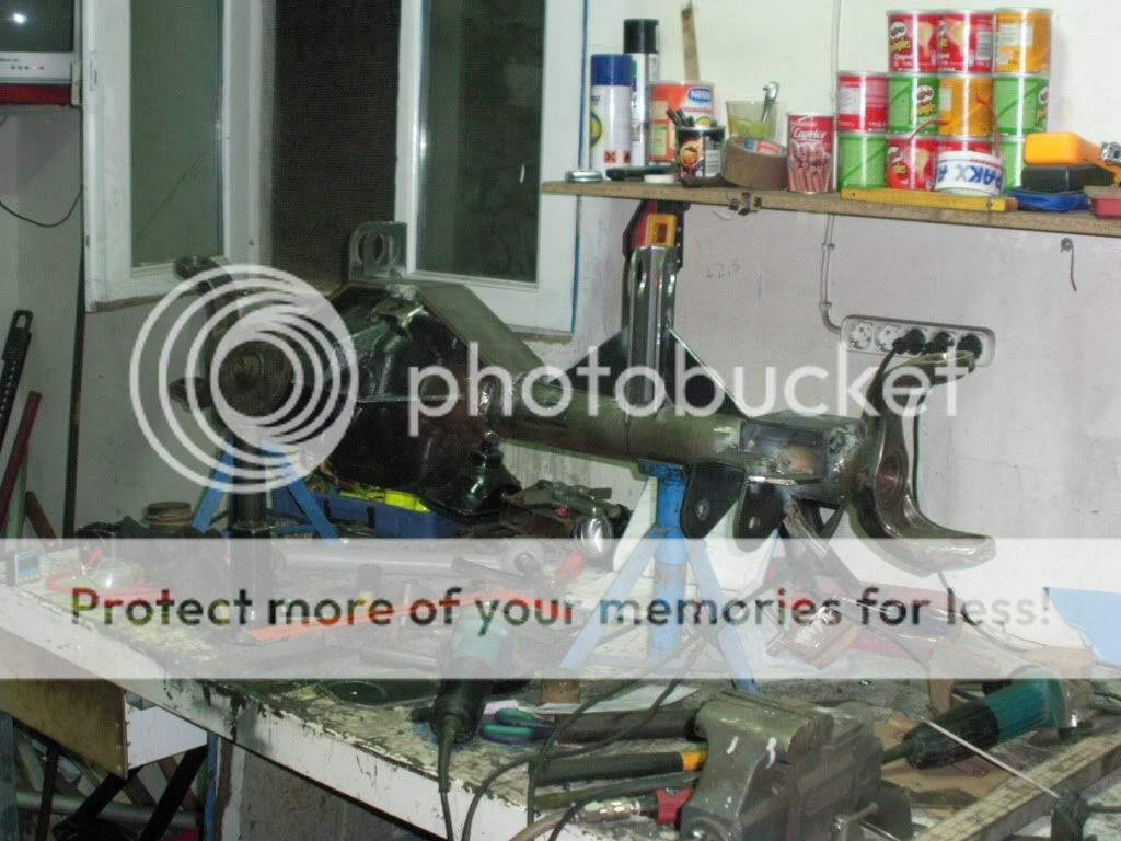

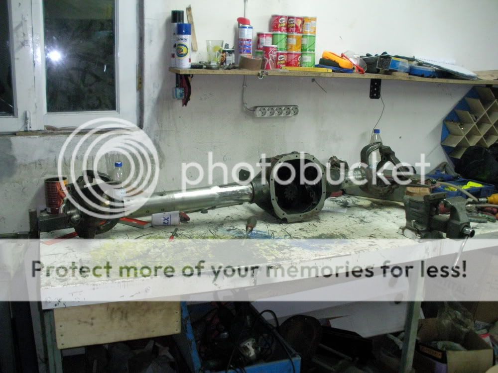

the tubes welded with the housing today

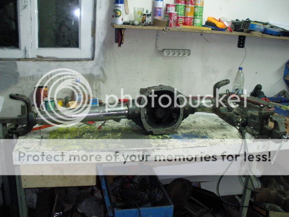

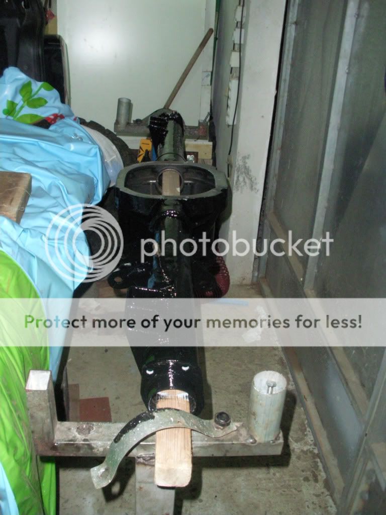

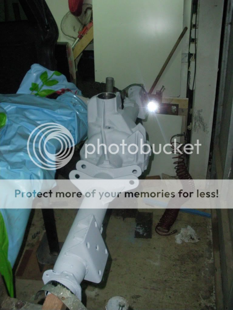

and a couple of inside pictures
hybrid front axle Ford8.8/Dana30

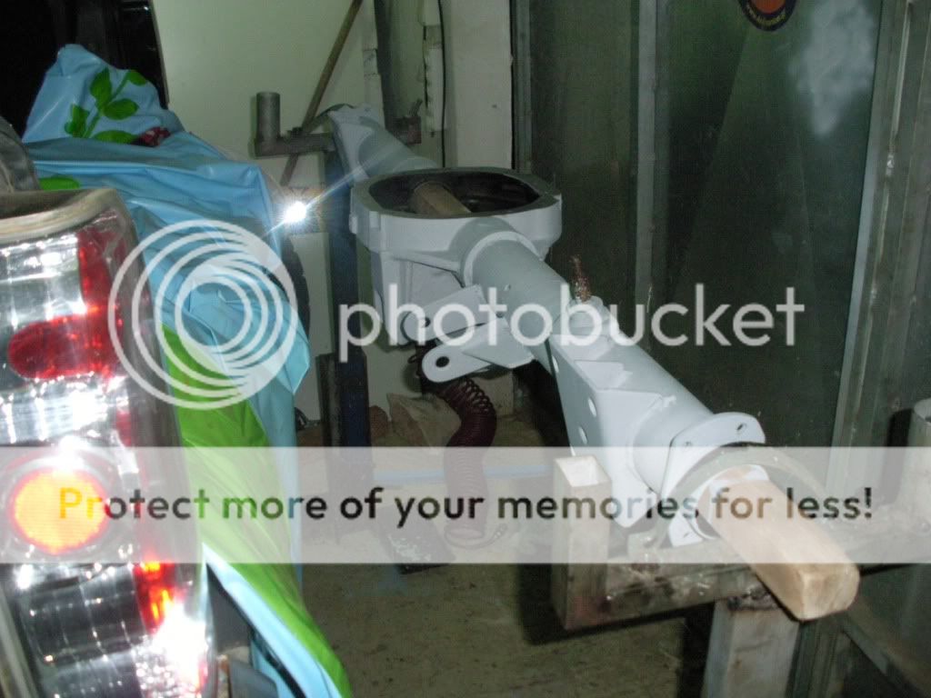

tomorrow i hope i will finish all the suspension bracket welding and paint the axles so i can move on to do the whole assembly.

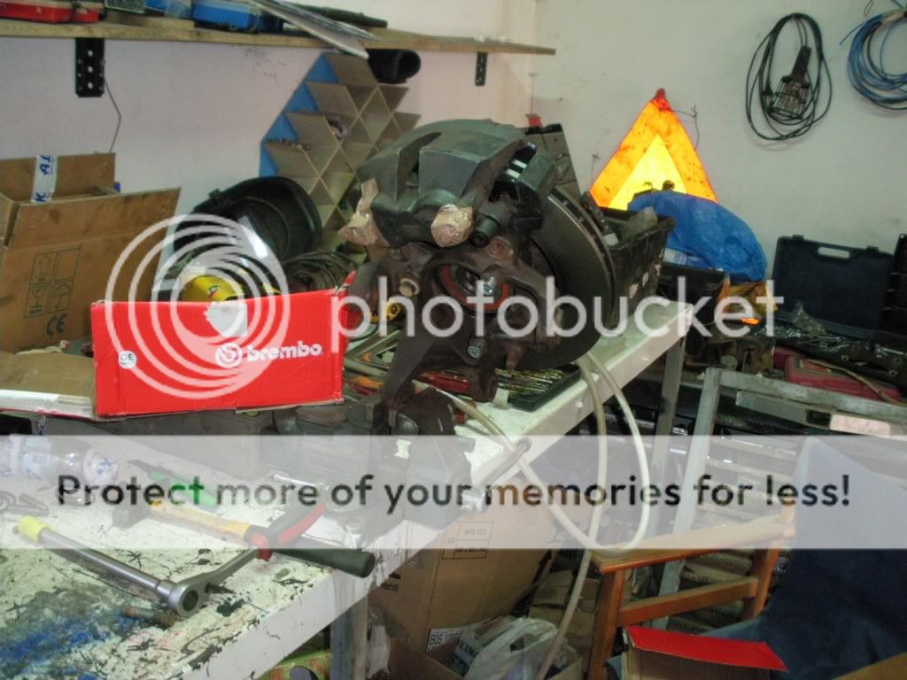

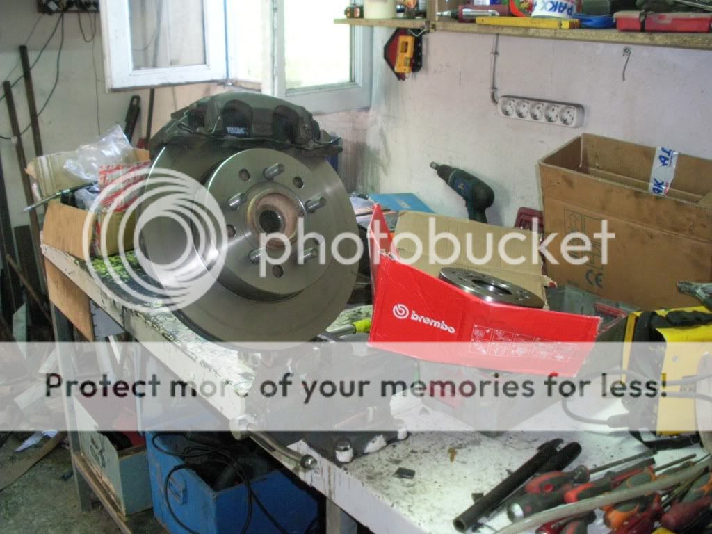

brembo brakes and ferodo pads from local shop.
i had to drill the discs in 5-4,5 because grand cherokee WJ is 5-5.
evrything seems to fit just fine.
