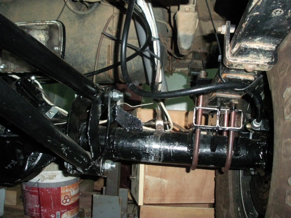

I don't know much about linked fronts [or rears] but it looks like your upper links are triangulated to the lower links. Wouldn't that mean you don't need a track bar?
Did you cycle the suspension and when you did, was there binding between the track bar and the other links? I'm thinking that the angled top link will be fighting against the track bar as you cycle the suspension.
What size are the bolts holding your links on both frame and axle?

i dont know the sizes of the bolts but i can measure them if you want. the suspension is a rubicon express i bought in 2008.
my suspension mounts are exactly the same as the jeep had with the dana 30.
the upper links are not triangulated too much to eliminate the existance of the track bar. (i hope you understand my english :D)
"I'm thinking that the angled top link will be fighting against the track bar as you cycle the suspension."
and there is the big thing in the whole "track bar mount fitting"
the track bar has to be in the right possition to not "fight" against the suspension, and it has to be long enough not to "fight" against the steering. plus, it has to be in the same angle with the upper steering bar.
Its a good geometry issue.
and because of my work, i'm good in geometry:D:D:D:D

Box them. They will catch rocks and bend off. It doesn't matter that they are thicker than stock...It's just the lowers I see a major issue with. Other than that looks good. Are you planning on sticking to the stock size 297x ujoints or bumping up? and are you keeping stock outers while moving to a 31 spline inner shaft?
As for the links you are fine they are setup like my Ford minus mine being mid arms and exactly like my XJ's front.
i had this in mind from the beginning but i firstly wanted to see where and how all the links will sit. in he future i will beef them up.
in the past, my links on the dana30 bended because they were not boxed, just as you said. on my new axle i tend not to have similar issues

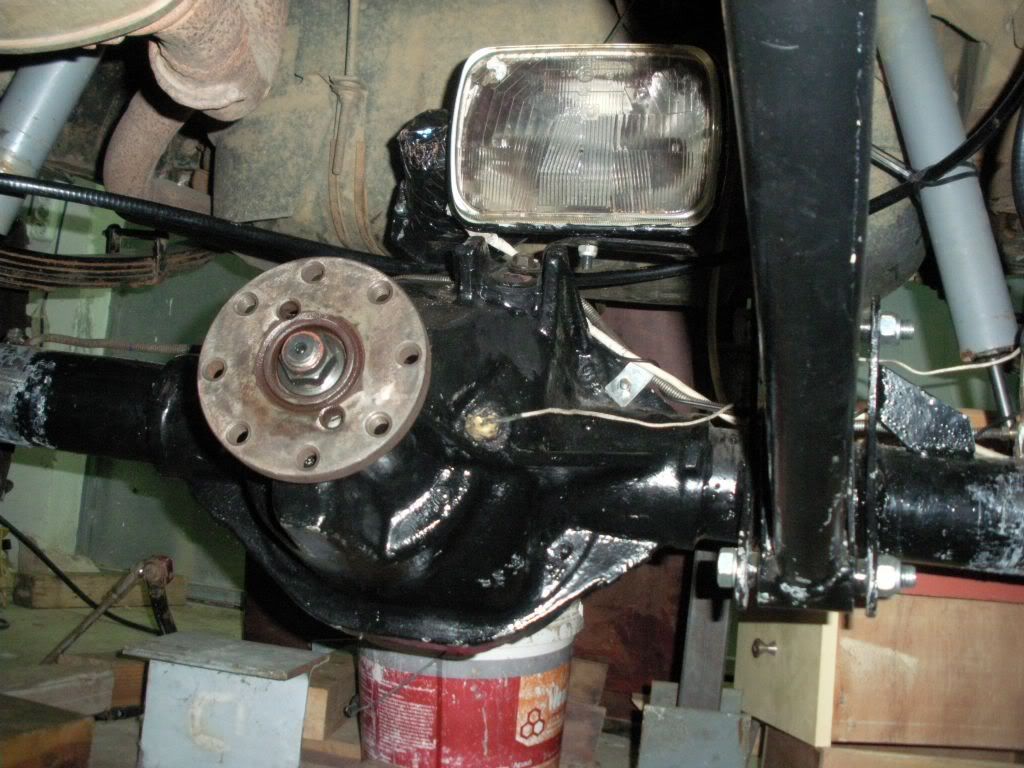

i shaved a bit the 4,88 ring to put on the pin
hybrid front axle Ford8.8/Dana30
i measured the backlash with my micrometer and is 0,033mm. about 0,013inch. the Nitro manual says "backlash 11 to 16, so I'm ok. The final settings for the ring pinion took some time. i had to change pinion shims 3 times. the final marks seem good. I could set it much better but the local shops dont have shims in variety for the pinion. only 0.2mm, 0.4mm 0.5mm and 1mm.:annoyed:
i had to use the 0.4mm but the best setting would be with a 0.3mm.
anyway... the marks seem good.

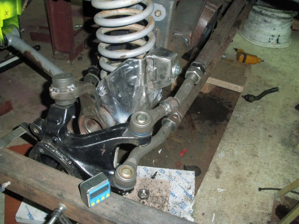

track bar angle 10.6 degrees
steering bar (i think you call it draglink?) angle 11.9 degrees
trackbar length 81cm.
streering bar length 91cm.
I think I eliminated the bumpsteer and death wooble

this is a "tool" i made to open the new holes for my streering now that the tie rod ends are upsidedown.
it was an old tie rod end modified into a drill

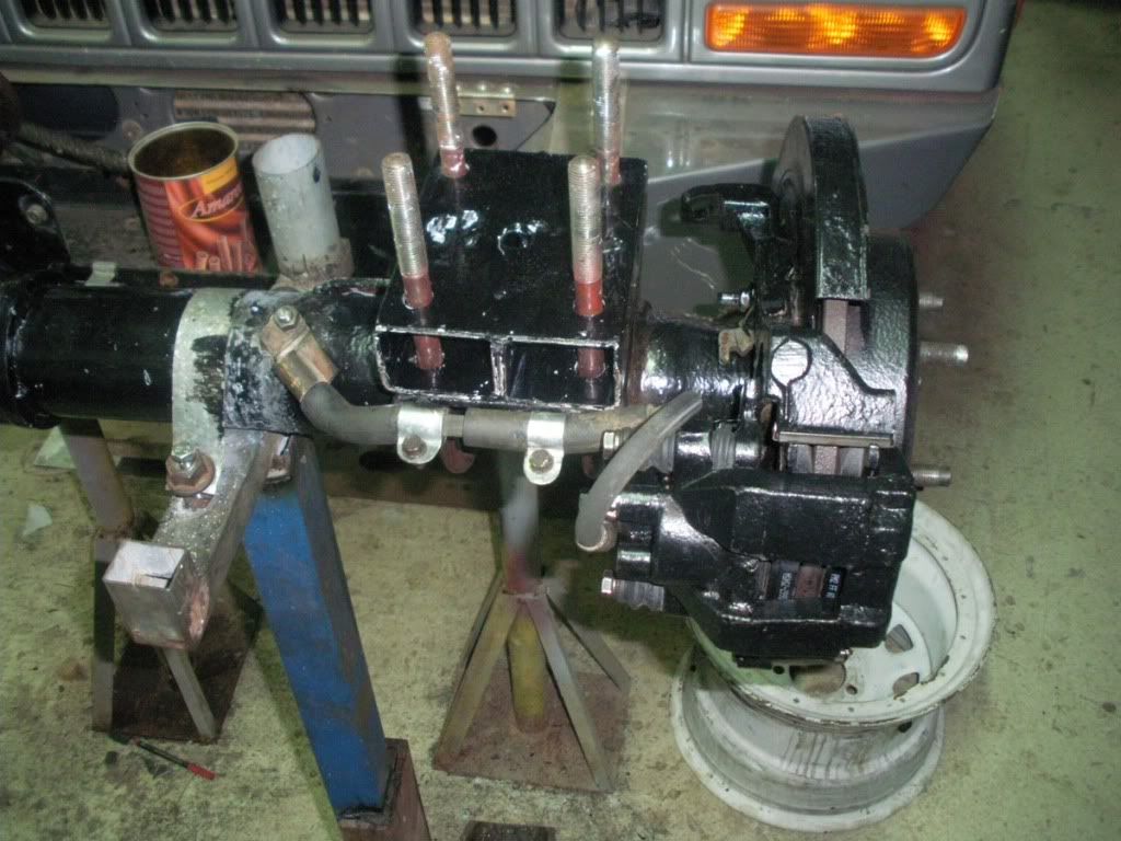

Other than the rear blocks everything looks good.
Its either me or your steering linkage is really close to the diff. in the front, and thats with the wheels pointing straight too.
Thats my only worry so far.
it is close but I checkted with the diff cover on and there is no problem. about 2" space from the bar to the diff cover. If i hit a rock, i hope i will brake the rock:D or the bar will tuch the cover:D
Looks like he running traction bars anyways so having the blocks isnt going to hurt a thing when it comes to axle wrap.
I think he was saying that they look flimsy and may get crushed or break on you due to them not being solid blocks.
"the rear blocks" ?
what about them?
I needed the high. and I'm going to weld them in some points to be sure everything stay in place.
any advise for me?:icon_confused:
Thin hunks of square tubing. That's my complaint.
