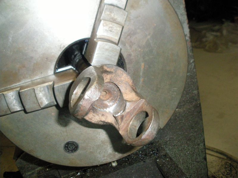

My second problem is my axleshafts.
No money, no RCV and keep on breaking u-joints and destroy yokes.
and here are some photos of my latest breakage :icon_hornsup:
and here we are fitting a new yoke.
TIG welded always :D
I just have a feeling that this yoke will not hold on for a long time.:D
