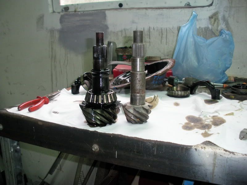

my main problem in the D30 & D35 was the small crown pinion and the week axleshafts in front. i never broke a chromoly shaft in D35. only crown pinions.
Now with the F8.8 i will have a big crown pinion and two unbreakable shafts in the rear. Same thing in front with the RCV Performance (i hope).
thats why i ended up on this solution. And it came up cheep until now. 750euros for the two axles.
and hope to buy axleshafts and crown-pinions from U.S. avoiding customs.

going from dana35 to f8.8 is an upgrade for me. dont forget that i only have a 2.5 turbodiesel with 116 hp. my problem is the weight of the car, not his horspower. i have the torque i need to play around and do my offroad picknic:D
going from a dana35 7.8" crown to an 8.8" is an improvment
going from a dana30 7.something crown to an 8.8" even in reverse is an improvment.
about dana60, there is no such thing as a dana60 rear axle. only GM14
even and narrowing a dana60 how much weight can i loose? only some pounds.
for my 35" tires i think that ford8.8 will hold up just fine.
you can see the difference between what i had and what i will have:D
