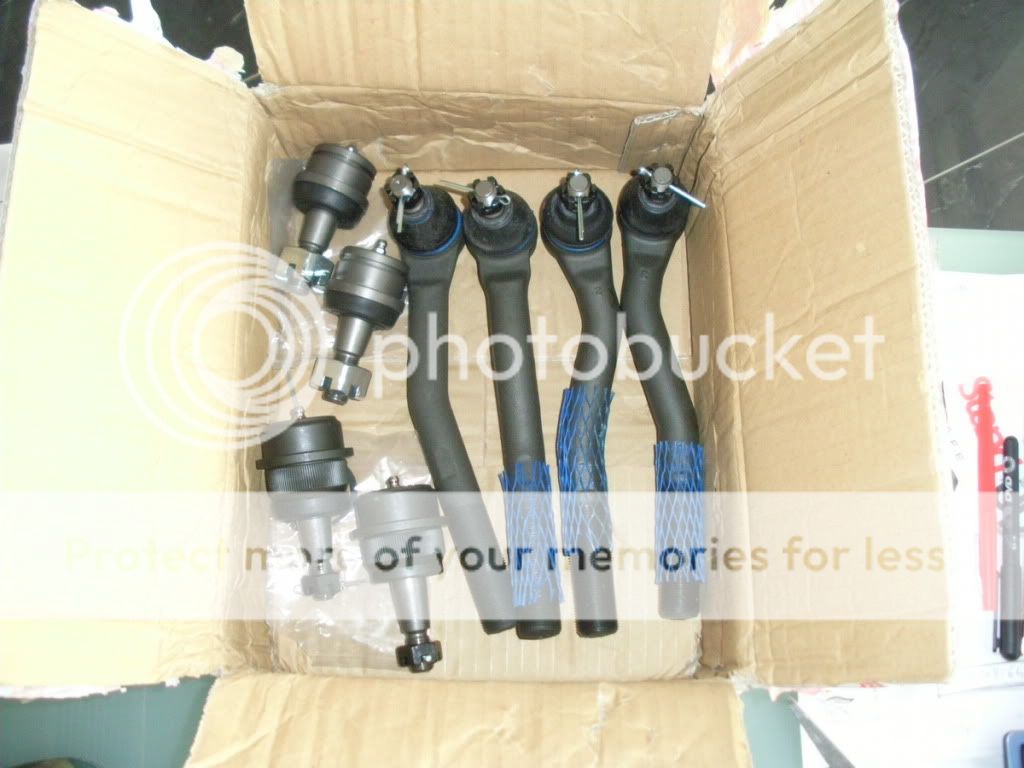

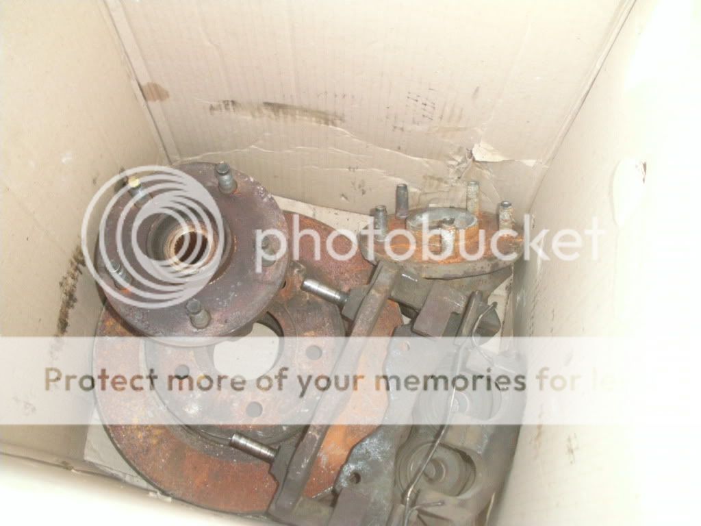

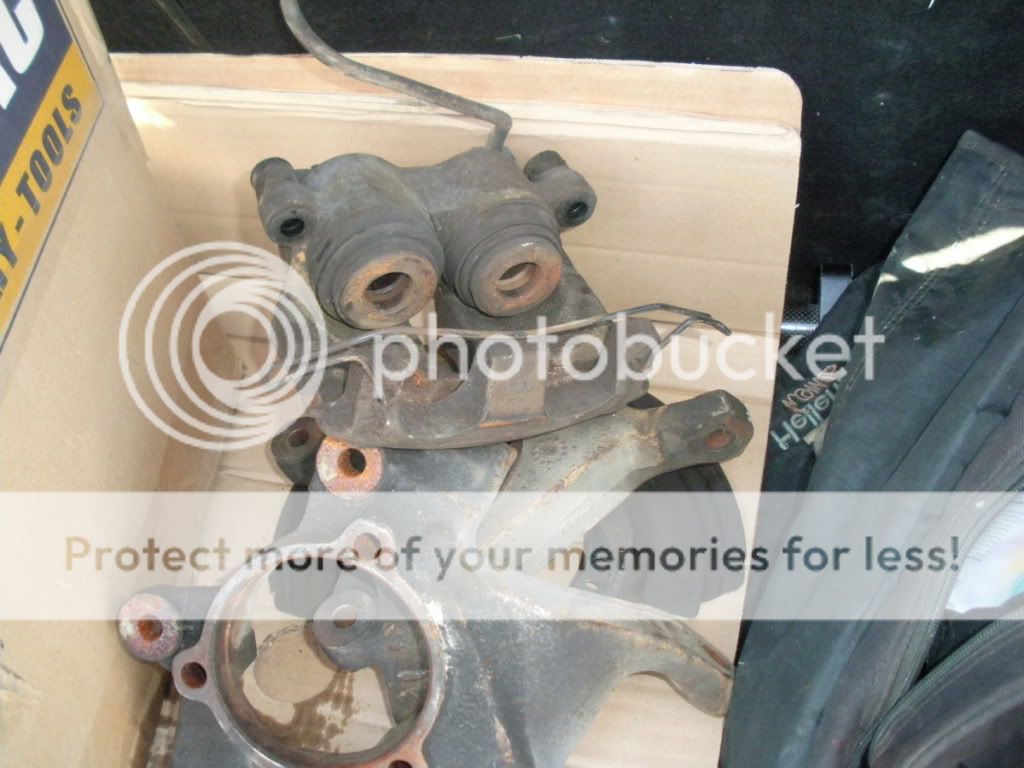

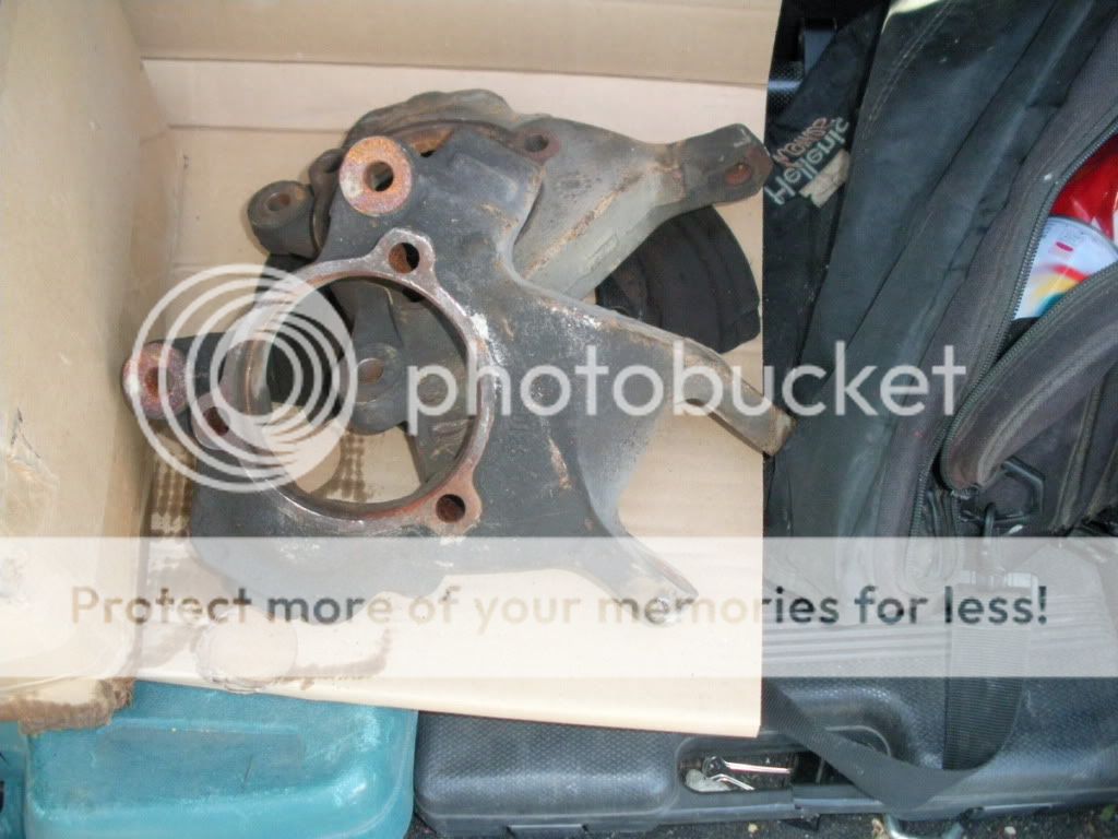

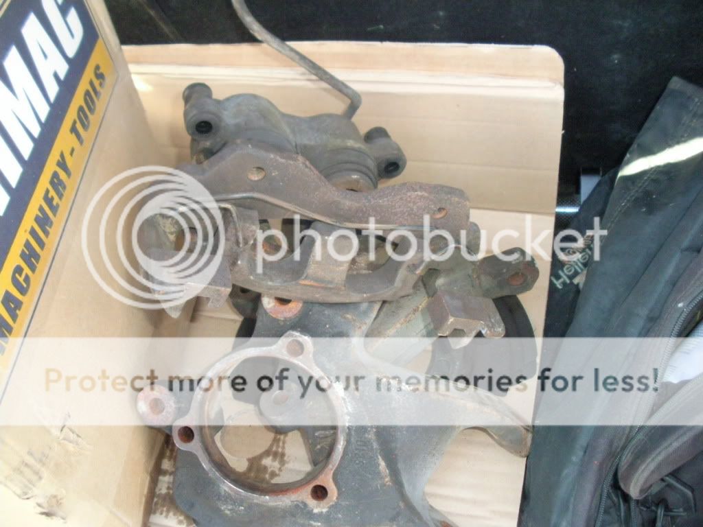

parts arrival today.
from grand cherokee WJ front dana 30.
knuckles
double piston calipers
big 30mm disk brakes

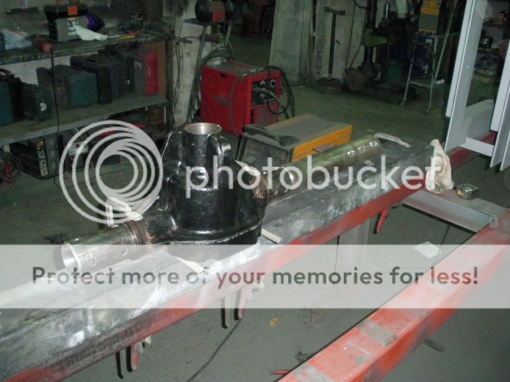

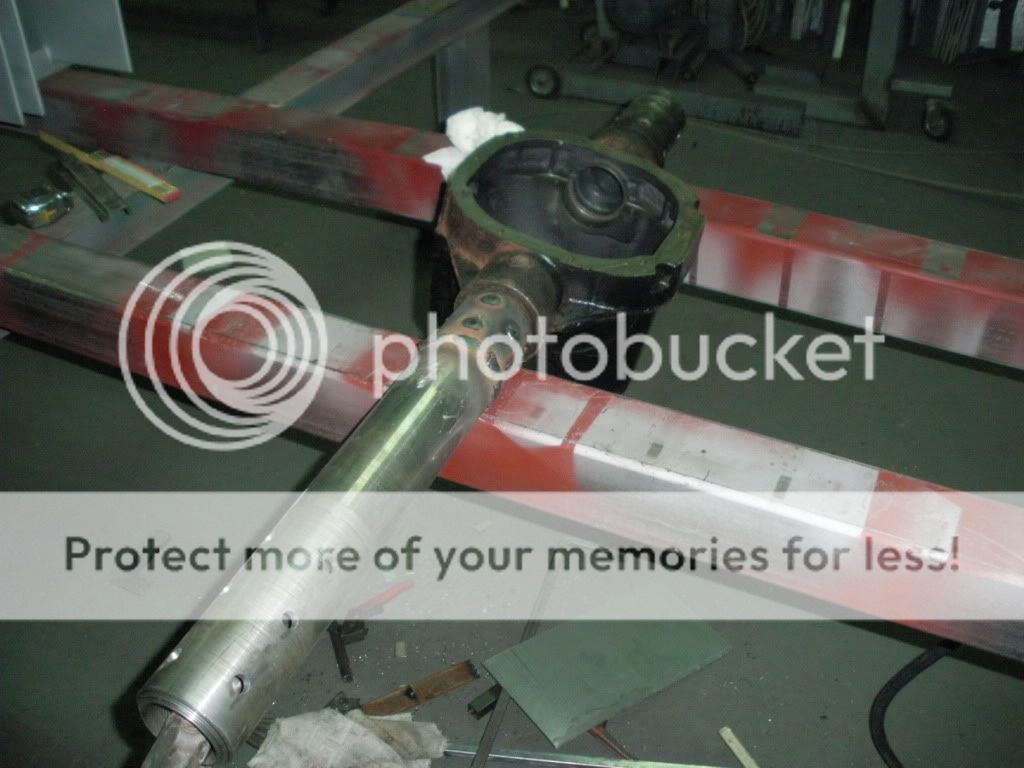

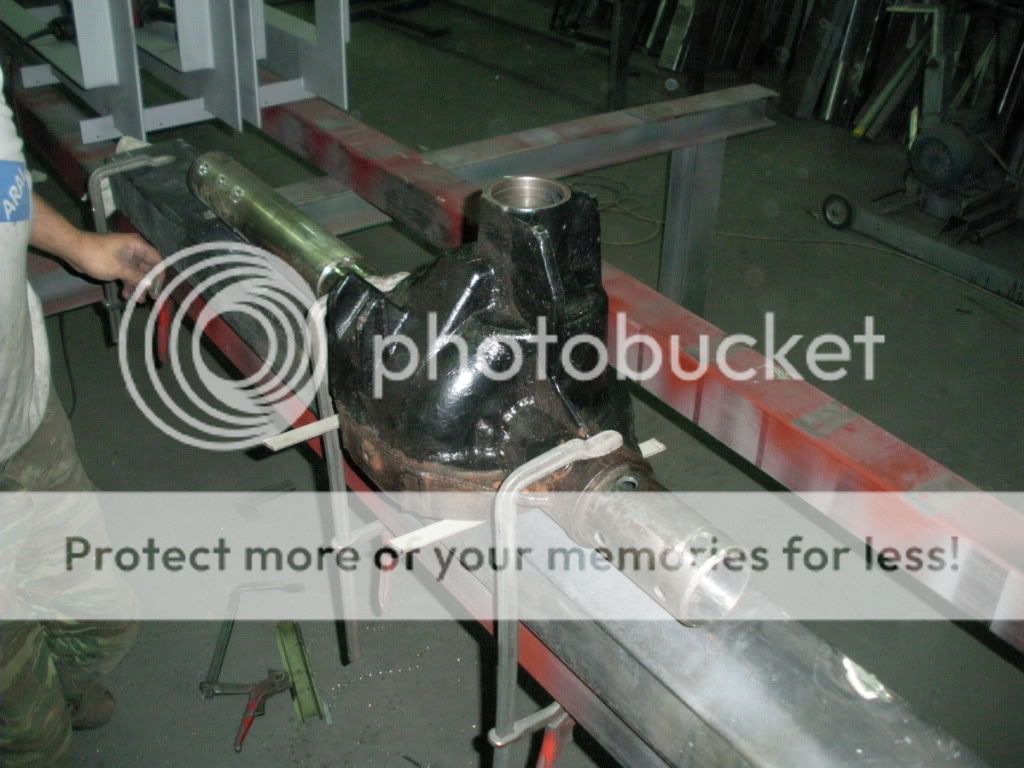

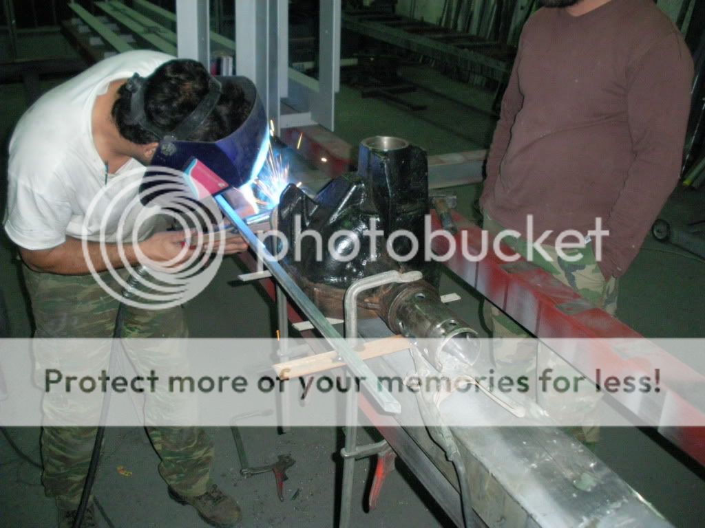

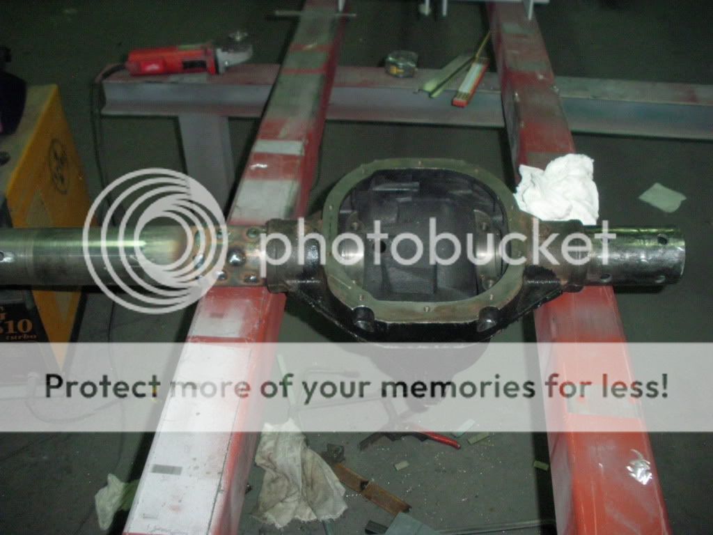

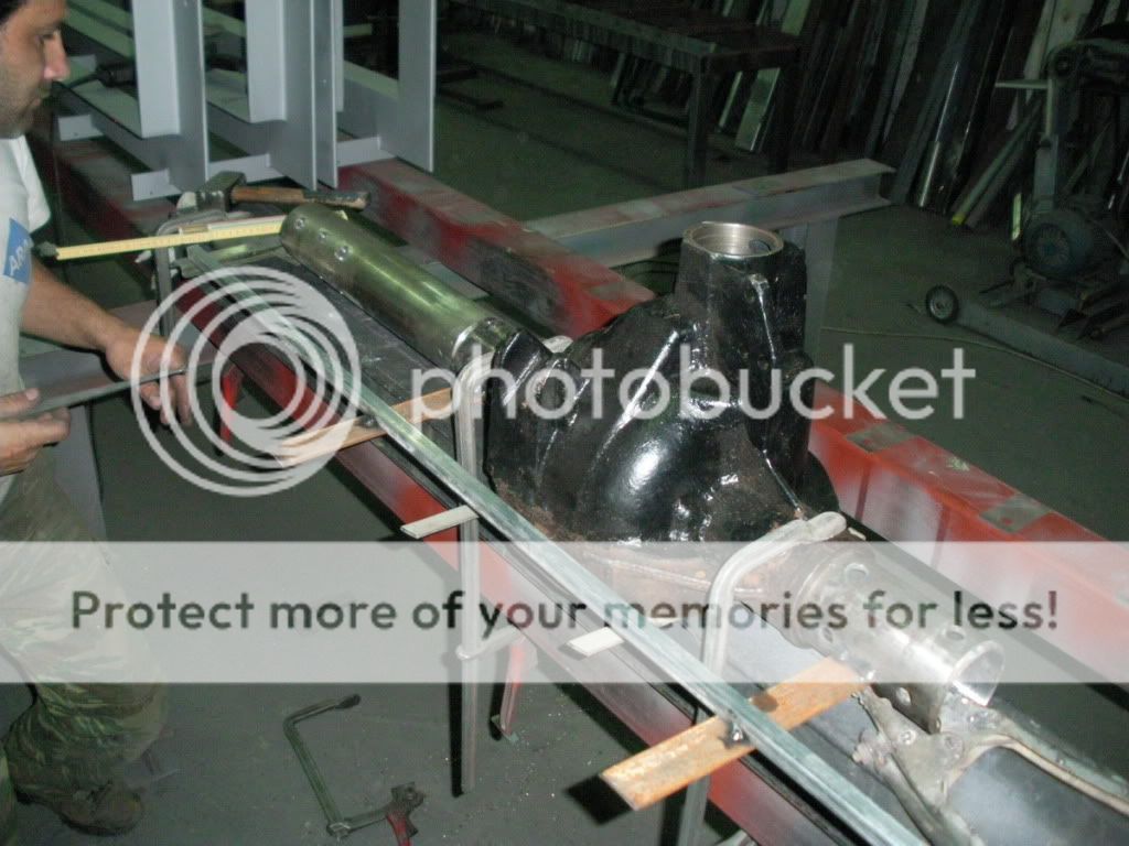

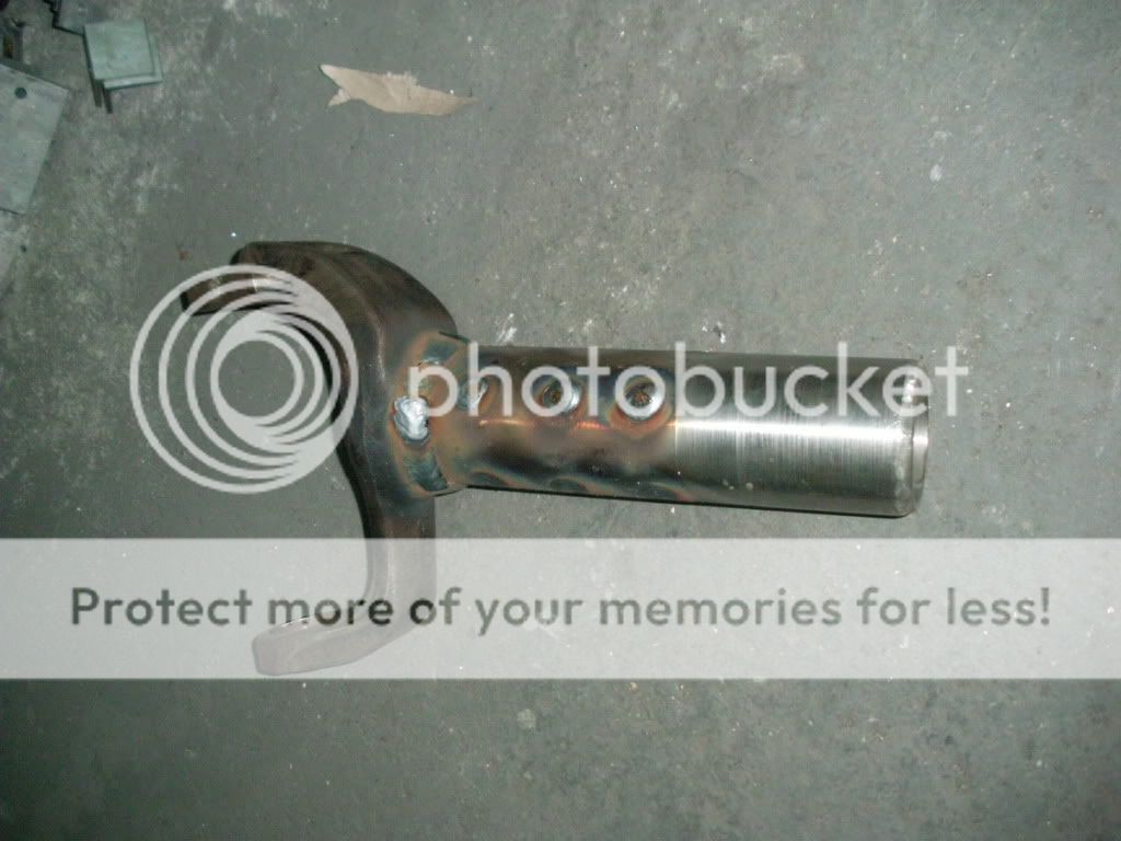

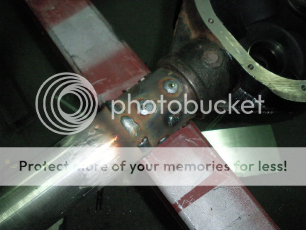

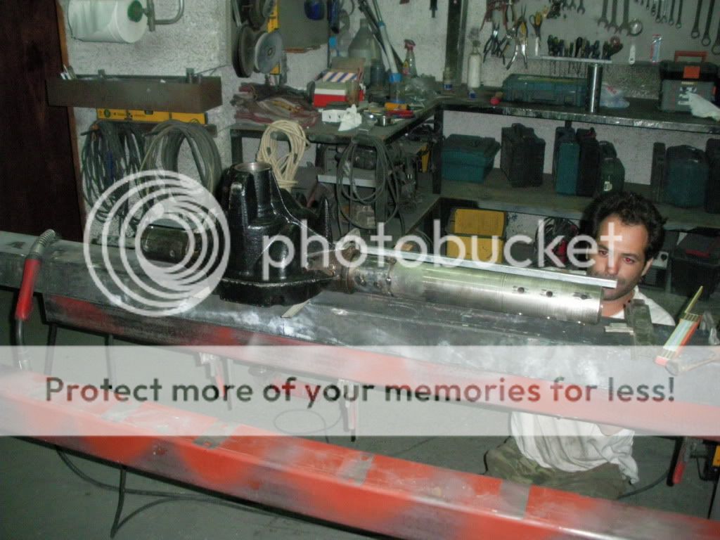

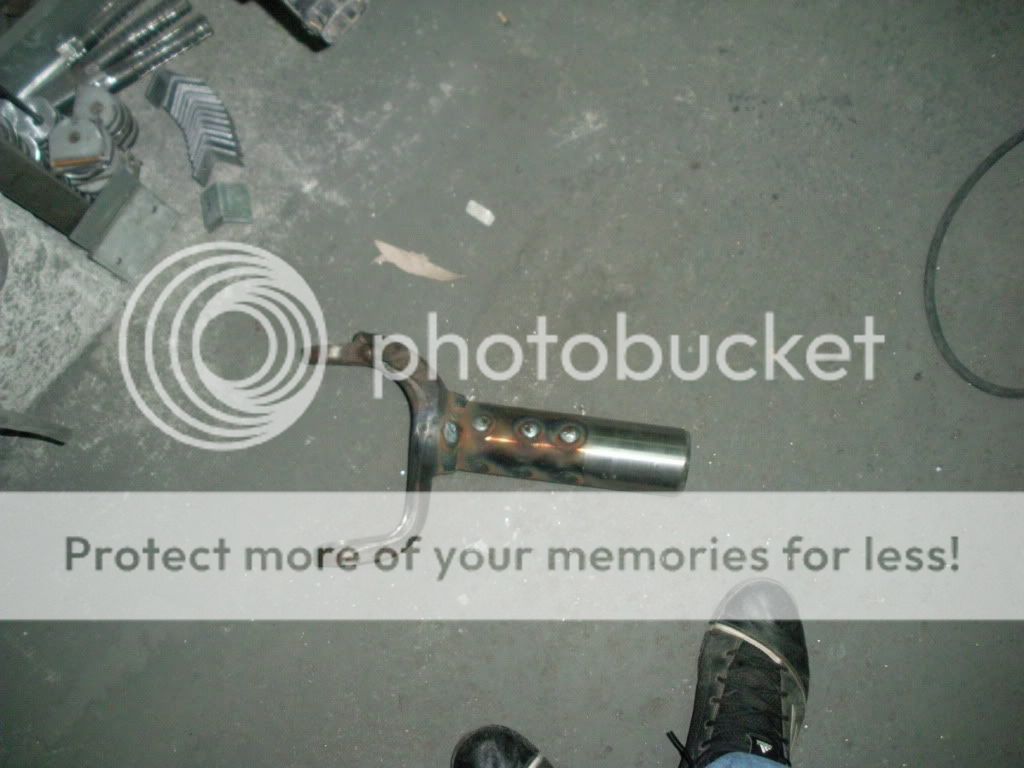

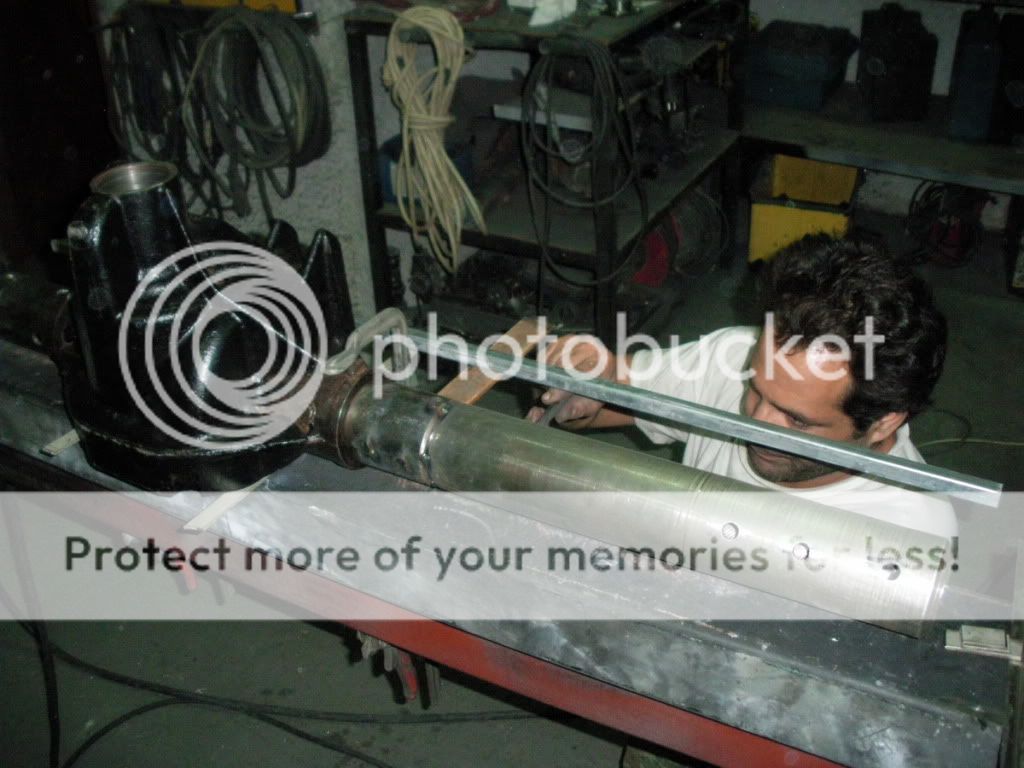

the first welding from a friend in his shop
more welding and measuring in the next days.
