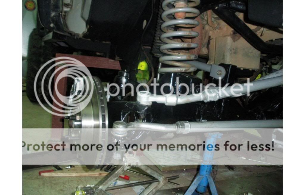

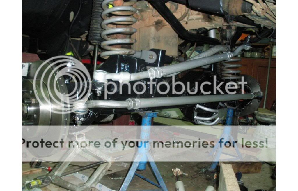

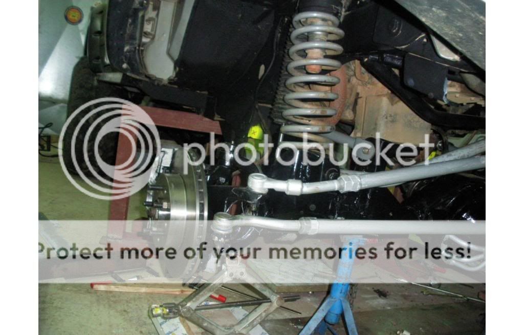

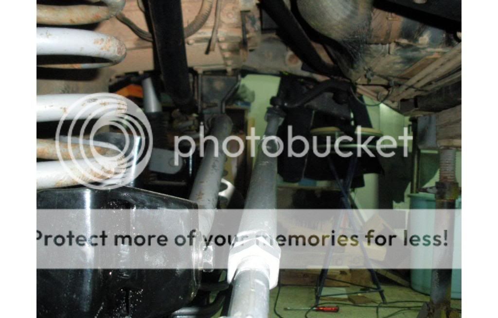

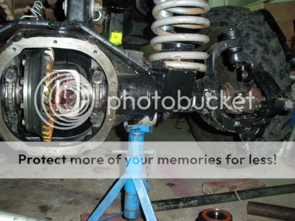

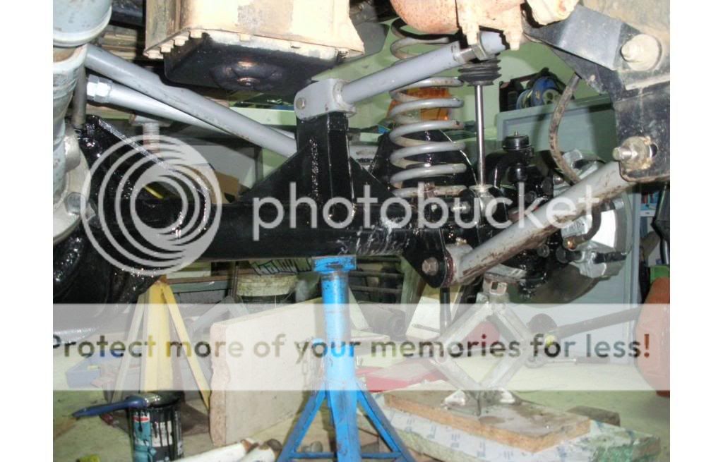

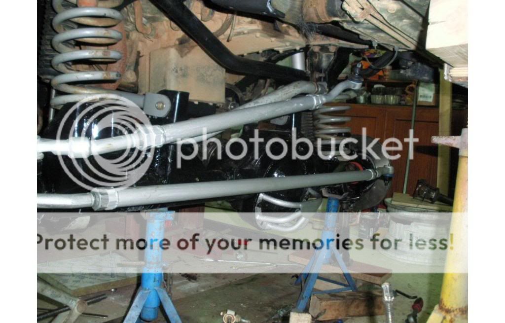

Thin hunks of square tubing. That's my complaint.
oh!!
ok.

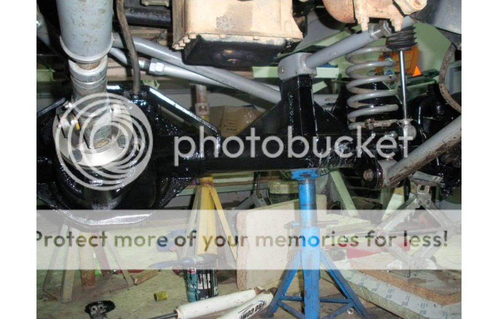

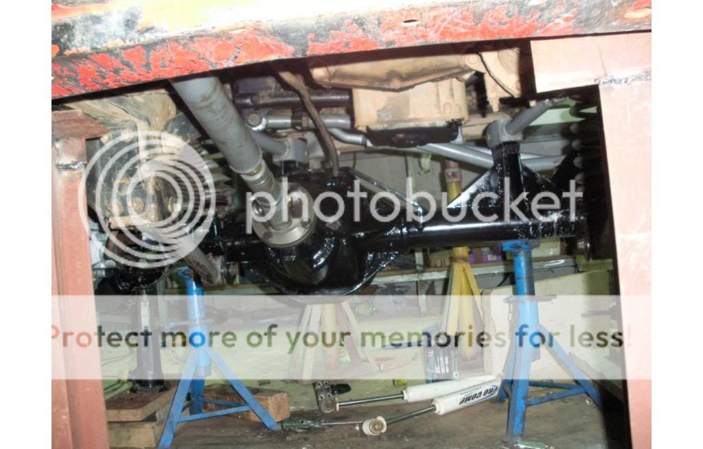

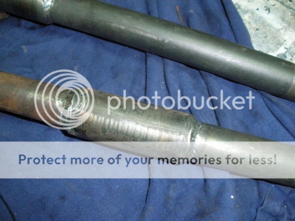

you may be right about it. It is a 3mm square tube and in the middle where the springs sit is 6mm. I hope they will hold. If they don't I'll make the same thing with 5mm. no problem.
There's only one thing that worries mε today.
My problem is that when i was making the axle tubes on the lathe i went to the local shop το see what diameter of seals they have for my axle shafts so i can make my tubes in the same inner diameter. They told me that they have seals which are inner 33mm to 35mm (thats my shaft) and 60mm outer diameter. So I did my axle tube 60mm inner.

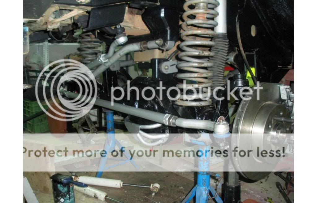

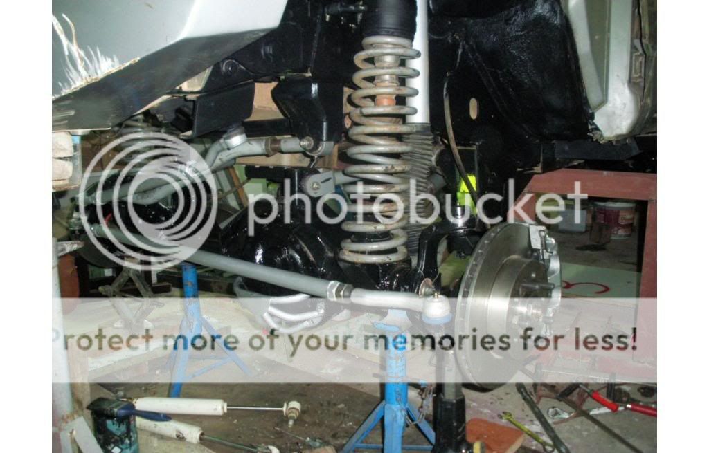

need some work with the steering shock absorber

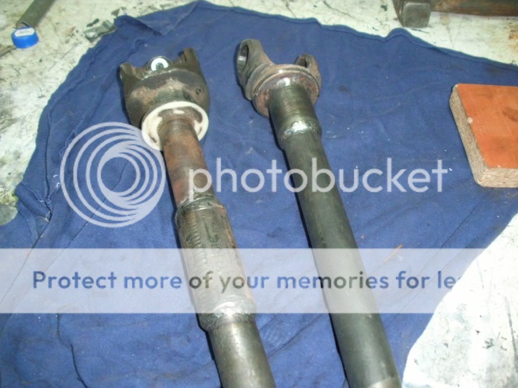

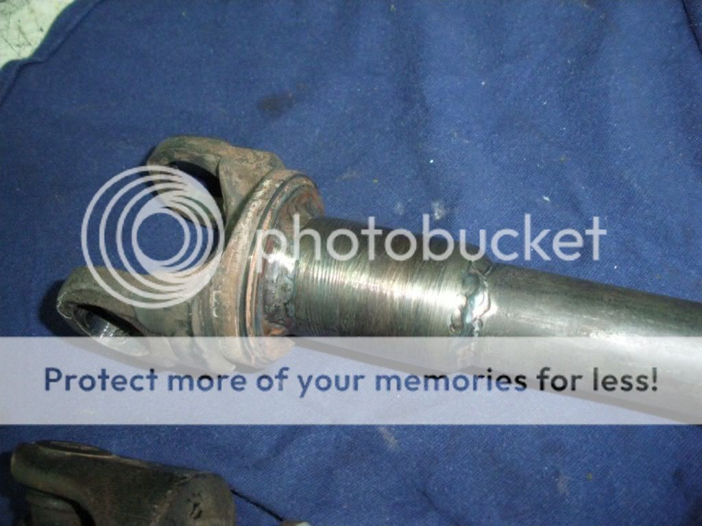

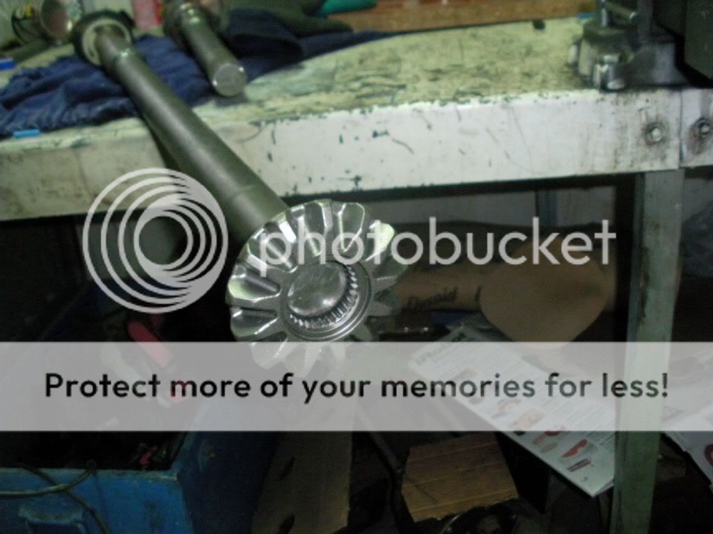

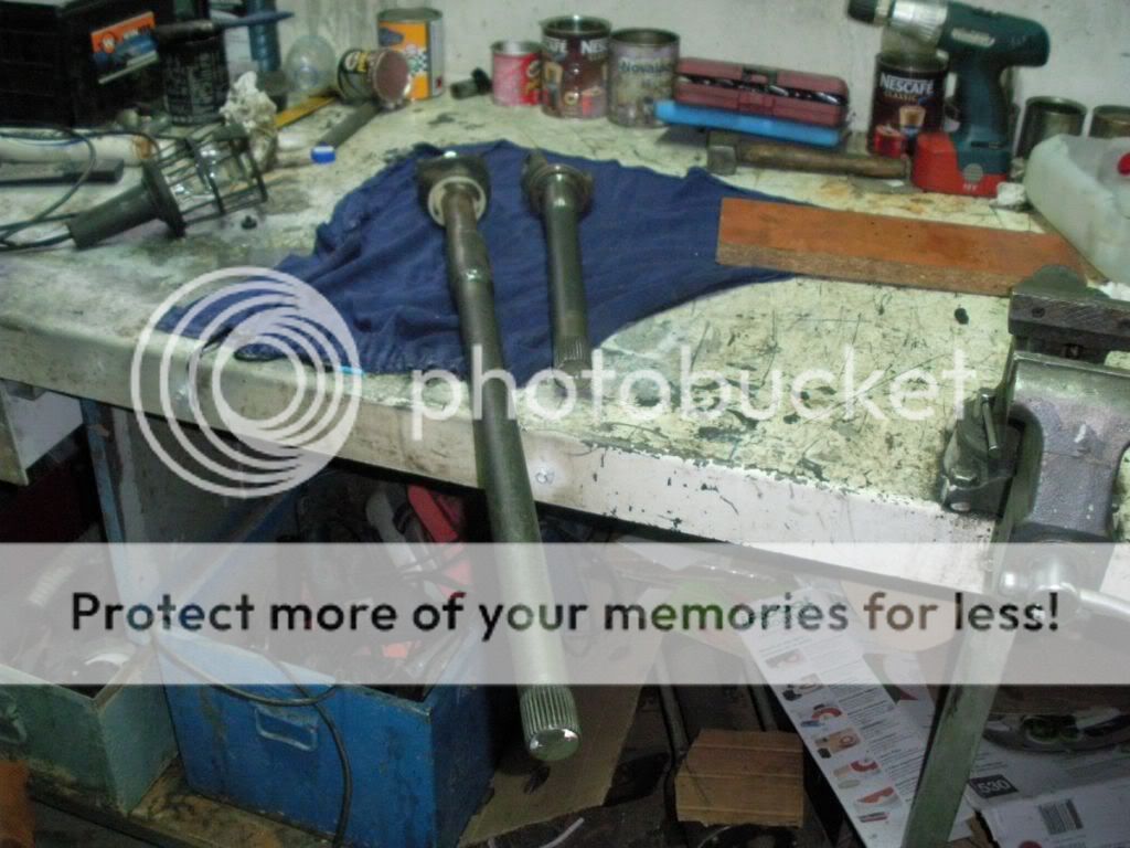

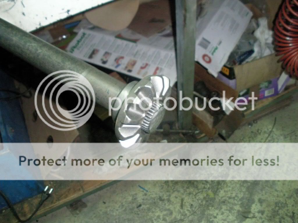

need some work with the front axle shafts that i have to make until i order two from RCV.
need some work with the track bar rubber bushing which is worn out
But since it stands on its own feet, the rest is "details":D

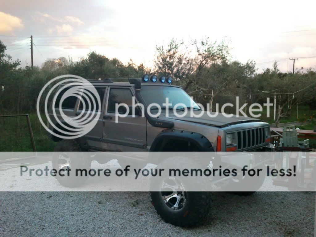

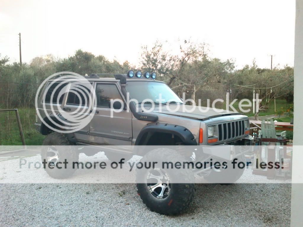

HELLO EVERYONE.
My little hippo is finaly ready.
and here are the final photos
...for now...
(many more things to be done)

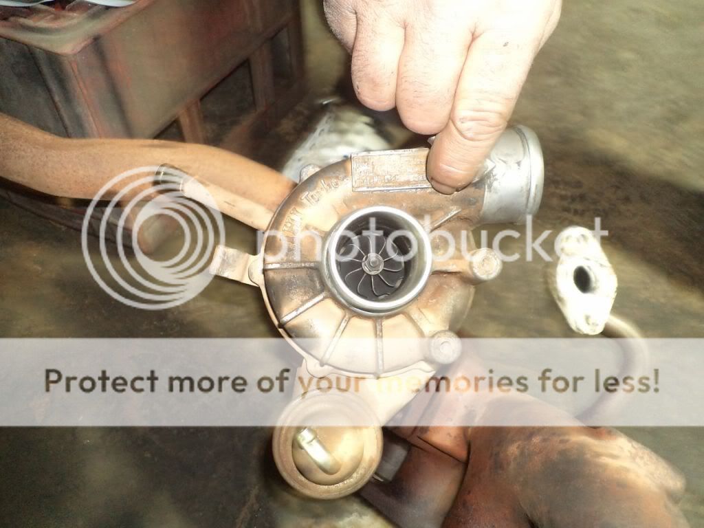

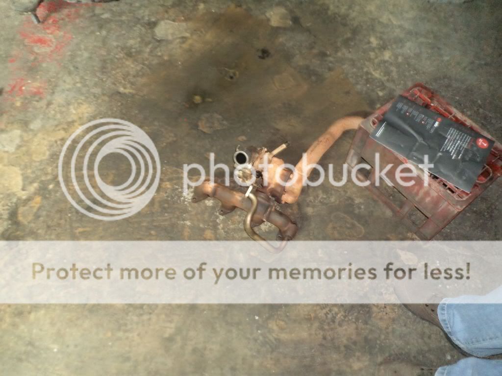

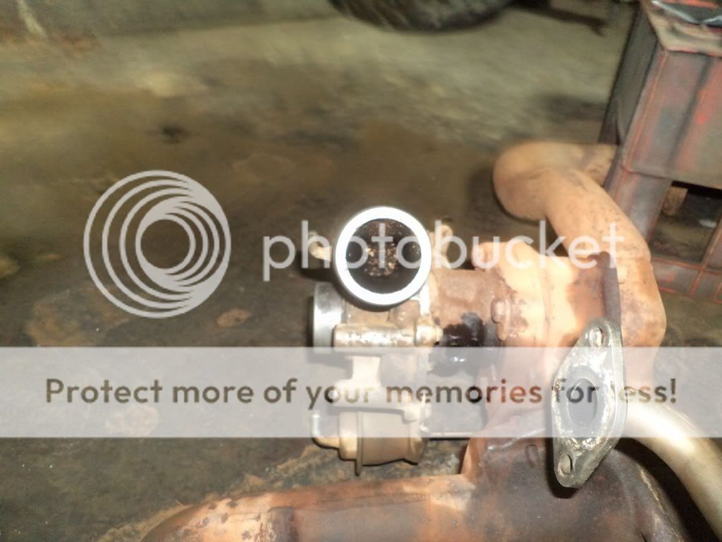

one the first run i checked my turbine and there was a problem
something was missing from the wings lol

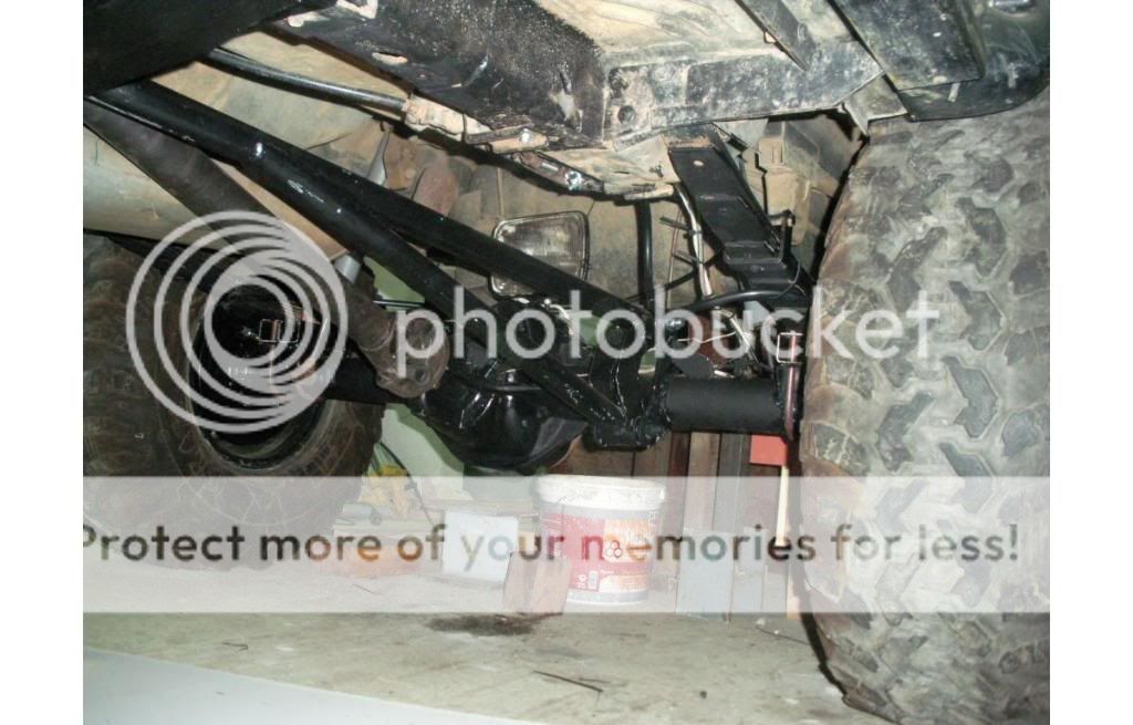

i may have missed it, but are you not locking the front end?
gotcha, looks like it turned out great. i like the hippo on the doors, nice touch haha

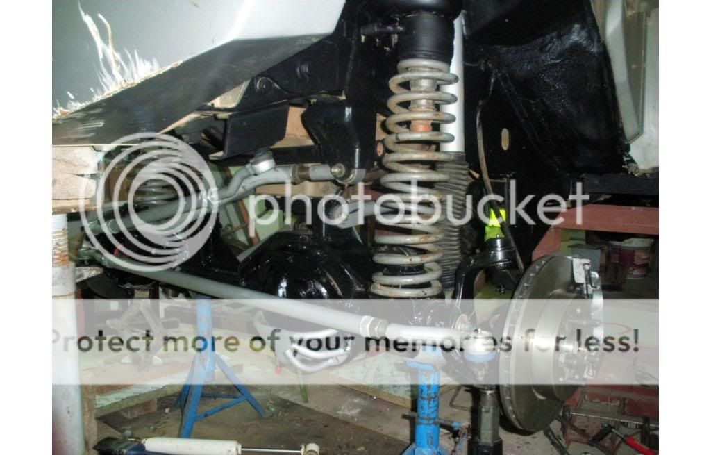

and finaly I might over did it with my suspension
i need to put something to keep the suspension from opening so much because my spring poped off

Glad you got it running!!! Looks like you had fun in some beautiful countryside. I also like the hippo, both the truck and the door emblem. Keep us updated.
Richard
Limit straps will help you with the suspension flexing to far.

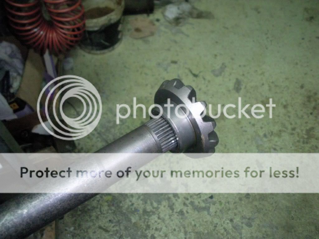

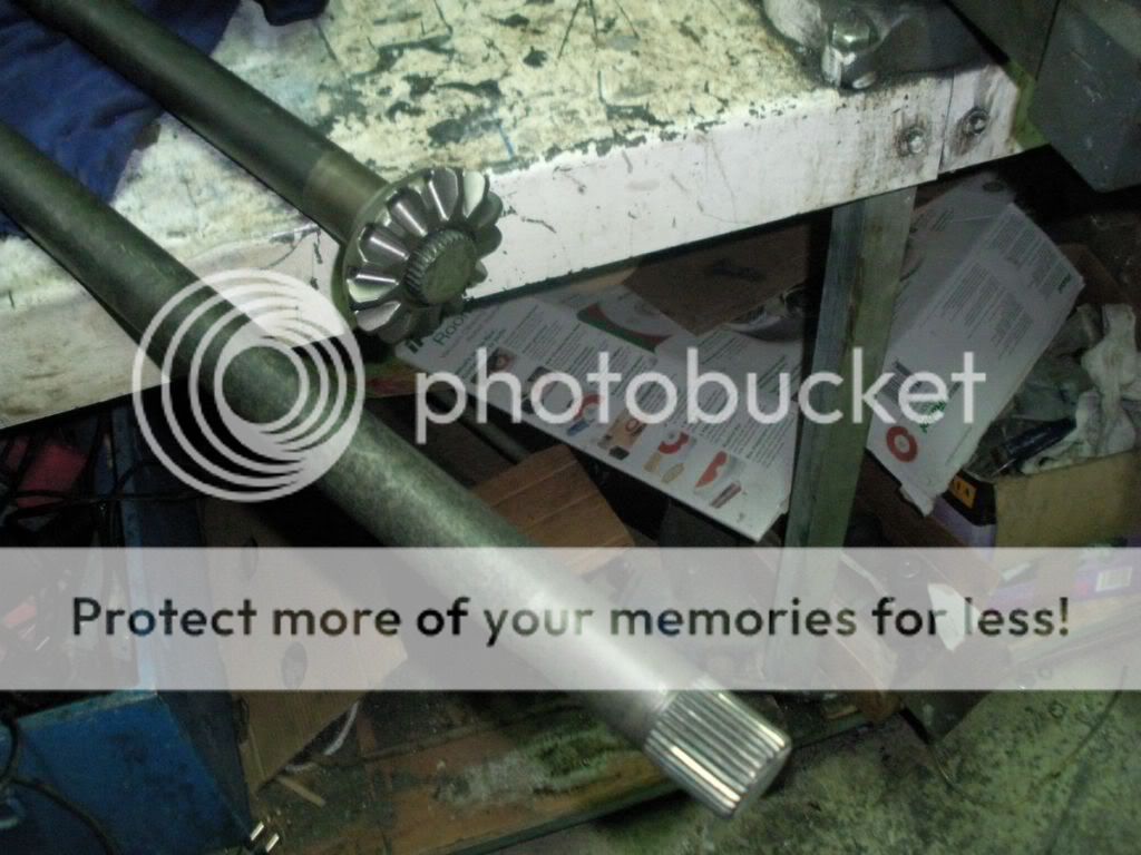

how did you make the shafts that you are running in the front now?
