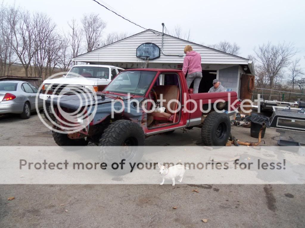

I just found your thread.....ain't it fun when the kids want to get in on the work :yahoo:
Its a fun way to kill some time and just hangout and she has been very interested in how things work so I will get to pass some knowledge, and work ethic on.

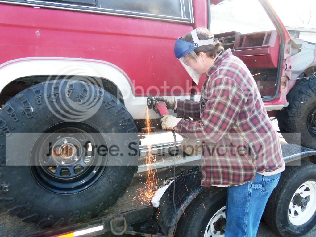

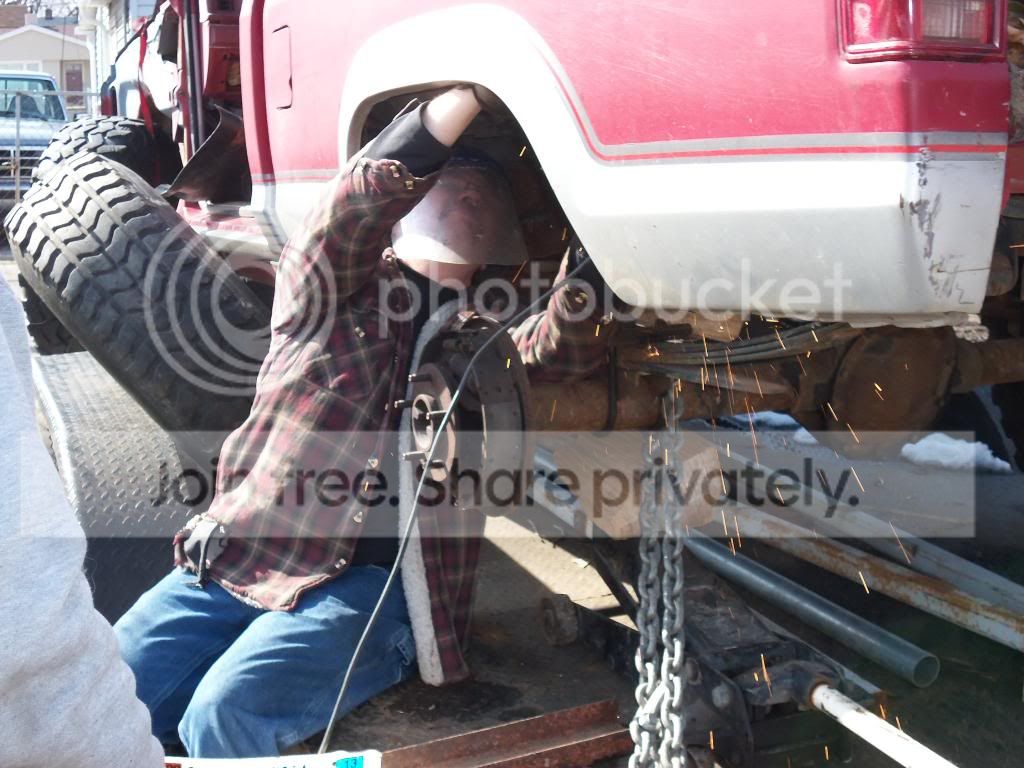

I thought I would get something done last week I was wrong the desire to go freeze my behind off rearranging my Ranger was not strong enough to over come the warmth of the woodburning stove. So it will sit for another few days maybe we will hit the 84* mark in March again like last year.

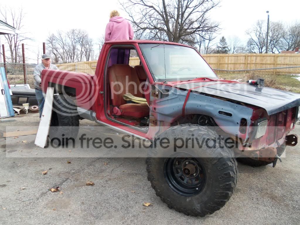

A nice warm couple of days and I was hitting it pretty hard

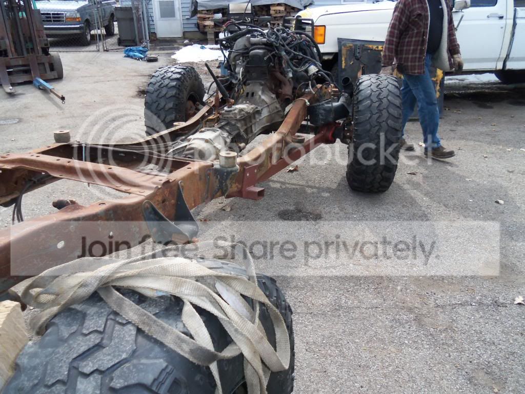

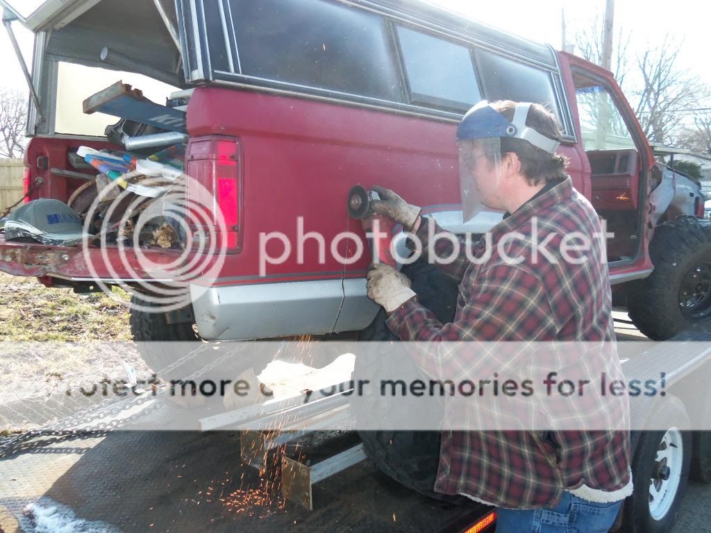

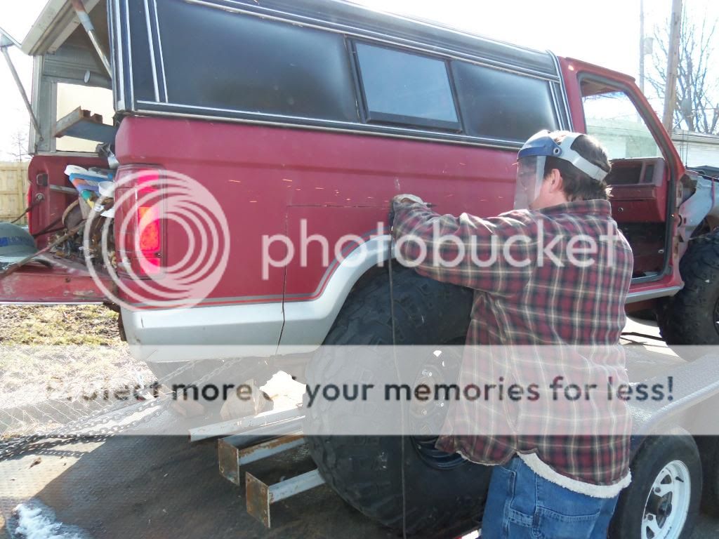

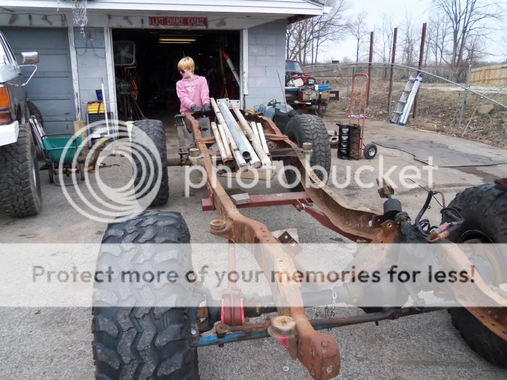

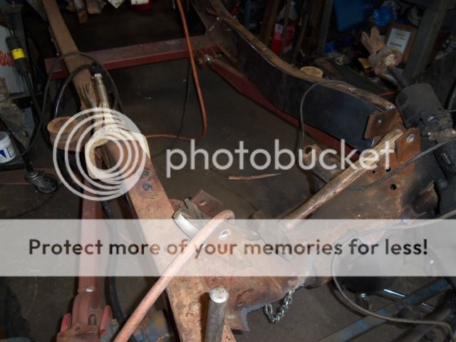

Back down to the frame again to start building the link suspension and box and plug the frame.
Huggyb1972's 87' Ranger 4x4 build

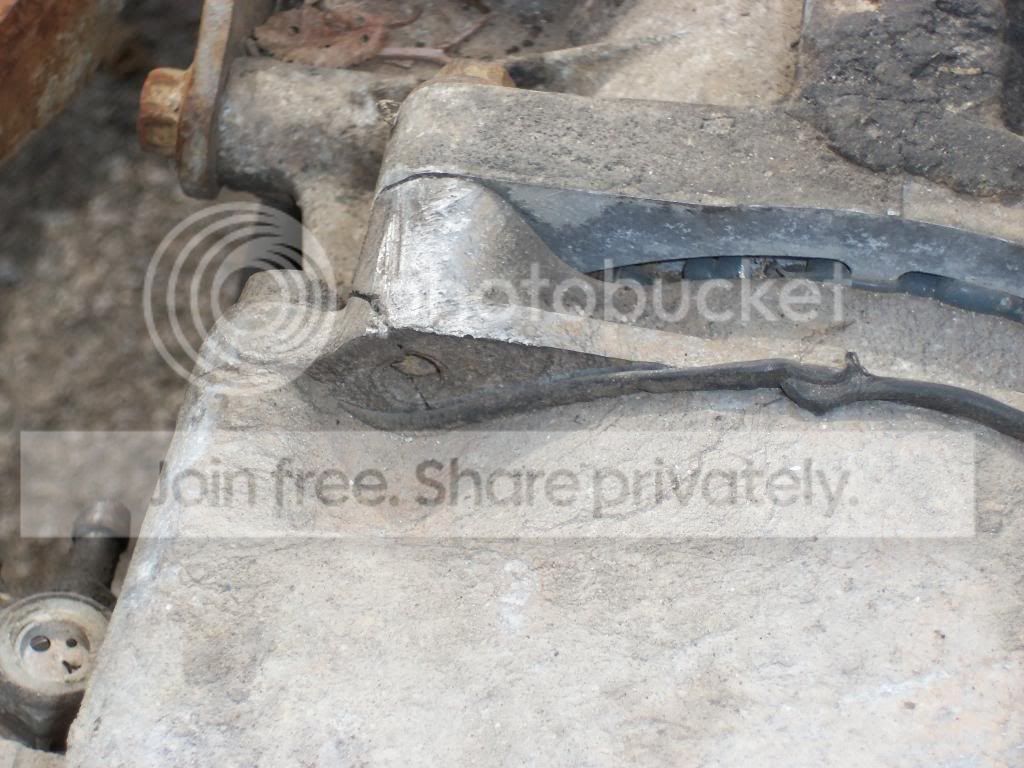

Found a crack in the transfer case this thing looks like it slid down the road.

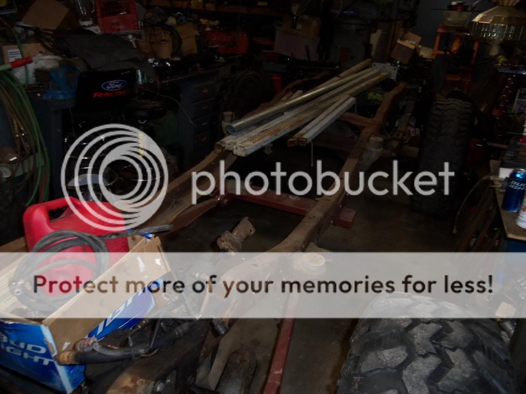

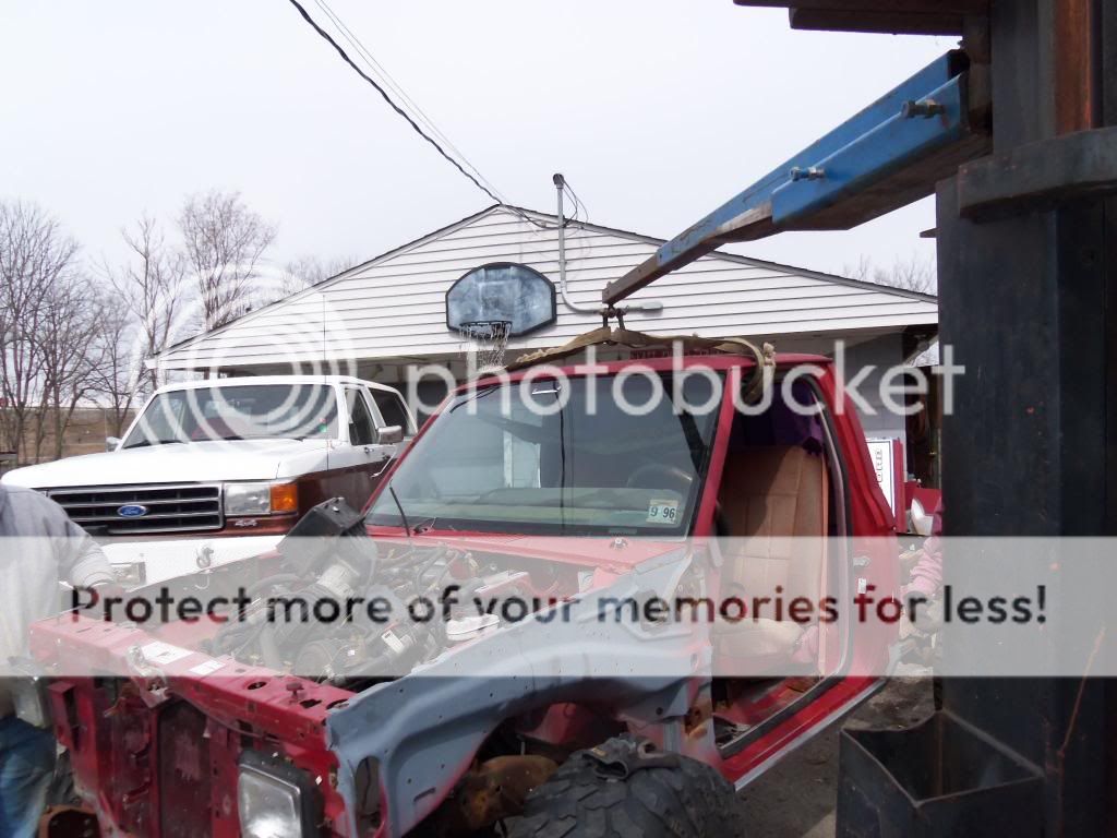

Day one done everything put up and the garage is plum packed full

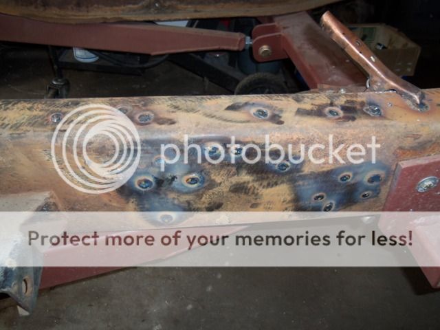

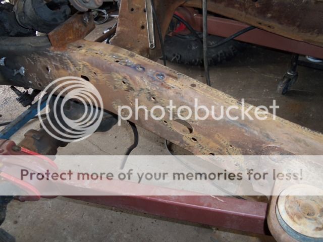

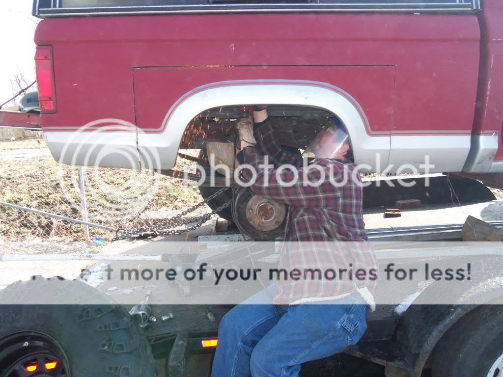

Day 2 weld the holes up and make pieces up to box the chassis in

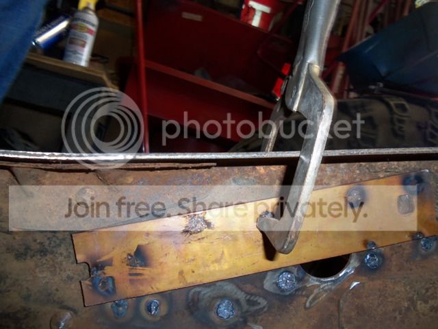

using a copper bus bar to back the metal hole

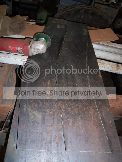

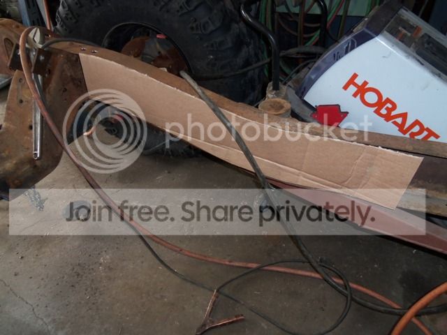

Template for the first portion of boxing it works on both sides

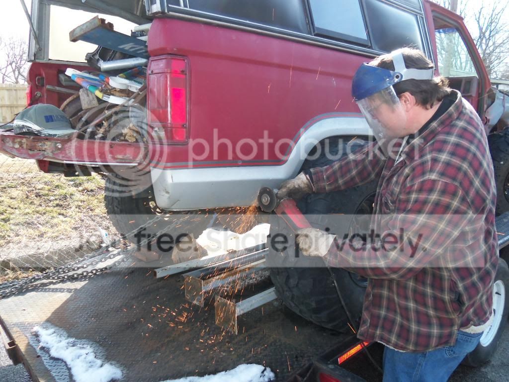

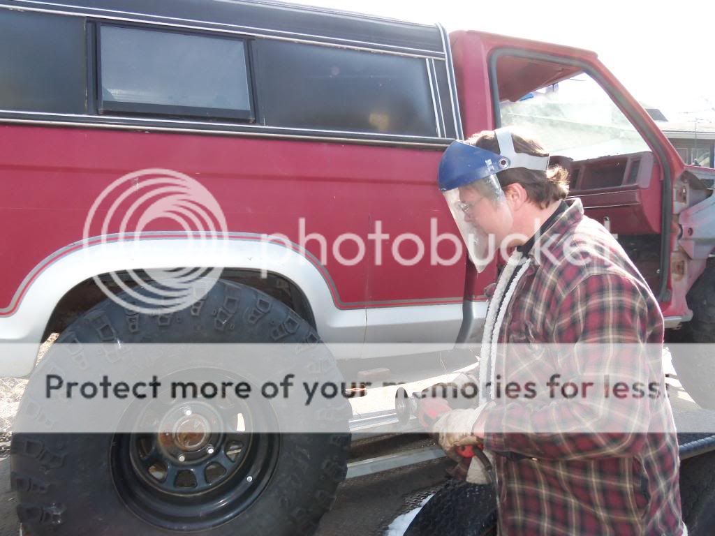

Traced out the template and cut out 2 pieces with a .045 wheel on a 4-1/2" grinder.
That was my stopping point for the day.
