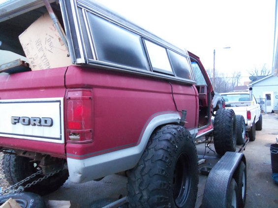

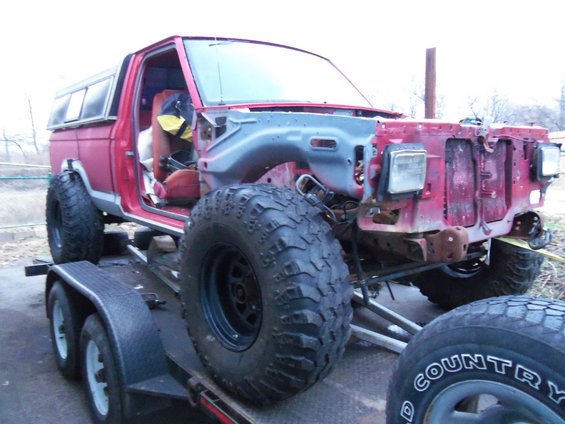

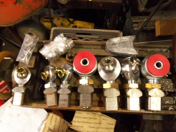

Finally some progress I found a set of wheels for mock up and throwed a set of questionable swamper iroks on it. All the link parts are in and I am trying to get a solid answer on whether my dimensions are correct or not.

I am focused on the rear four link for now still trying to school myself on rool center, anti squat, and all that other gobble-dee-gook. I tossed a 94 explorer hood on it last night and the thing fit I couldn't believe it. After looking at it for a minute I figured out how to build a tilt fron clip.

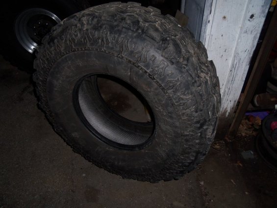

I finally got my parts to start fabrication of the rear trailing arms and Y-link I am going to box the frame rails out and fill all the holes this week. I am having trouble deciding on rolling sleeve/lobe air bags from Firestone or double convolute Denominator II from Airbagit. I'm going to have to order one or the other here once I get my taX check back. I found another set of 3 tires so now I have enough to play on and get it out and tested with.

Not bad for a set of 3 for $120
