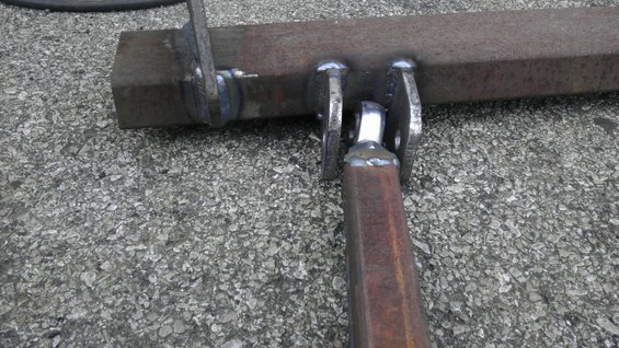

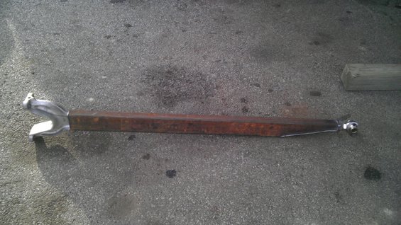

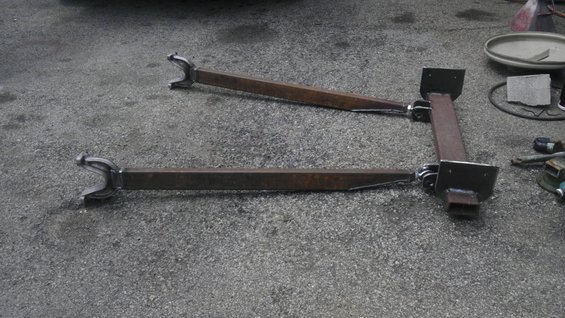

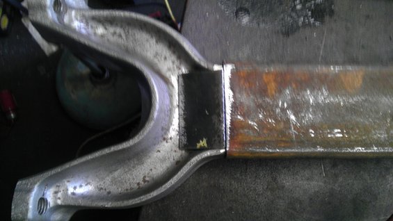

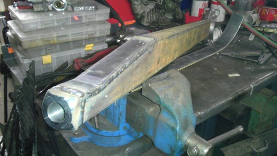

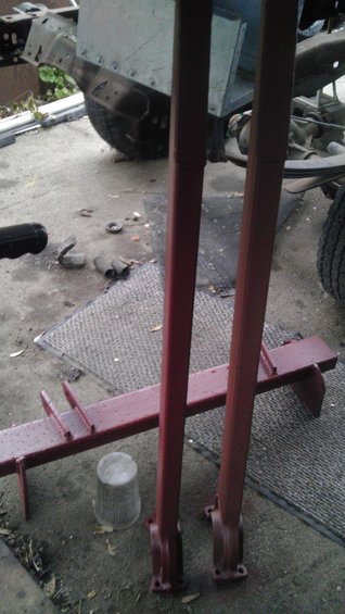

Working on the extended RA's today I shortened them up the other day then took them to work and sand blasted them.

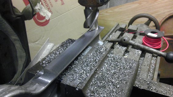

Since I am using rectangle tube to extend the arms I want to make the fit up between the two as tight as possible for strength so onto the milling machine to shave off the casting rib

Nice work on the arms man looking sweet. You should add some speed holes for bling
Thanks I am actually going the other way and wil most likely add some armor to these with some style I really want these to be solid and make clean up easy.

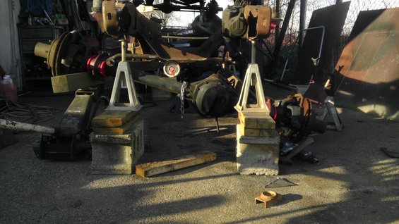

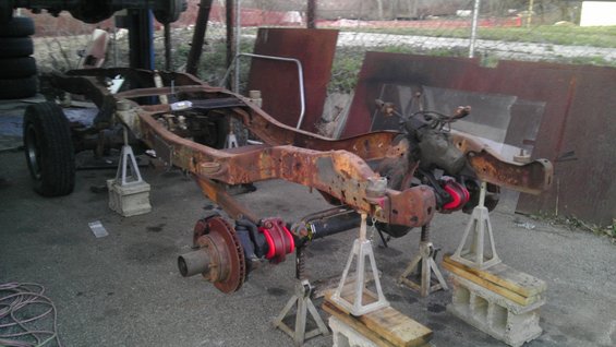

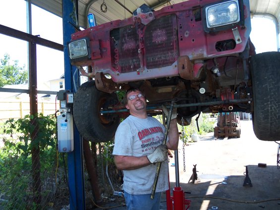

Today was 82 out I got all my stuff out and got all this stuff shoved up underneath. I ended up using the little screw jacks for a RV to level the frame I know they are not professional quality but the weight is minimal and I just wanted everything right from the beginning.

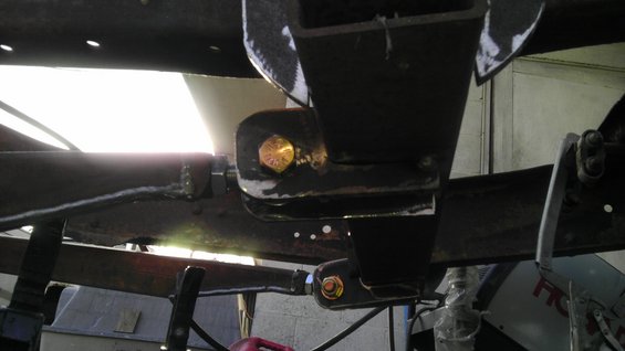

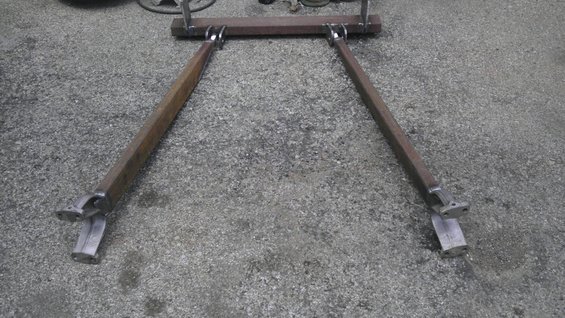

I still gotta figure out the panhard bar the one that its in there is just temporary.
Now I need to figure out how I'm going to lay out the trailing arms in the rear. Without any wheelbase changes the trailing arms will be 54"long. My problem is I need to get my head around setting up the link structure to get it liveable in respect to anti squat and roll center. I have the calculator from over at pirate now I just need to make some sense of what the numbers mean.

So I played around a little with the 4 link calculator over on Pirate and this is my thinking. Any critiques I will be running low on the road with about 4 " of up travel assuming I can get the front axle more uptravel then what I have currently. Then once out in play land the suspension will be out at 10" of up travel.

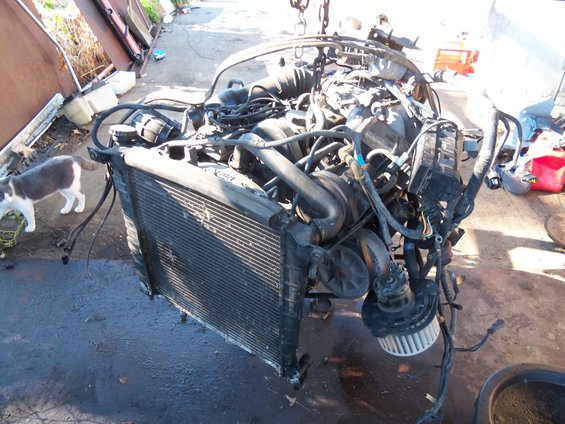

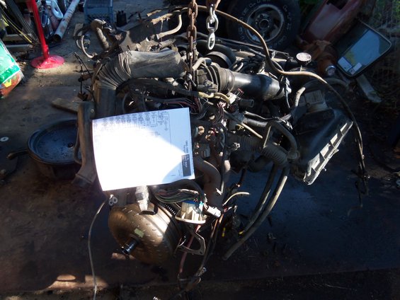

Since my last post not much had changed until last week I got my hands on a 93' Ranger with a sour trans and a 2.3 so this is the engine I will be running. The paper is the wiring diagram forthe ECM harness so I can get it wired right.
Huggyb1972's 87' Ranger 4x4 build

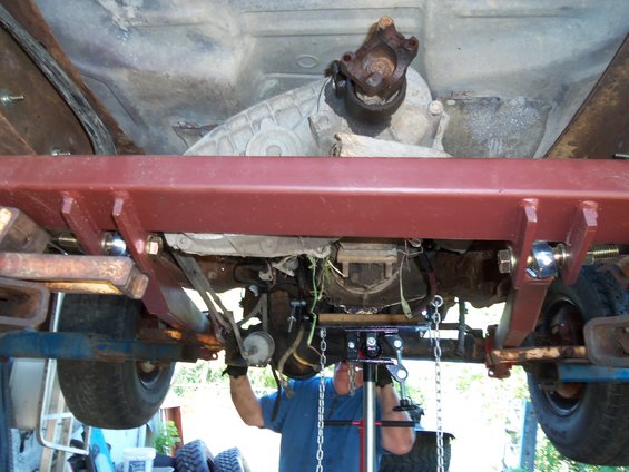

Putting a motor in is so much easieir this way.

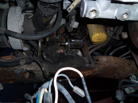

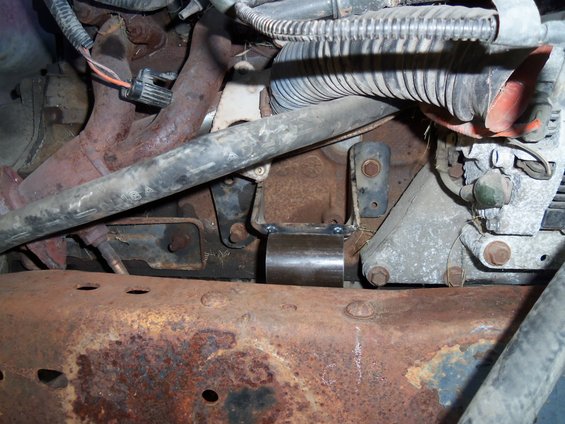

I'm making custom motor mounts for this since the factory one have all broke.
So I am doing a little fine tuning with a prybar hoping to get the motor just a little lower in the chassis.

There must have been some change between the 87 Ranger chassis and the 93 chassis. the cross memeber and the oil pan are very close I was going to modify the cross member any way so the front axle could tuck up farther but now it's imparitive so the motor has clearence.
