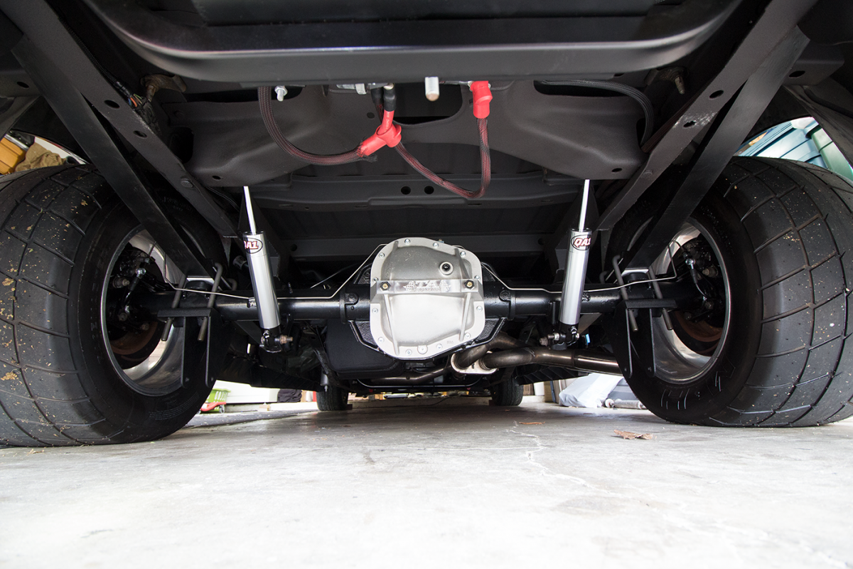

You know not what you are talking about Skippy. I own the damn thing. I put the shackles on it. The spring is on top of the shackles. Which is why longer shackles lower it. See pictures below. The one with the red cover is mine. The others belong to other guys.
If you are talking about your 2021 Ranger, I have no clue. But obviously, if that is the case, you are correct that blocks are the way to go. Whether shackles would make it higher or lower depends on where the spring is mounted. If the spring is mounted on top of the shackles, longer shackles will lower it. Longer shackles will push the spring up higher, toward the bed, lowering the rear. If the spring is on the bottom of the shackles, then yeah, it will lift it up, like so many used to do back int he bad old days of the 60's and 70's.
