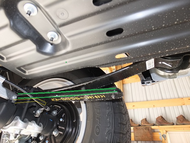

Here is a photo of a 2019 Ranger rear suspension.
  • Longer shackles will raise the back of the truck.
A reputable spring shop could re-arch the mono-leaf and that would lower the truck. However that will put the mono-leaf very close to the helper spring. You'll likely lose hauling capacity, towing capacity and ride quality.

Remove the "helper" leaf Looks like there is a small (1/4"?) plate under the helper leaf. ( highlighted in yellow) That plus the helper leaf might give 1"- 1.5" of drop.
60203
Every Ranger has nearly a 3" rake from the factory.
So you are suggesting ruining the rated load carrying capacity for a 1" drop?
Yes. He said he doesn't tow or haul that much. Which means he is willing to sacrifice load capacity.

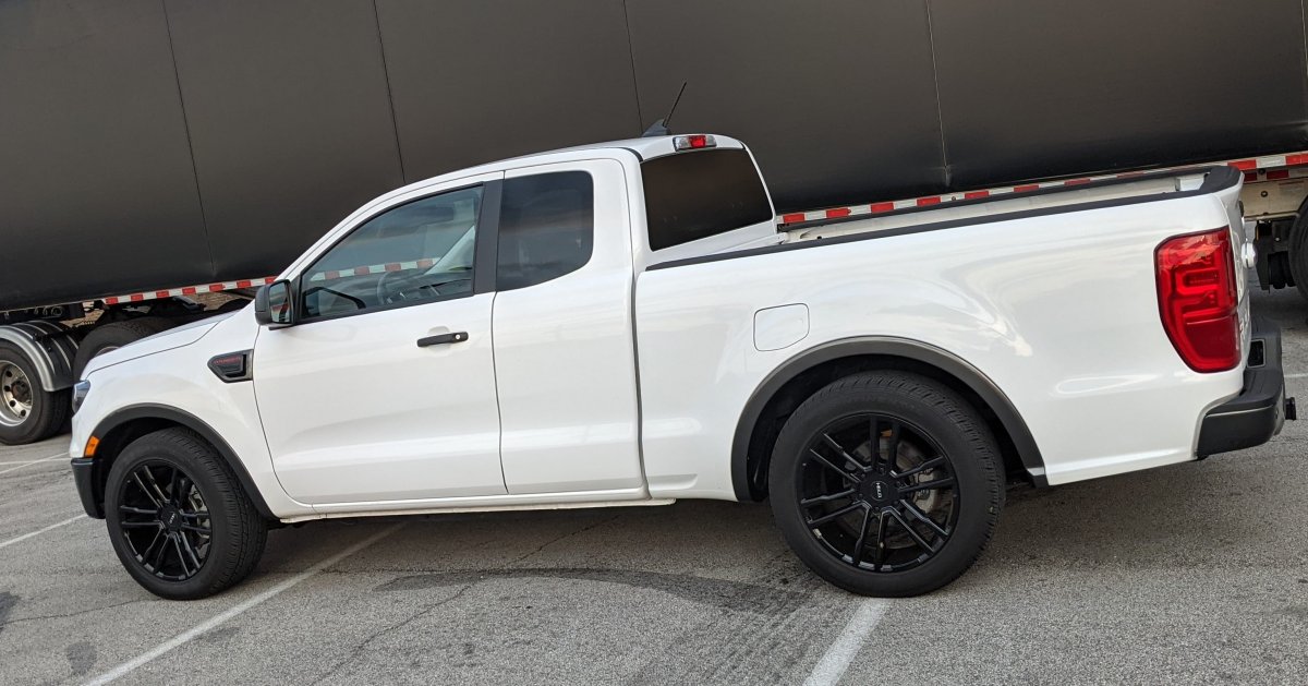

I purchased and installed the Belltech kit this past week. The kit is very well made and the installation was pretty straight forward. I lowered the front 2.5 inches and the rear 5.0 inches

That is the BEST looking stance I have seen on these "new" Rangers. Great Looking Truck, and thanks for the pics.
How is the ride quality compared to stock?

The ride is improved. Less bounce from the back end and smoother overall. Input from the steering is much more positive and the truck is more predictable. One of the best things is I was actually able to easily hop into the bed of the truck and no climbing needed to get in and out of the cab! If you are curious, I am running 20 x 9 wheels with an ET of +33 with 265/50r20 tires with no clearance issues at all.
