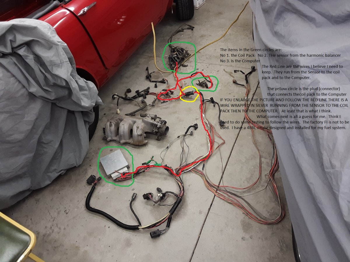

UPDATE: NOW have the 4bbl intake for my 4.0 OHV V6. Stripped the wiring harness from the Ford Explorer. Trying to figure what wires I need.
You will also need a spark system
Spark systems need two things
RPM spark advance and Load spark advance(vacuum advance on older engines)
RPM advance is simple, used to be done with weights and springs in the distributor but can be done with electronics
Load advance is another story, when you "step on the gas" the air/fuel mix changes suddenly, so the spark advance also needs to change just as suddenly or engine stumbles or misfires
In the old days Vacuum Advance was used, and still works
Electronic load advance is faster and better but you need "sensors" and a computer to calculate "load" in real time
The 4.0l OHV never used a distributor but...............
2.9l Distributor will work in the 4.0l OHV, but it uses TFI spark system, so needs a computer for Load Advance
The 4.0l OHV did use an EDIS-6 stand alone spark system(1990-1994) but also needs Load Advance from a computer
The EDIS-6 was popular with Hotrodders so maybe there is a solution for load spark advance for that, never looked into that myself
But most of these were switching TO Fuel Injection and wanted to get rid of distributor, lol
