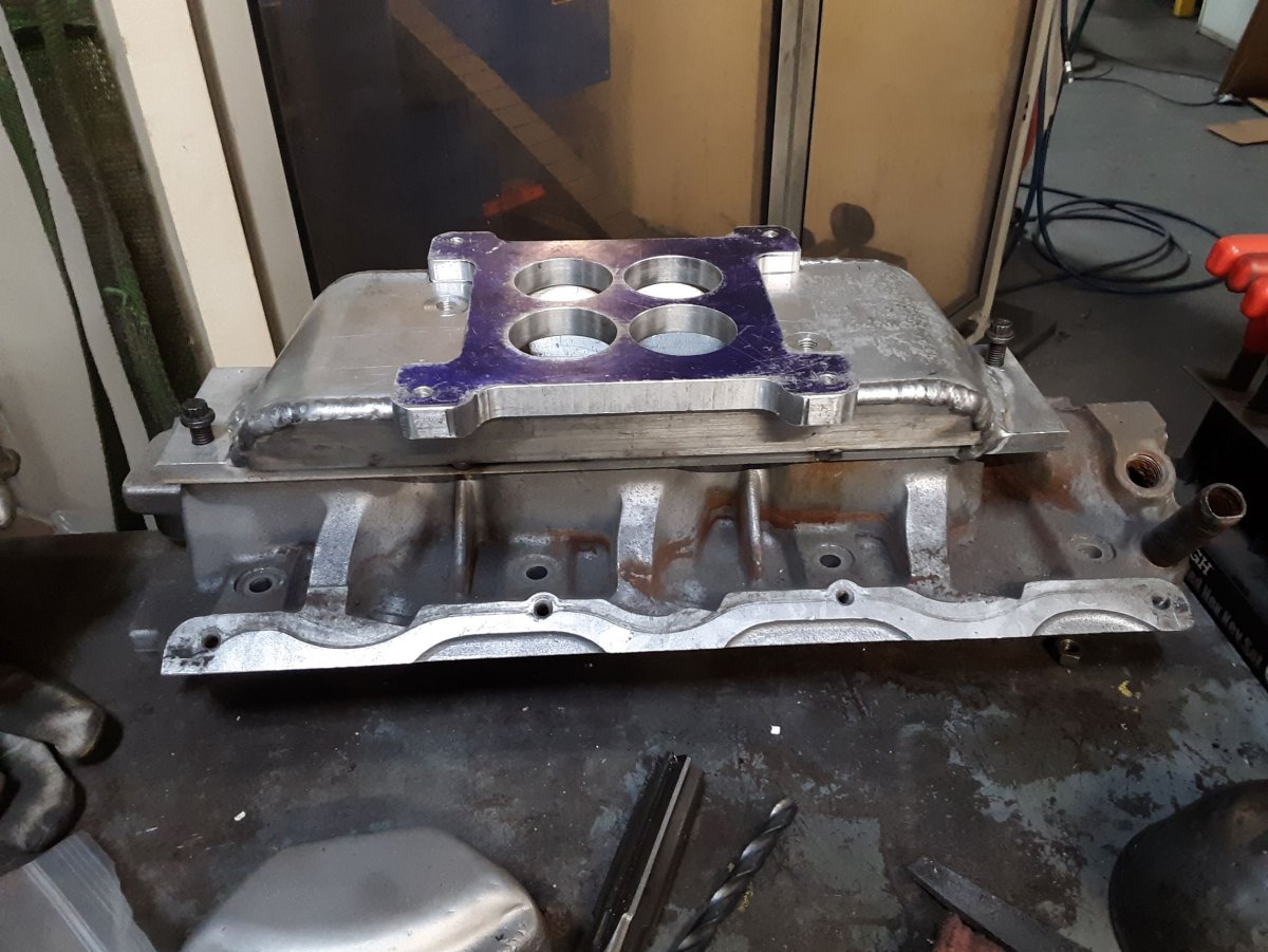

I am having a 4 bbl Intake fab'd for one of the 4.0's that is in the Sunbeam Alpine. It is nearly completed. The design will not allow for a distributor.

I am having a 4bbl intake fab'd (soon to be installed). Its' design does not allow for a distributor (I am utilizing the factory cam driver for the oil pump), so my only option is to figure a way to replace the factory ign and fuel delivery.

RonD, My setup for the 4.0 utilizing a 4bbl intake I had designed will not allow for a distributor (clearance is too tight to even think of it ). I will be utilizing the factory oil drive unit.

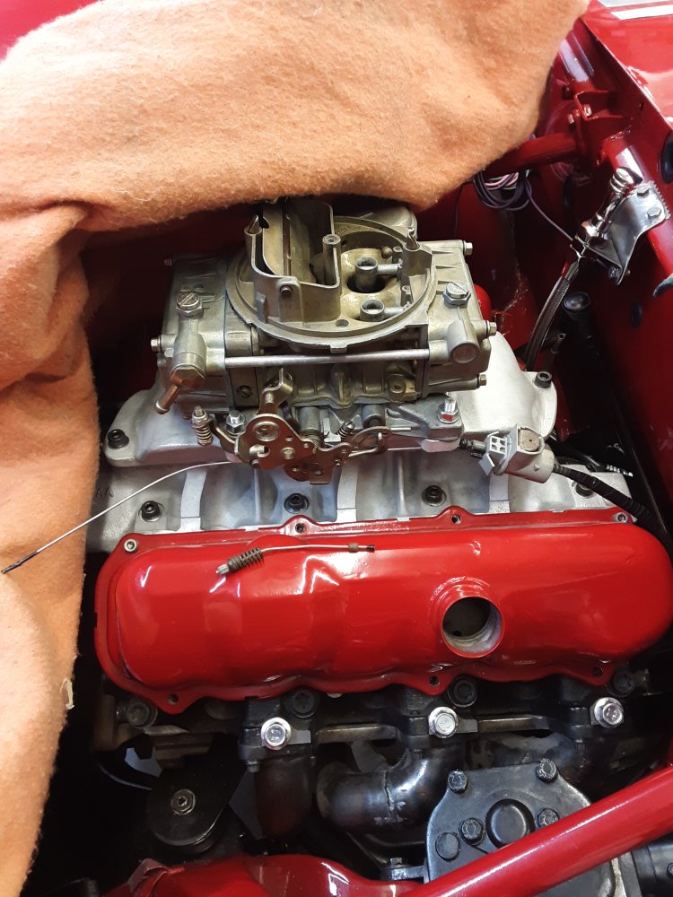

Bill, I attempted to post pictures of my custom 4bbl intake..... don't know what happened. Will try again.......
These are showing some of them... The 4.0 project in "In Work".....

I am now studying the MEGAJOLT/E MK2 system for my 4.0 OV V6 Project in my Red GT Sunbeam Alpine.
A custom 4bbl Intake without a distributor.....
