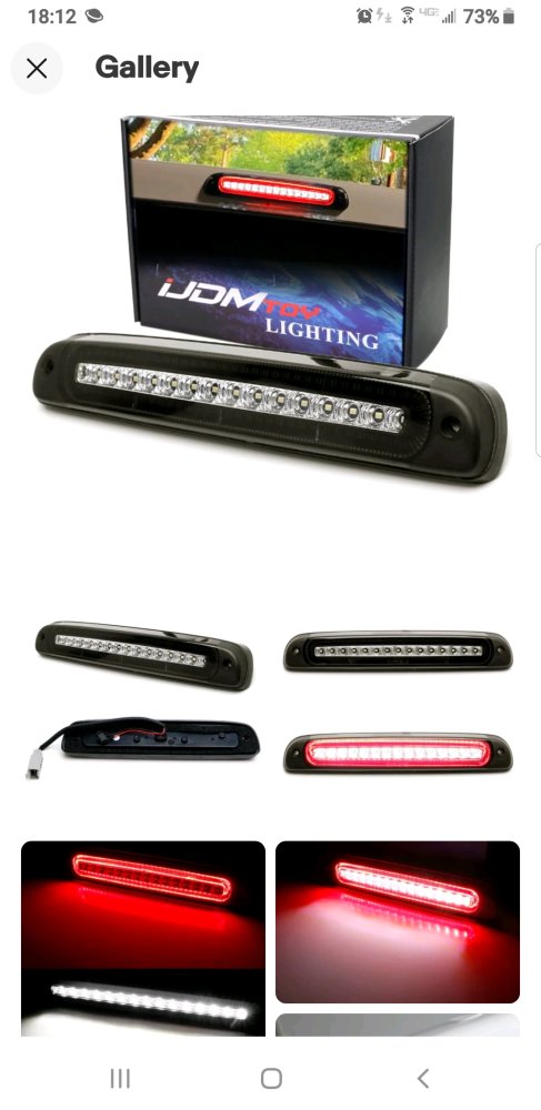

Ok,
1996 Ford Ranger STX 4wd automatic transmission 4.0L engine, Is the vehicle that is having the lighting issues.
I also have LED tail lights and LED high third brake light on my 1995 Ford Ranger XLT, the 1995 is having no issue at all with LED Lighting.
I've been racking my brain trying to figure this out,,
I have installed LED high third brake light, and I have installed the LED tail lights, (see attached pictures).
The issue seems to only affect the right tail light and the high third brake light, the left tail light no issues at all,
I've been tracking (or trying to track) down the problem, I have shot gunned replacements of multiswitch, brake light switch, emergency brake switch, three different high third LED brake light, and different LED tailights,
Now for the issue,
When I turn on the RIGHT turn signal, the third brake light flickers, when i put on emergency flashers, the high third brake light flickers, I disconnect the LED tail lights completely turn the RIGHT turn signal on the LED high third brake flickers, when I turn on the hazards the LED high third brake light flickers, ANYONE run into any of these issues with their installation of LED exterior lighting??
Any thoughts?
Any suggestions??
Any help of where I have not looked???
Thank You,
Robert.

The third brake light is wired with the dome light. When you turn the dome light on the 3rd brake light comes on also.
Anyway the main things you have flickering are in the 3rd brake light sphere of influence eh ?
Maybe it is a corroded ground. Have you looked inside the 3rd light yet? I think those are amongst the areas sometimes prone to leakage. When I was at the Picker's yard I picked up an extra 3rd brake light and I think 2 extra seals, and may have doubled up the seal on mine
I really think you might have a poor connection or ground somewhere
Poor grounding seems to be the most common issue with light problems.
Very true, and especially with LED lights, as they're much less of a load in the circuit as opposed to the stock incandescent bulbs.

Some LED brake/turn signal lights required a flasher that supported LEDs. It would drop the voltage down since 12 vdc was too much for them. At least that was the older LED lights.
