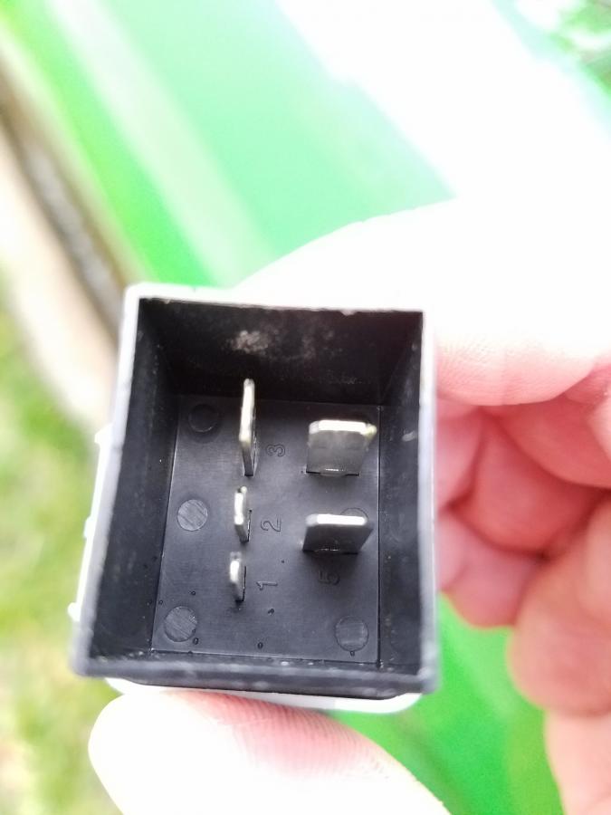

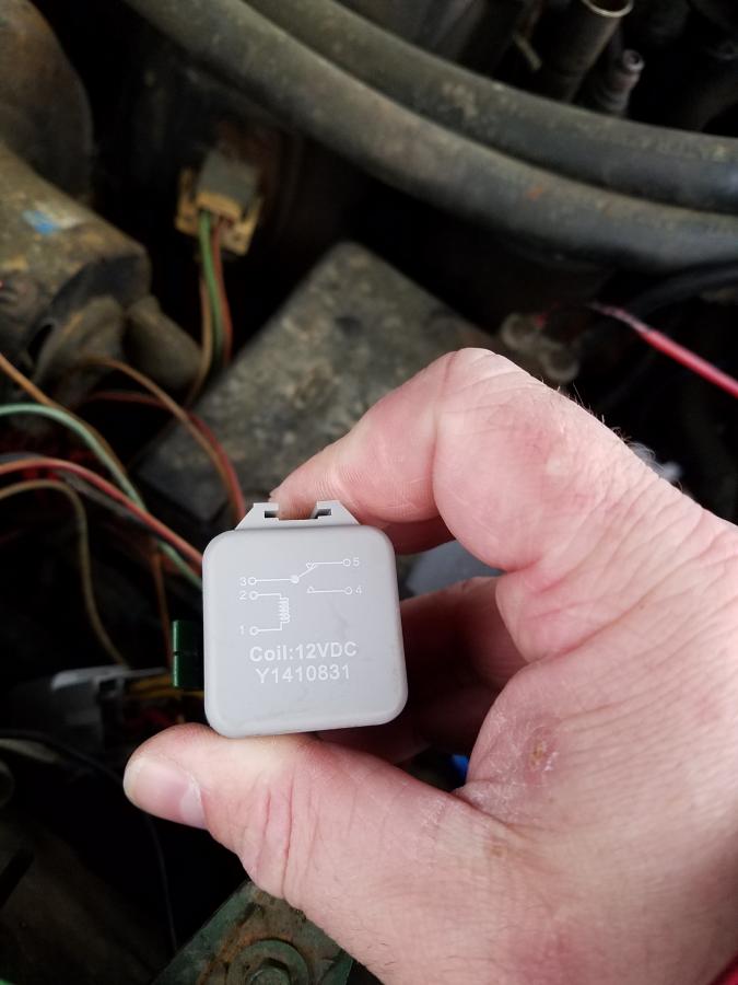

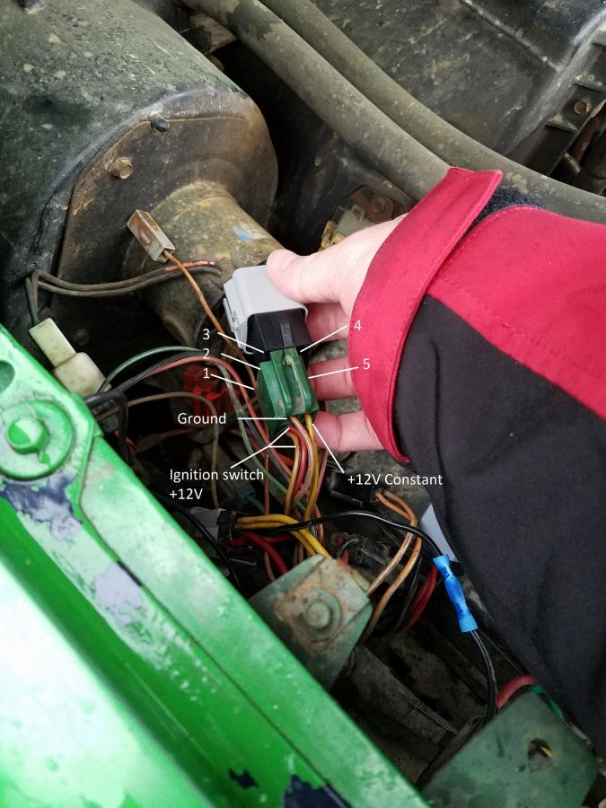

But here's something helpful finally - see attached images. Using the graphic, I was able to figure out which pins are the coil, and energize it. It works. The problem is in the wiring of the truck. Or, more likely, the layout of the relays (two from two different auto parts stores) that I've been getting. As you can see, the wires for the truck are not in the correct locations to match up with the wiring of the relay. For all intents and purposes, we can assume this is an NO (normally open) relay. I DID find out that the previous relay had a sticking contact anyways, so that was another contributing factor there. Sadly, I trashed the original relay, so lord only knows what happened to it.
Image details -
#1 - pin layout for the relay
#2 - pin layout as they go into connector, in same orientation as picture 3
#3 - orientation with connector, with pins marked, and wires labeled.
As you can see, I have a ground going to pin 3, 2 switched +12V going to pins 1 and 2, and a constant +12V going to pin 4, and nothing going to pin 5.
Obviously I have 2 options. I am getting a new connector, already on its way from Rock Auto. I have 2 options for wiring it in now. I can either wire it in and match what already exists and try to find the CORRECT relay, since I've apparently gotten two now that are the same but wrong for the existing wiring. OR.... I can wire it up to match the relays I've gotten.
My question for you all, based on your apparent experience with these trucks..... which one will be the best course of action?

yes, not a "standard" automotive Relay
Ford relay and socket
If you want to use that relay and socket then you will need to repin/rewire it
1 and 2 are 12v from EEC relay(ignition 12v) and Computer Ground, coil activation, no polarity
3 and 4 are the Load, 12v from fusible link(constant 12v) and wire to inertia switch, no polarity, passes 12v when relay is closed
5 has no connection
If you had the relay plugged in while testing the voltage then 1 and 2 should both read 12v ignition, because there is just a coil of wire inside the relay, so 12v in would be 12v out
With replay pulled out of socket only 1 or 2 would read 12v, making that wire the one from the EEC relay
Computer ground is harder to test for since it is ONLY A GROUND for 2 seconds.
Hook up meter or test light to battery +
Then hook other wire to the wire you want to test
Turn on the key
You should see 12v for 2 seconds
When you do that is the wire from computer and the one that goes to the coil in the relay
