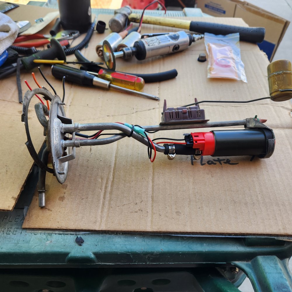

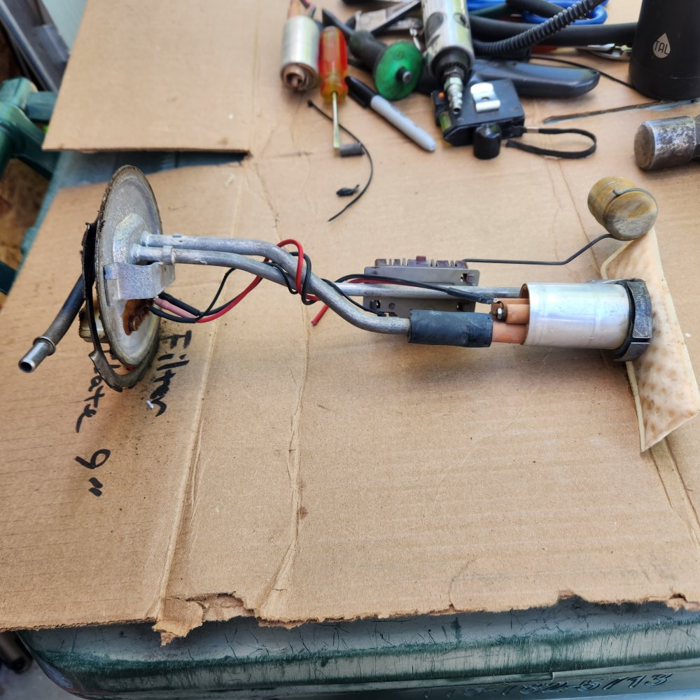

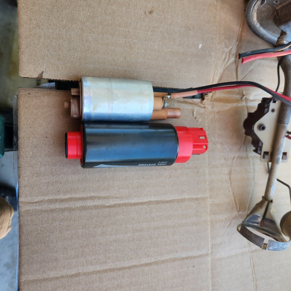

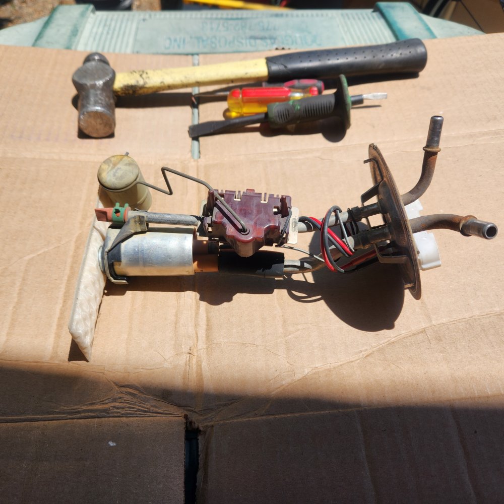

Sorry no posts. Got hurt at work and could not do anything. My truck has 2 pumps. I bought 2 pumps with all the parts, flow and pressure for a later model truck. It even came with both style filters for 77 dollars. I pulled the bed. Then I pulled the rear tank pump not knowing what I needed to do to fit the new pump. The old low pressure pump is shorter than the new pump. The fuel output is also smaller than the old pump. The provided hose would not fit the metal line. After a trip to the autoparts store for bigger hose, I was ready to go. I had to cut 3/4 off of the metal line. After that and a little bigger hose it went onto the old frame. I did the same thing with the front pump. I tested both of them. Started up and the gage worked. Of course it overflowed the reservoir but it worked. Now I need to remove the reservoir, frame rail pump and redo the lines. I am attaching some pics for reference.

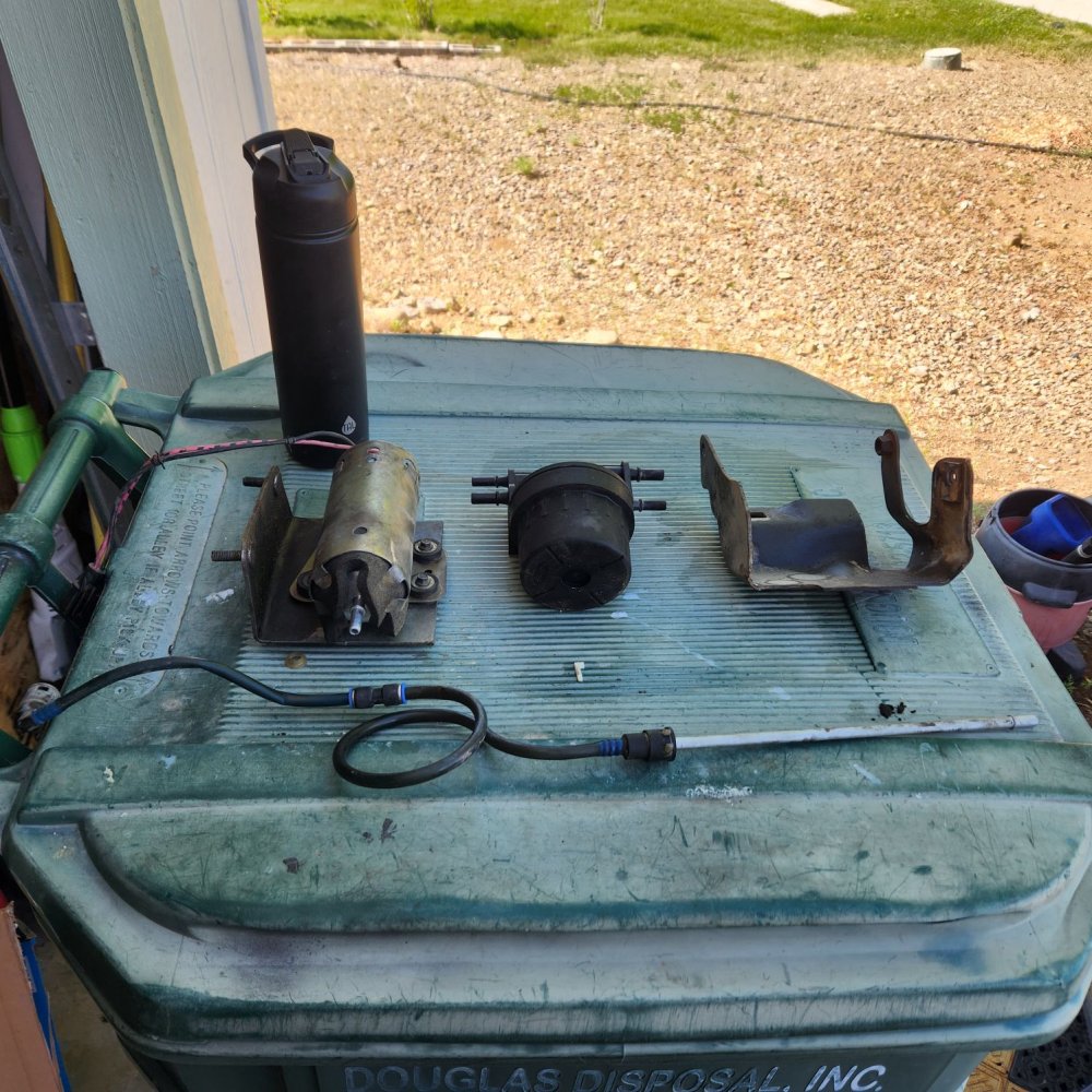

Well, I removed the frame rail pump, the reservoir and for not the brack covering the reservoir. I think the low pressure return line should be OK. The line from the selector valve to the filter line is leaking to put it mildly. I bought the 12 inch metal lines for both lines, the replacement lines with fittings and the funky push connectors. DONT EVER USE THE PUSH FITTINGS. I am going to call NAPA tomorrow and see if can build me a fuel line. I got barb connections but that's the last resort. I'm posting a picture of the removed part and leaking fuel lins and fitting.

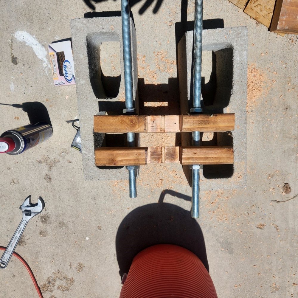

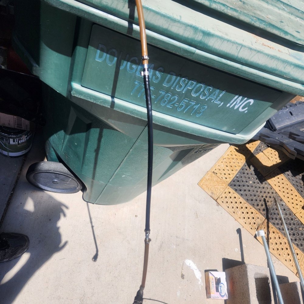

Well, I got my system complete. I tried the heat gun and did not really like that method. I liked the rental tool you guys recommend but I could not get it for at least 4 days. I had also ordered the correct crimp style crimp clamps. I decided to make my own fuel line press. I used two pieces of 2 x 4 some 3/4 all thread with nut and washers. The fuel line are about .325 diameter so I drilled a hole thru the 2 x 4's with a 5/16 drill for tight enough clamp pressure without cracking the line. I notched out the 2 x 4 thru the center of the 5/16 hole so I could assemble the line ad barb fittings. I put the line and barb fitting into the press with a little wd40 for lube and pressewd them together. I attached pics of the line and my press to give a better idea of what I did. It runs very well and I have about 34 psi at the fuel rail.
