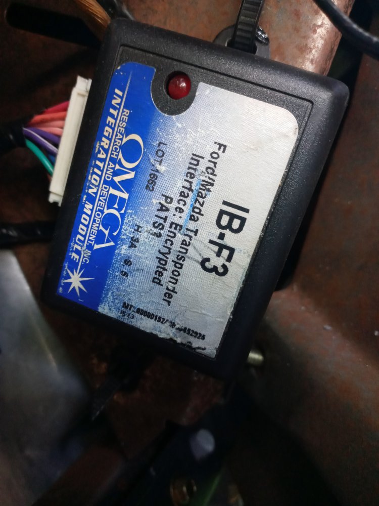

I also found these two boxes under the dash pretty sure I know one of them is probably not factory I think it's either a remote start keyless entry or both which is dumb because it has manual locks and windows which is also weird for an XLT unless you special order but the other I'm not sure or what it even does?? Also found At least one wire that was not hooked up to the clutch safety switch, But it about had to be like that the whole time I've had the truck it looks like it's been snipped like a delete or bypass will be able to know for sure once I can find a detailed wiring diagram for the clutch safety switch and will the transmission sensors have anything to do with it since I change transmission should I put the old ones back in?
One is the PATS bypass module for an aftermarket remote start system. The other is an alarm module.

Yes neither one of those components is factory
Google: Omega IB-F3
I am betting thats your issue, someone was already by-passing PATS
And just to confirm, the THEFT light is in the cluster not an added light for the separate alarm systems
Yes the theft light in the instrument cluster with the speedometer and tachometer is flashing but so is the other box
