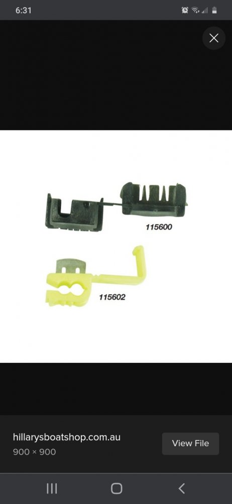

Remove all that remote start viper BS! Put it all back to factory... alot of installers use those piggy back wire connectors which should be outlawed!!!!
Then you might have to get it to a shop or a mobile lock Smith to re sync key .
Those things cause so many problems and just to be able to crank your car from in the house or 10 feet away! Lol its nonsense!!
If you see these get ready to solder/crimp every thing!! Lol

Yeah I pulled everything out resoldered the wires you're still two wires I have to reconnect for the clutch safety switch and if need be find a plug from the junkyard for the inertia switch to rewire it up right now the wires are soldered together I don't know if that would matter if not I might just leave it but the thing that's got me stumped is why the OBD2 port has power to my reader and it red codes before this happened on the same truck but now it Powers up and acts like I never turn the ignition on and from what I've read online the pats system won't prevent the reader from being able to read codes and I'm not sure how to go about fixing it or figure out what the problem is I did just add to a battery terminal gauge grounds from the motor to the frame and from the motor to the body I don't know if it will help fingers crossed if anyone has any idea of what could be going on with the OBD2 or what I can do to try and get it to work other than the fuse please let me know
