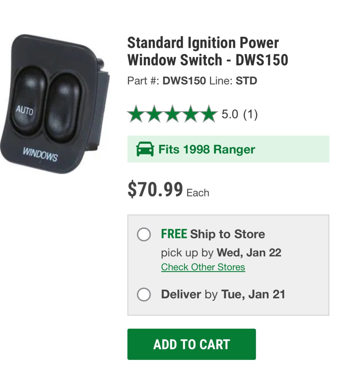

does your switch look like this? (go to 2nd pic in gallery for the back side of the switch)
Per O'Reilly that is 93-95... don't know why that is listed like that unless ford did 2 redesigns one in 95 everyone knows about and one in 96 I've never heard of (or else oreilly's interchange is just flat wrong)...
That is a 93-94 switch. It’s what is in my truck. The newer panel is from a 98 and has this one. The wiring color on the newer panel
matches a 98+ anyway. Like I said, when I bought them they were listed as 95-01so I assumed they were exact matches in regards to wiring but they weren’t. Now I am just trying to verify they will work. I figured someone would have tried this before and there would be plenty of info on the subject. There is virtually none. I will figure it out though. It ain’t rocket science. I just don’t know a lot about these trucks. And info is hard to verify with a lot of this, due to the fact Ford changed some stuff here and there. The trucks are mostly the same, but enough was changed to throw wrenches in my plans. am a Mustang guy. But I needed a truck so here I am. Just trying to figure it all out. By the time I am done with this thing I will be very knowledgeable.

Maybe somebody will come along and post the wiring schematics for the '98's donor truck power windows. I don't know squat about anything '95 and newer, but something in the back of my head (those damn voices again) is saying that Ford may have starting using power window relays sometime after they started using the GEM, and then the SJB (Generic Electrical Module and Smart Junction Box).
IF that turns out to be the case, you're dealing with two different circuit types, but you can still get around it by adding your own relays so that the '98 switches can drive the '94 window motors.
A '98 schematic would be super helpful here. A picture of your '98 switches, from the backside, and the '98 wiring connector (if you have them) would help some too.

The fuse box info for 98-00 shows #4 being windows, and #26 being window relay so yeah it had that whole through the GEM nonsense...
