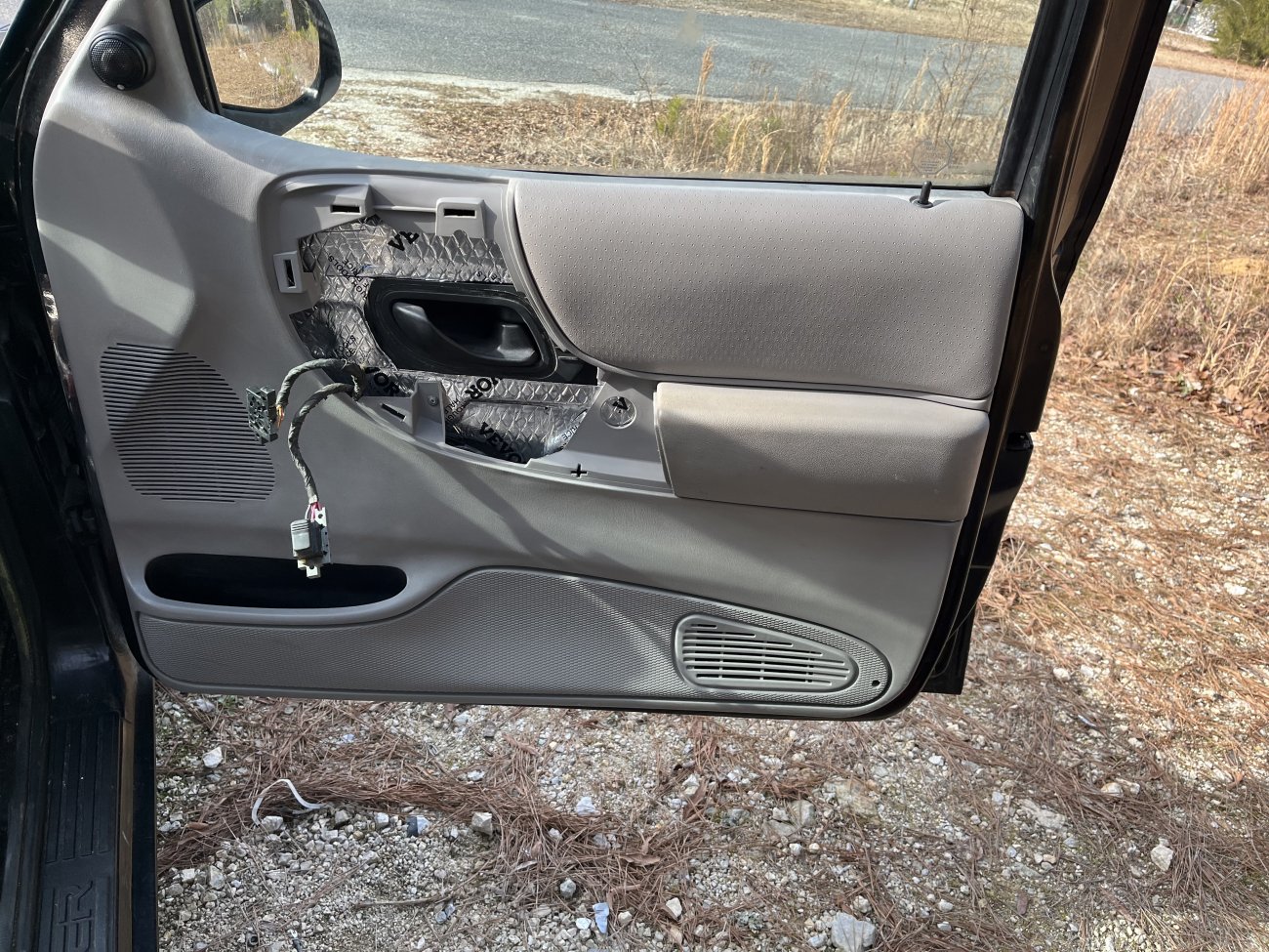

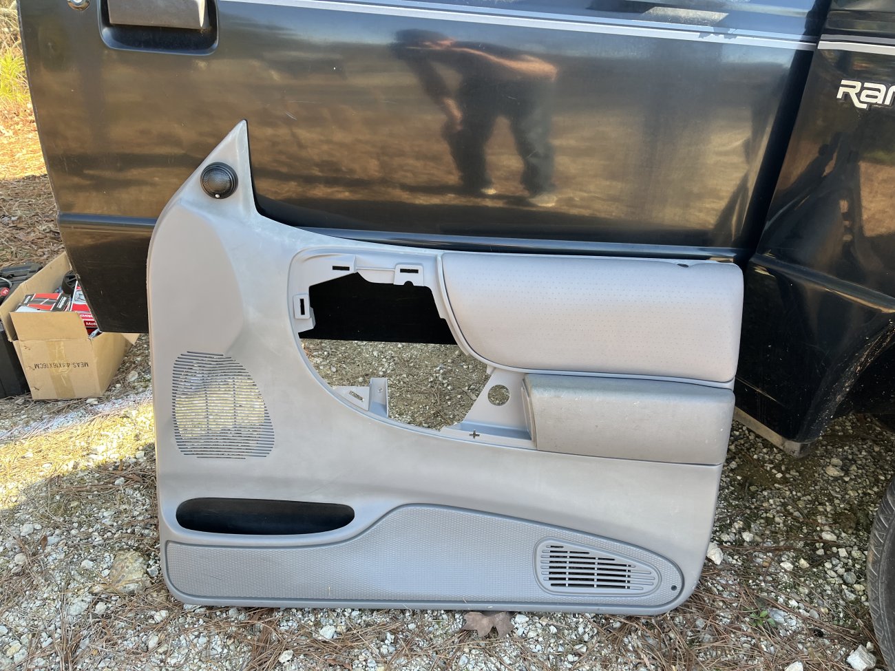

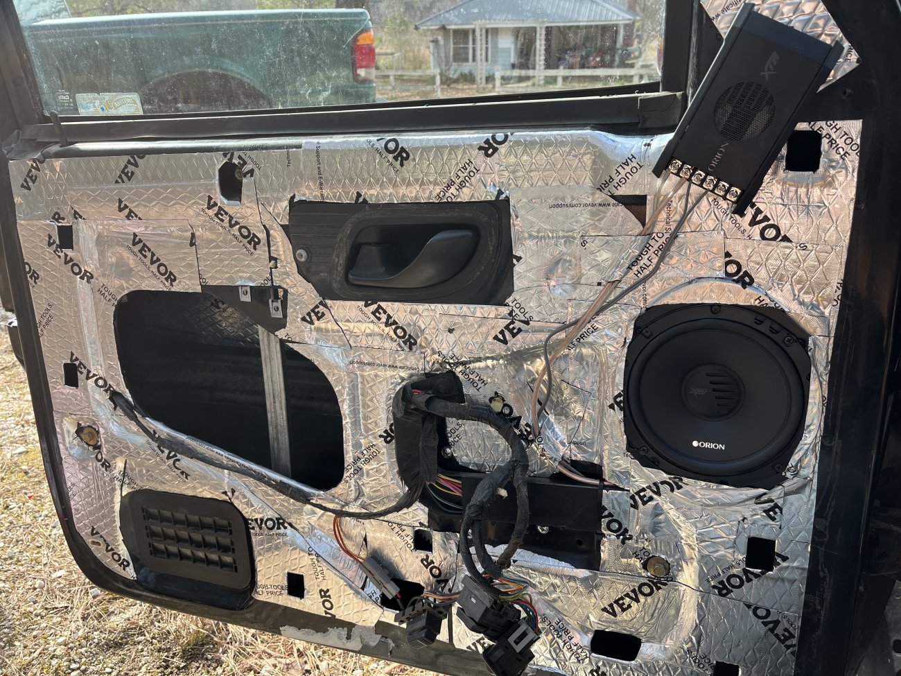

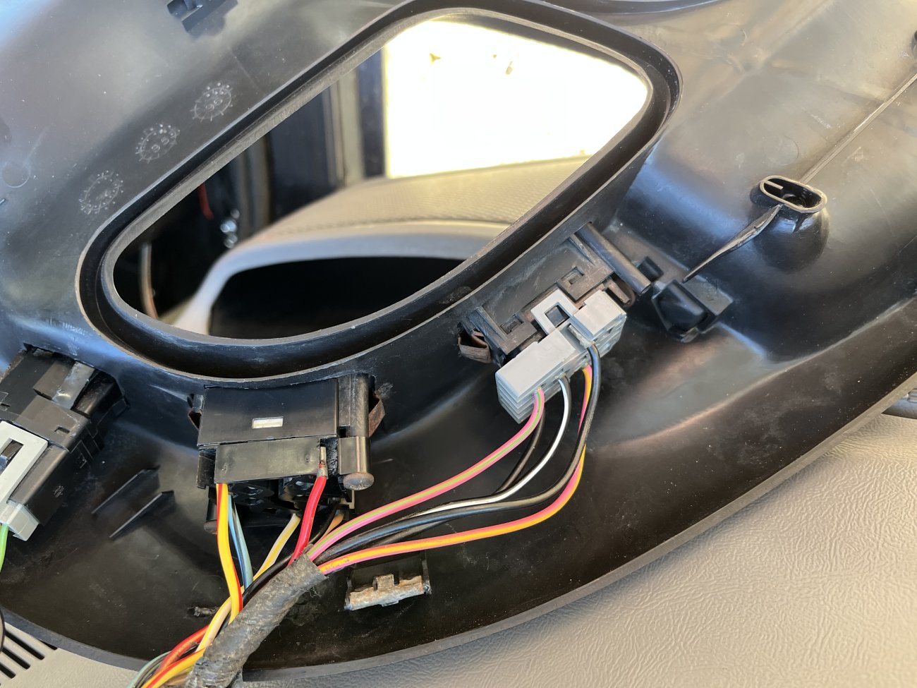

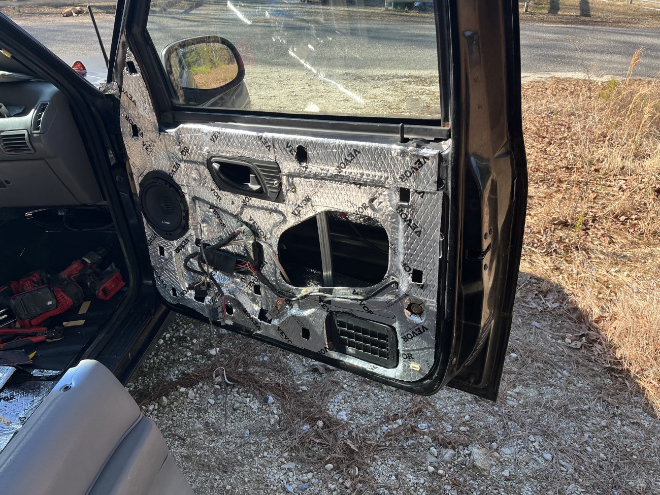

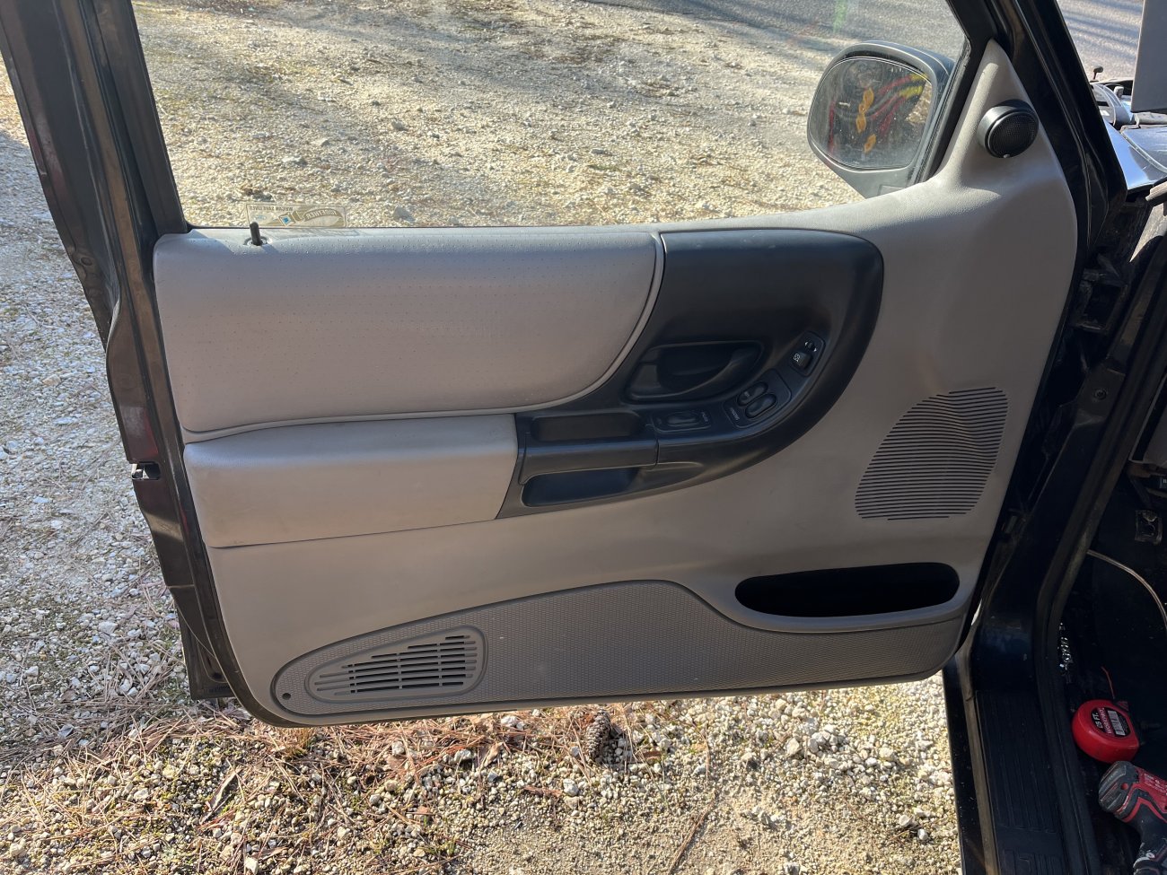

Well, sound deadening is done. Component speakers and crossovers installed. 98 panels installed. Switches have also been re-pinned and work! As do locks and mirrors!
That turned out GREAT. Nice work!
As much as a pain in the butt as it is to write up a tech article, I nominate you to write up a tech article for "Swapping 98-03 door panels into a 93-94" as the 93-94 is so rare that there is gonna be lots more guys wanting to do just exactly what you did.

I got my switches rewired and working thanks to everyone’s help. I appreciate it! I will print out a diagram and make notes on how I wired everything so it can help out the next guy. It’s actually really easy once you have the info!
Be happy to do that. Give me a bit and I will get it done. It’s actually pretty easy once the info is all there.i have other stuff i am planning on doing to the truck. Maybe I can do some kind of build log also.
