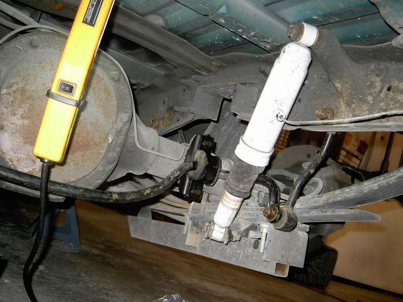

Like this:
Borrowed from: http://www.fordrangerforum.com/lowered-suspension/40272-explorer-rear-flip-kit.html
AH! Thanks, Shane. It worked right in my brain! I thought "4 years for the GenI Explorer.
Let us know if it works, Nasty!

He tried the rear sway bar from a 90 Ranger 4.0 but he got impatient and tried it while I was at work and said the bends cleard the the pumpkin and hit the shocks and he returned it.
Im going to take a look as routing the 7.5 bar behind, etc maybe an option if we cant get a later model to clear.

Mocked up the swaybar and it looks like the 7.5 bar will be a straight forward install with it flipped rearwards. Just drill 2 holes in the frame an install drop links.
And the mounts for the axle it self will clear the pumpkin no problem.
