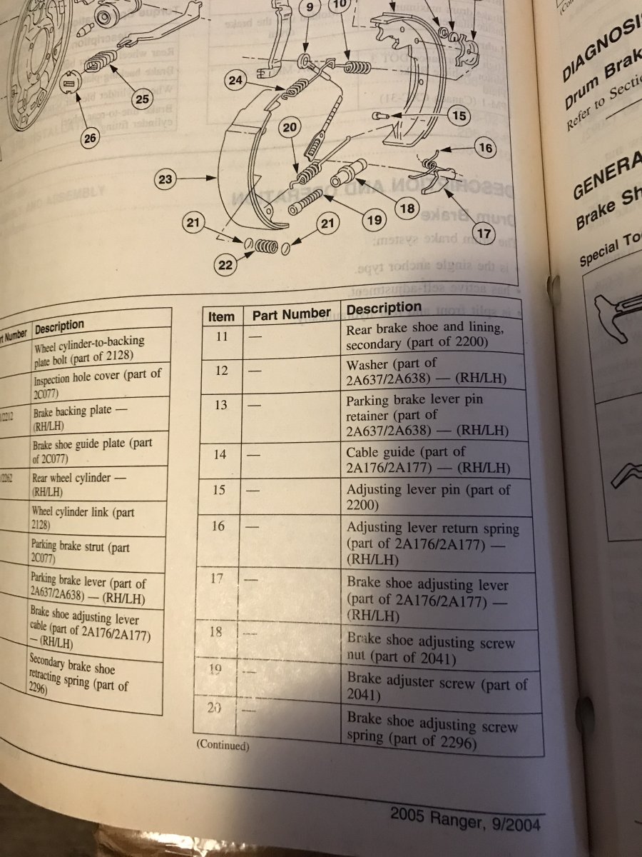

The small diameter adjuster is wrong for the truck and would never self adjust, it looks like someone jury rigged it on a day when the parts stores were closed. I would get the right adjuster and assemble the brakes properly so you can depend on them, even if it means replacing more parts- shoes for example. It's cheaper than losing your brakes.
from a 2005 factory manual
they are different than the older models.
My 06 doesn't use one like that. So it's not an older version thing. If anything... the one inch your manual would be older.
I bet if there was a change in design the change would have been the same time the axle flange changed in 98.
^this,
the adjuster for the 10" rear brakes starts with 1L5Z
The 1 means its a 2001 PN, and the L5Z is the vehicle line, in this case, the ranger
