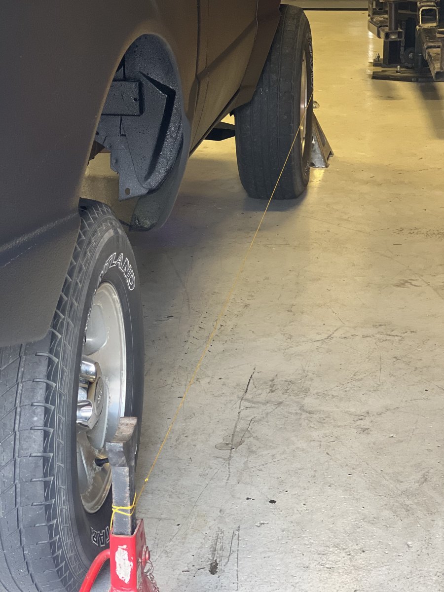

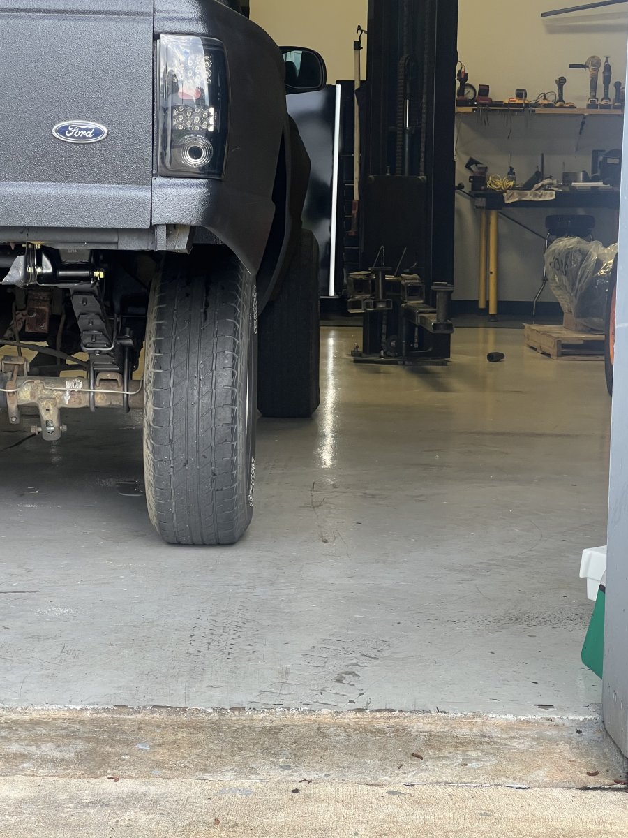

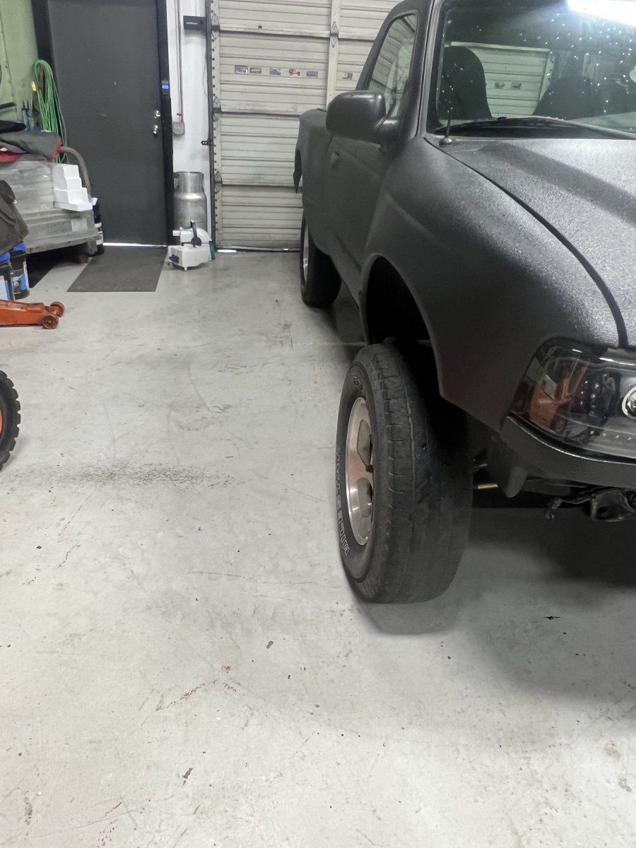

Installed a BTF 4.5 long travel front suspension that naturally pushed the front tire position out. The rear is now about 5.5in difference from the front.
What can I do to make the rear more flush? I don’t want to do massive spacers. Is there a rear axel upgrade I should look for?
I will be installing new wheels and tires (likely 17” wheels with 33in tires. Stock wheels/tires are shown here
