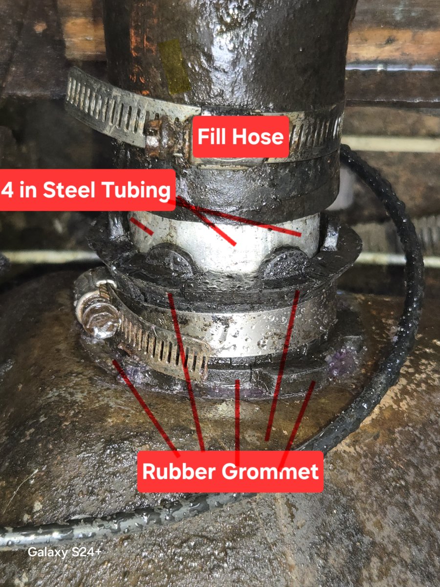

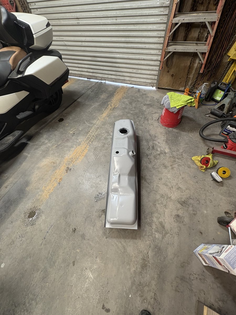

I have a 1983 Ranger XL 4x4 2.3l carbed 4 speed dual tanks, the front tank leaked when i got gas the last time so I removed the bed.
The fuel tank where the fill hose attaches to the tank is flush with the tank, there is no piece of steel sticking up to connect the fill hose to. That being
said there is a rubber grommet of sorts in the opening of the tank with a piece of steel looks like exhaust tubing hose clamped in the rubber grommet and the fill hose is hose clamped to that steel tubing which is aboput 4 inches long.
The rubber grommet is severely cracked etc and needs replacing, and i see that there are plenty of fuel tanks that have no raised short piece of steel tubing on the tank in which to connect the fill hose to, BUT for the life of me i cannot find that piece to replace it and no one at any parts stores has any clue what im talking about.
Please help. any info would be greatly appreciated.

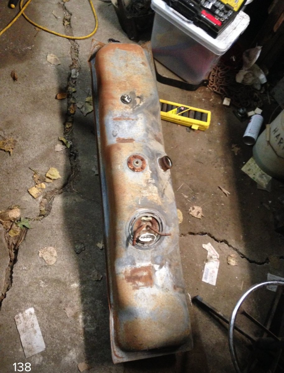

Im adding a pic of an identical fuel tank to mine. Even upon searching fuel tanks online like the one pictured here, every site i have searched has nothing as to what goes in the hole. Summit racing referred me to a company in Canada that manufactures fuel tanks, they didnt have any idea what goes in the hole.

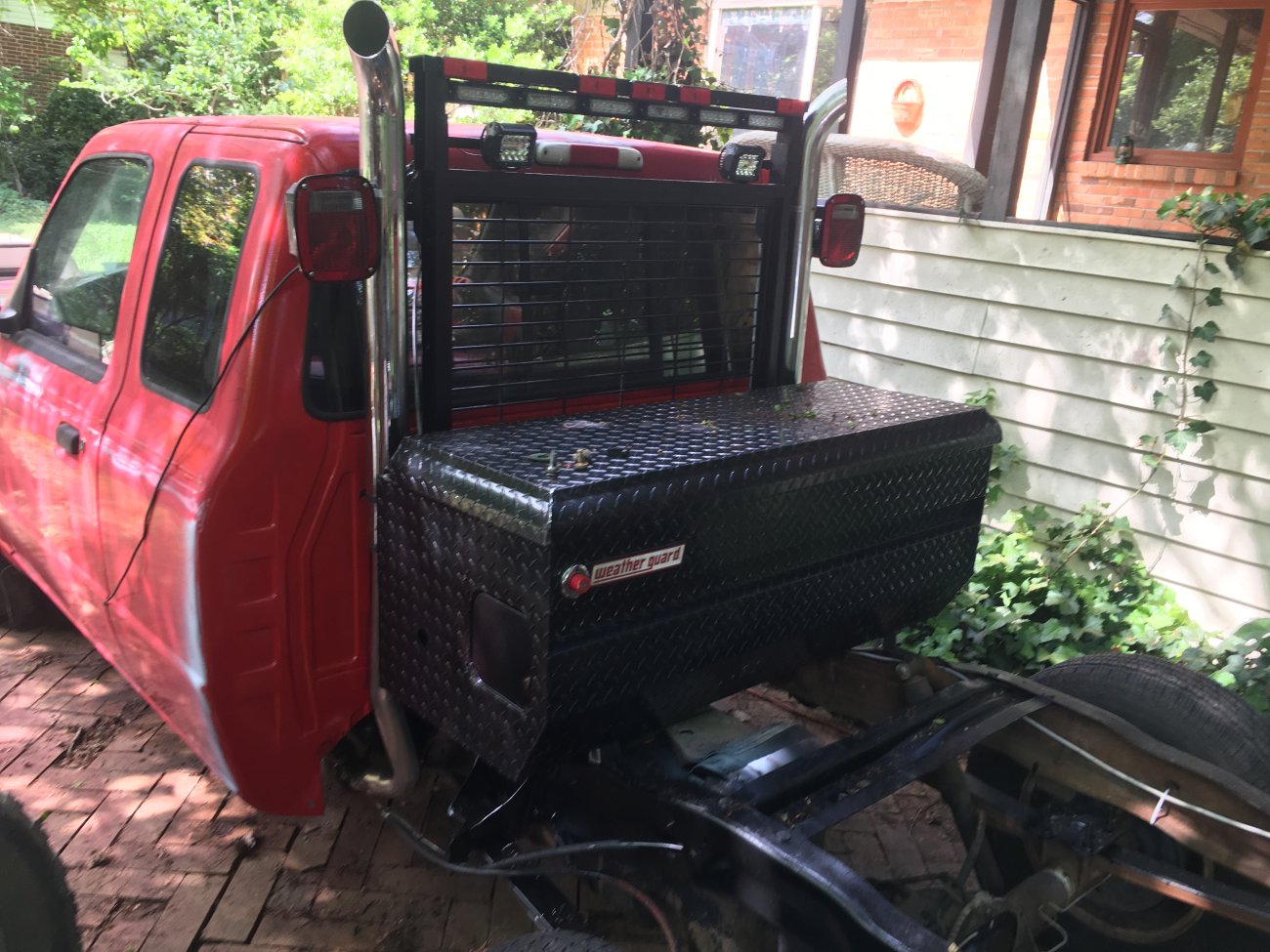

Having said that, I used the approach above when I remove the bed from my 97, and replaced it with a weatherguard toolbox, and I mounted the fill neck into the side of the weather guard box, which moved the cap assembly about 6 or 8 inches closer to the centerline of the truck. The drop leg worked out OK, but I had to modify the outer hose. And again, I’m not sure that’s the arrangement on the 83.

Mine just has a steel tube coming out of the tank that the hose clamps onto. The thing in the original post looks homemade.

If you are swapping tanks 85+ have a bigger pickup hole in the tank.

Thank you for the info. im going to post a pic of another fuel tank that is like the one i have.

I just git my tank from Rockauto today. Mine has the neck welded in. Your truck being carbed may have different size hole.
Does your truck have the fill tube in the outer tube, the fill tube dropping to the bottom of the tank?
Or does it have the separate vent line up to the gas cap assembly? There’s a little hole for s grommet across from the tank’s fill pipe apparently, is that the vent hole?
The big fill tube that connects to the tank and at the end of that tube, there is a smaller tube that does extend out iof it. I dont know how it is attached inside but it is factory. I dont know the purpose of it but it is the way it came from the factory.
