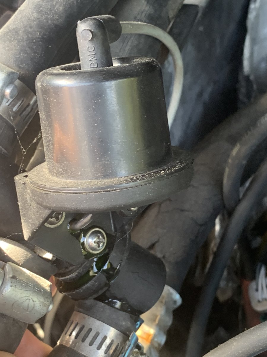

this small thing is leaking coolant, it’s on the back left side of the engine, I have a 4.L engine although a similar thing exists on my 3.L please let me know if you have any clue on what it is or what it does. Thank yall
Yup, heater control valve. It shuts off coolant flow to the heater core when you’re running the AC so the AC gets colder

You could always get an electric one, same wire that activates A/C clutch can activate the valve.

The only time there will be any vacuum to that valve is when you have the A/C set to MAX to shut the hot water off to the heater core.

There were two different valves used over the years, the one went on only one hose to shut off flow, the other went on both hoses and when it shut off to the heater core it would circulate back. If it’s on both hoses, both hoses should get warm.
You can pull the vacuum line off or manually cycle the valve as well. They are spring loaded so you have to hold it but you can check valve operation easy enough.
Poor heat output can be caused by a bunch of things including a bad thermostat, water pump, heater core, control valve, mouse nest in the ducts, blower motor, blower motor resistor, blend door stuck, etc. Gonna have to do some investigating. If the truck is getting warm but not overheating, then it’s probably not water pump or thermostat.
