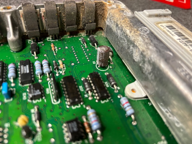

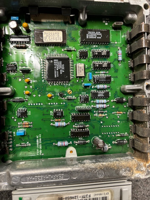

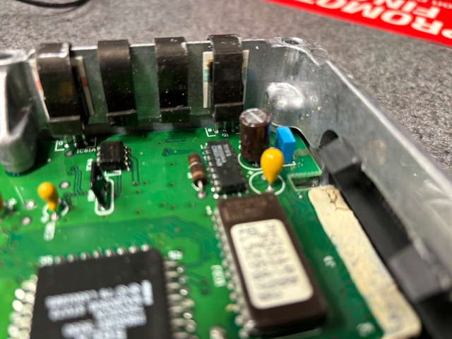

I’ve attached pictures of the ecu board. It doesn’t look like the capacitors are leaking, but in all honesty I know jack squat when it comes to circuits.

The 2 capacitors looked OK, but while its obvious when they fail it's not obvious as they fail, lol
