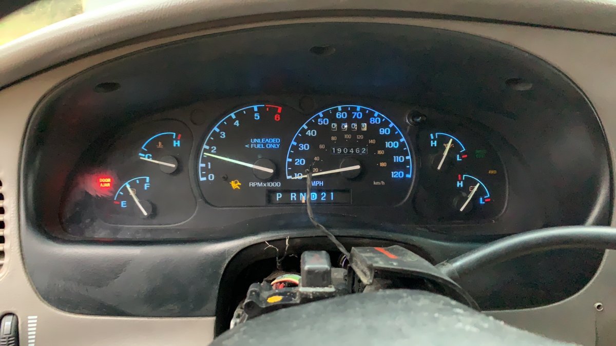

It actually doesn’t the only time the blue hi beam light would come on was if you actually turned them on. I’ve recently “fixed” the issue kind of on accident. I had my instrument cluster apart replacing some blown bulbs and once it was out that’s when I found out the instrument cluster has been replaced with one from a junk yard. The board on the back that powers the lights and gauges had some corrosion dust all over it and looked to be flaking. I replaced all the bulbs but once I plugged it all in and put it back together the dash turn signal lights and the hi beam lights no longer worked. However, the turn signal, hazards, and hi beams work as intended now. Looking at the cluster it looks like it’s off an older truck but I’m not 100% sure. I am also having an issue where my coolant temp gauge doesn’t work correctly and I’m guessing this issue is related. When I ground the wire out it tops out but after replacing the sensor and double checking the connection it’s still not reading properly, it starts below the cold line then warms up to the cold line but doesn’t go past it. I also found the OD wire cut clean and a few other issues in the dash I was planning on picking up a white faced instrument cluster and doing the resistor swap to make it work so I’ll update if that clears up my problems. It could also be the wiring harness the person who took it off before managed to break the clips and I didn’t have time to fix it properly this time so I’ll likely replace that just need to pick up some more solder and heat shrink.

I did not test it under load I’m new to the electrical problem scene so I’m learning how to use a multimeter for more than just checking outlets in the house. But, I had some success after replacing bulbs and seeing the poor shape of the circuit board on the back of the instrument panel.

The blue light didn’t blink with it. The blue light only would come on if I had my brights on. The left turn signal would make both lights on the dash light up like the hazards but the right did not. I had some success when I took apart the instrument cluster to replace bulbs but the issues not 100% resolved.
The little blue light is tied directly to the high beam wiring. But considering what you found out with the cluster, I guess that explains the blue light not coming on.

If you think the cluster is causing some problems, for troubleshooting purposes I would unplug it and then see how the truck's wiring functions react to that. I think I am correct is saying for the exterior lighting, the cluster is not really needed except for the driver's indicators and they are not needed for normal function of the lighting.

I’m actually ahead of you on that. The trucks lighting performed normal unhooked from the instrument cluster. The only thing I can’t vouch for is the hi beams flashing because I did hook the dash up after installing the new bulbs, which I should mention they’re LED not that I think that’s the cause of the new situation. But with the cluster unhooked the lights all worked as they were supposed to. When I hooked the cluster back up I noticed some of the circuit board seemed flaked and chipped so I’m guessing that’s the cause of a few of my dash lights not working. I noticed the fuel cap light is also not coming on. I was going to replace the harnesses because the clips for them were broken by the last guy as well. They seem to hold fine but I’d like to replace them so I don’t have any issues later on. The trucks a fun project I’m hoping to replace it with something else for a mail truck and keep it for a woods truck but I still am enjoying the repair process. The closest junkyard to me is over an hour away so I’ll have to wait until I get a day off and make a trip. I’ll update with my results also I need to repair my OD switch the guy cut it somehow before. But the dash lights are looking good.
