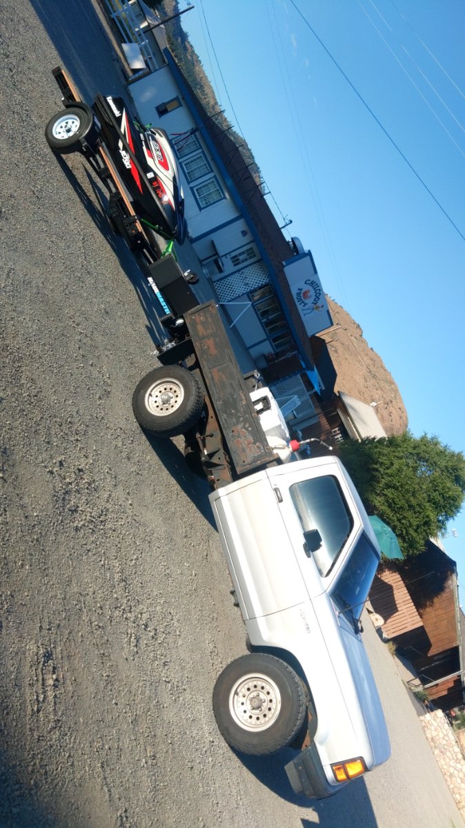

I have had an aggressive clunk from a stop to start depending throttle. I can idle through it. It stopping I can feel this clunk. Also with aggressive downshifts. Truck has been very well cared for. On its 4th transmission. Everything under has been apart and inspected. Kinda at a point we're im looking at replacing a axle? Wasn't full of metal or missing a gear. Unsure what this problem is. Any help?
